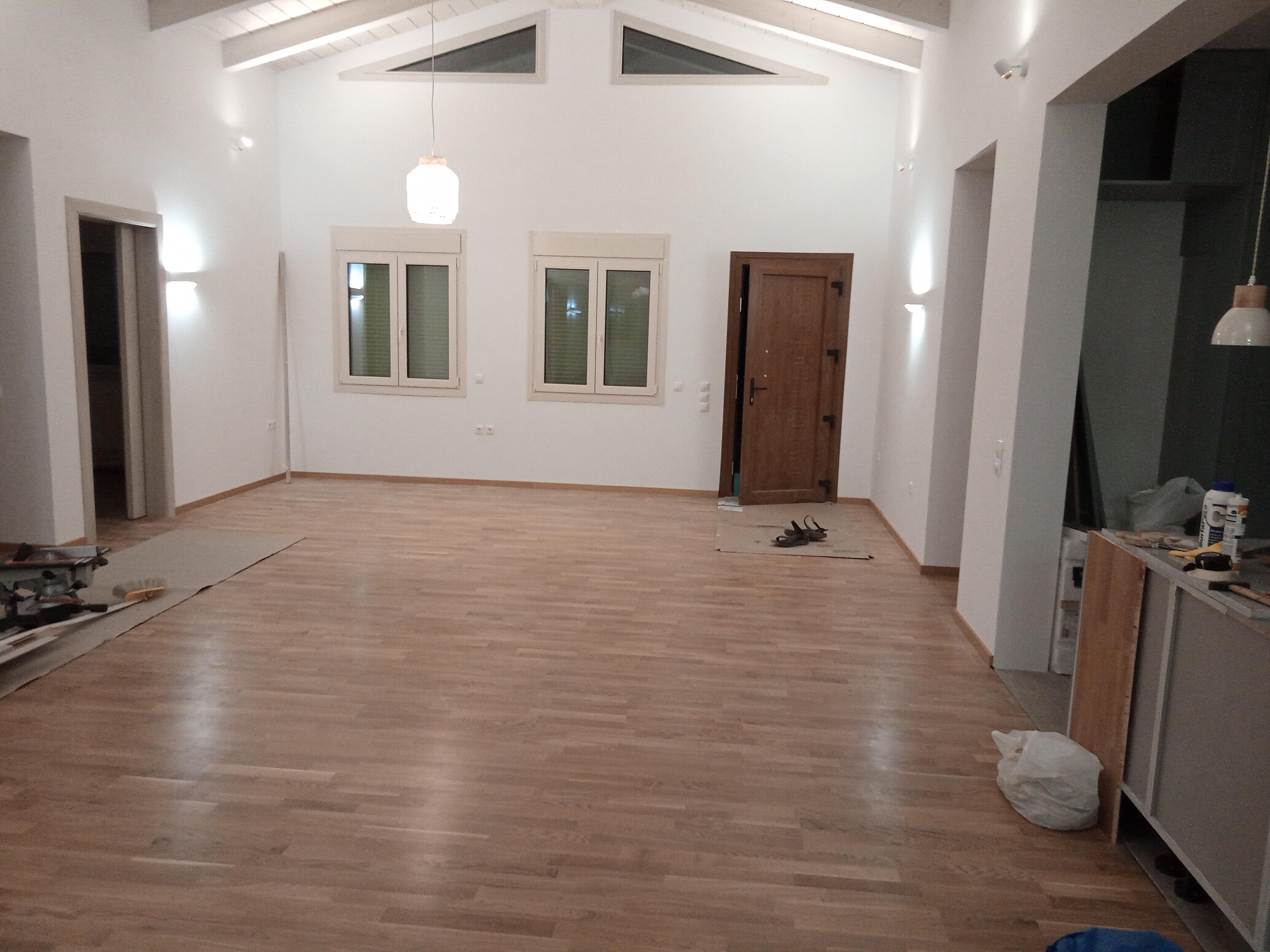

gramos Posted July 4, 2022 Author Posted July 4, 2022 I hope this update will be of interest? We have finished the build but for some small details 😃. I bought a modern stove from Kratki , it will wait for winter before connection , it is 35 C here ! I have 2x A/C units fitted so am working in a comfortable 25 C . I have installed a full off grid PV system which is running the A/ C and there is still a surplus of energy 😁 . In fact the growatt inverters shut down occasionally as we are not using enough of our generated power , (open to suggestions here ) The build was challenging for the locals ,who know not the world of Passiv Haus , but we have ticked most of the boxes . It took exactly 1 year to build , on a Greek island , so much more of a challenge especially during the covid situation. The house retains the cool temp overnight , it's a pleasure to walk in at 0800! 2
JohnMo Posted July 4, 2022 Posted July 4, 2022 Do you have an immersion diverter or timer, this will use some of the surplus PV power to make DHW.
SteamyTea Posted July 4, 2022 Posted July 4, 2022 38 minutes ago, gramos said: occasionally as we are not using enough of our generated power , (open to suggestions here ) Any dump load will do. Heat water, or the swimming pool, a fan heater outside. Power sewage works or water purifier if you have them. Charging batteries would be best. Do you still get a decent payment to feed into the grid in Greece, or are you off grid because there is no grid on the island?
