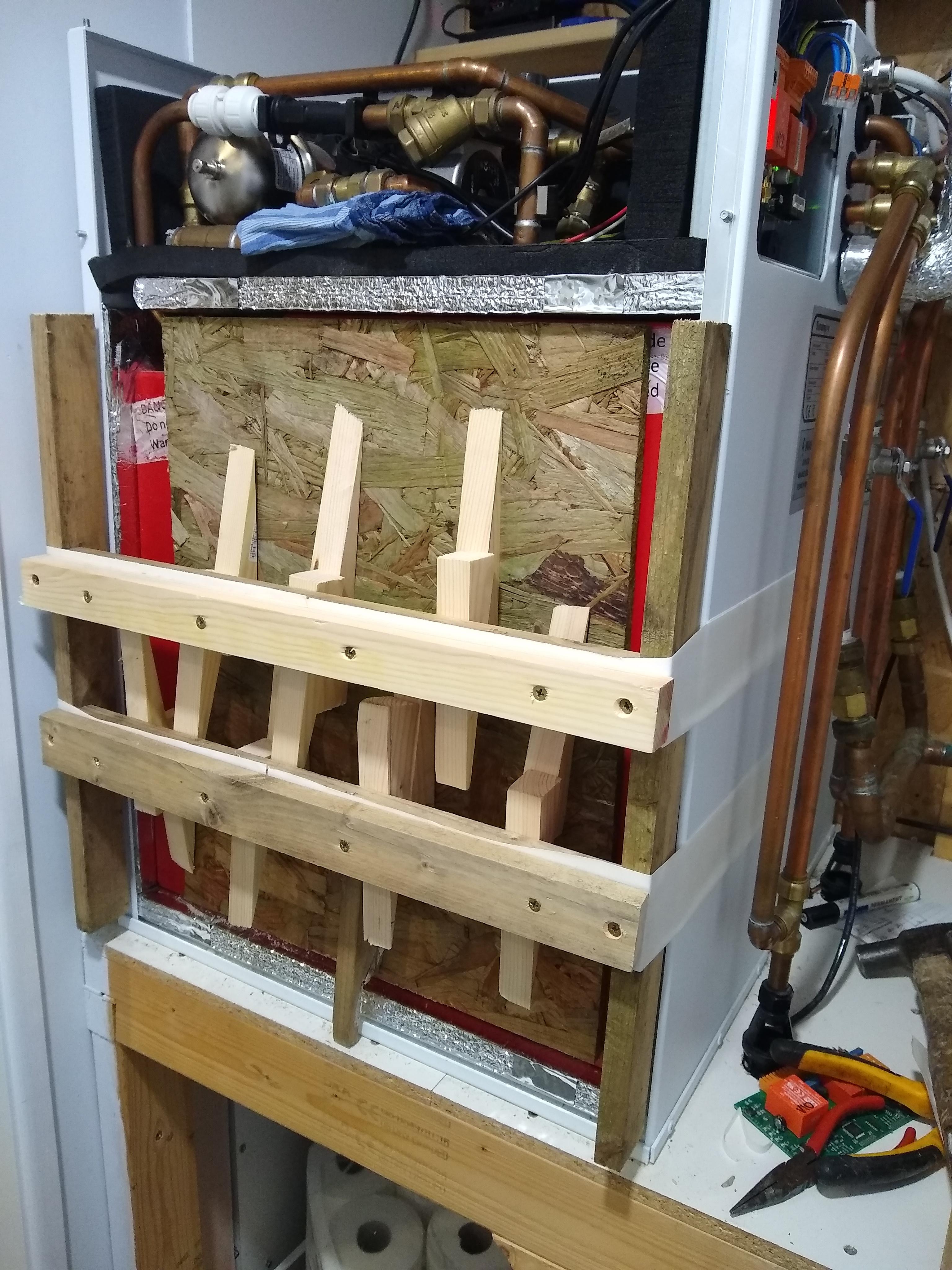

TerryE Posted November 13, 2023 Posted November 13, 2023 (edited) @Nickfromwales, I have just done a 101 cockup. 😪 The heater thermo hat tripped, so I took one side off to get at the heater and reset the trip. I then did a quick trial heat to see if everything was hunky-dorey. What I didn't do was to put the side back on first. Unfortunately the cells keep their shape because they are retained by the steel outer container, and with one side missing they started to slump slightly. By the time that I noticed the two cells had belled about 5mm -- not enough to cause permanent damage, but enough to pop the unsupported vacuum panel off and to stop me reassembling the unit. I am an idiot. So I now have a catch-22: the cells are still integral, but have sagged slightly, and I need to get them back to their constrained cuboid shape in order for me to be able to reassemble the unit. To do this i need to bring enough of the PCM salt past its phase change (at least 50%) of the contents into the liquid phase with the cell is a correctly sized box formwork for it to reset into correct shape. This is all entirely doable but just a total PITA to do. The unit is currently on a shelf ~1m off the desk and with each cell at ~40Kg weight, this is enough of a lifting hazard for an old fart like me to need a lifting aid(e.g. a pulley) but again thanks to my time in the Royal Engineers, this is something that I am familiar with. I will try chatting to a SunAmp engineer, but I am not hopeful. I suspect the answer will be: "sorry, but it's an out of warranty obsolete unit", with maybe an offer of a small discount on a replacement unit -- which would need me to replumb by HW runs and move my control panel 😞 So it's going to be a case of disconnecting and dismounting the SA (the front unit in the pic below, which as taken 6 years ago during commissioning), and then working on it in slow time. I still need to diagnose the root cause for the thermo tripping in the first place and fix that before I can recommission the unit. The moral of this story is that using a constrained space like this for services is a bit fraught with gotchas. I would have been better having the heavy kit on the deck and moving the manifolds up to the top shelf to leave room for the heavies below -- but this would have required me to have left 2m tails on the UFH loops before the slab pour -- something that I didn't even consider at the time. At least I have the isolation valves with compression fittings so breaking out the unit itself is straightforward. Edited November 13, 2023 by TerryE

TerryE Posted November 17, 2023 Posted November 17, 2023 (edited) After some debate, Jan and I decided that we could press out the sag in the cells if I made a suitable jig, so I made up an H frame that is held against the side of the SunAmp by some tape strapping, and which could hold a pressing plate (a square of OSB3, and with two bars that allowed a set of folding wedges to apply the pressure. I then brought the SA to temperature and used the wedges to load up the pressing plate and push the cells back true. All that remains is to allow the cells to cool back to solid phase and then I can reassemble the SA. A bit Heath Robinson, but simple, very cheap and effective. Job done. Here is a pic (note that the wedges are pretty much at the end of their travel as the cells are back in shape and position : Edited November 17, 2023 by TerryE 6
Adrian Walker Posted November 17, 2023 Posted November 17, 2023 1 hour ago, TerryE said: After some debate, Jan and I decided that we could press out the sag in the cells if I made a suitable jig, so I made up an H frame that is held against the side of the SunAmp by some tape strapping, and which could hold a pressing plate (a square of OSB3, and with two bars that allowed a set of folding wedges to apply the pressure. I then brought the SA to temperature and used the wedges to load up the pressing plate and push the cells back true. All that remains is to allow the cells to cool back to solid phase and then I can reassemble the SA. A bit Heath Robinson, but simple, very cheap and effective. Job done. Here is a pic (note that the wedges are pretty much at the end of their travel as the cells are back in shape and position : Well done 1
TerryE Posted November 19, 2023 Posted November 19, 2023 (edited) I ran the HW (a bath for visiting grandkids) to cold using this SunAmp for its salt to go through phase change to solid, and I then left it overnight to thoroughly cool, before disassembling / removing the OSB pressure plate and retaining frame. The cells were now solid and nicely cuboid, so reassembly was now straightforward. I will do my commissioning tests at midnight (when the Octopus price drops). I recall that some of our members have discussed issues with their UniQ series SunAmps having issues with sagging or split cells. The lesson is quite clear: Do not remove a side panel unless the unit is well below the phase change as the cells do not have internal bracing to retain their shape at operating temperature without the steel casing support in place. If you need to bring the SunAmp up to operating temperature with a side panel removed then you will need use some bracing formwork to retain the cell side shape. Edited November 19, 2023 by TerryE 3 1

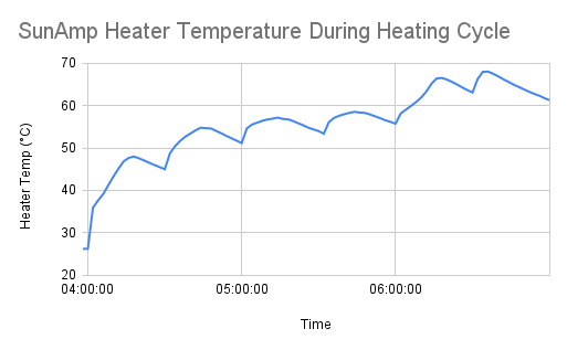

TerryE Posted November 21, 2023 Posted November 21, 2023 (edited) And here is the Heating Curve for last night's heating cycle. Note that the funny ripple is because I have 2 SunAmps, but I decided only to have one being reheated at any time (as the Willis is also typically running as well), so they alternate getting 15 mins each for 3 hours heating. Note that we'd had a big bath last night so the SunAmps were pretty low on stored heat. Also the SunAmp reached the cutoff temperature at about 6 mins into the last 15 min cycle. Edited November 21, 2023 by TerryE
