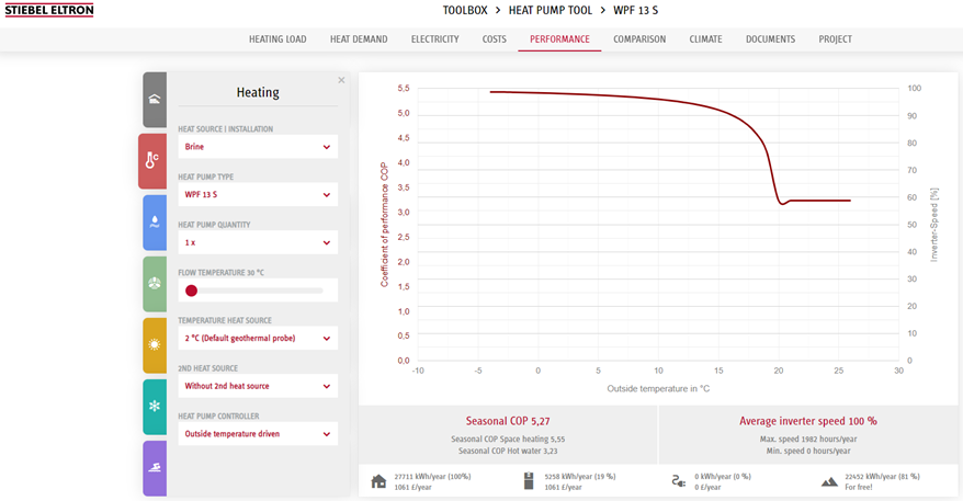

Benguela Posted November 14, 2021 Posted November 14, 2021 (edited) Hello Everyone, I'm new here and love trawling through the questions and answers in the GSHP part of the forum. A little about me: I live in Norfolk and have a GSHP (Stiebel Eltron WPF 13 S). I've got about 700 m of brine loops in my garden and the WPF is paired with a 100 l buffer tank. I know that one of the most important efficiency considerations is to prevent short cycling - run the machine continuously rather than stop/start. Most heat pumps are either on or off... the compressor runs at 100% or nothing. But some heat pumps are variable speed... How can I work out if my heat pump is an inverter model or a fixed output model? I googled the model number and 'variable speed' and 'inverter' but nothing obvious comes up. More important, I'm beginning to wonder if that 100l buffer is too small. If I had a bigger buffer, that would also smooth out the short cycling, not so? Any ideas what difference a larger buffer would make? Thanks for any advice. ~Benguela Edited November 14, 2021 by Benguela Lines removed

Benguela Posted November 14, 2021 Author Posted November 14, 2021 Thanks ProDave, What's making me wonder is this. The performance tool for the hit pump is online at https://www.stiebel-eltron.co.uk/toolbox/waermepumpe/... and it shows a reading for Inverter Speed % (look on the right hand side in the picture below). Maybe it's just a standard display thing in how Stiebel makes these graphs... or maybe it is an inverter model after all.
SteamyTea Posted November 14, 2021 Posted November 14, 2021 https://www.stiebel-eltron.co.uk/en/products-solutions/renewables/heat_pump/brine-water_heatpumps/wpf_05_07_10_13_s/wpf_13_s/technical-data.product.pdf From the limited info it seems it is non inverter and you just buy a different capacity model. But have a good look in the controller submenues. Who knows what may be hidden in there.
