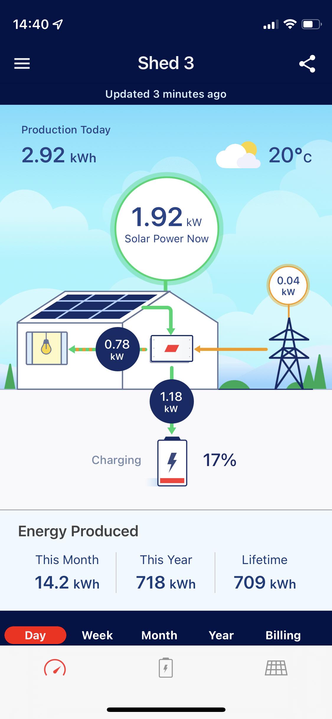

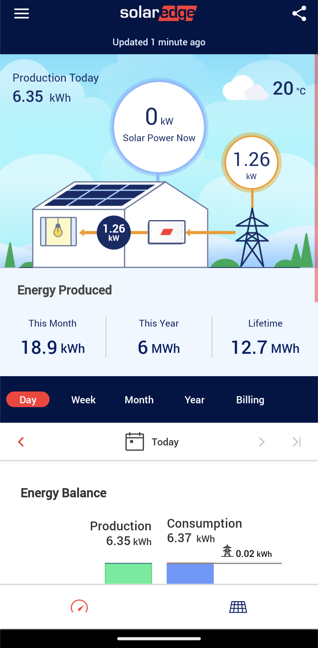

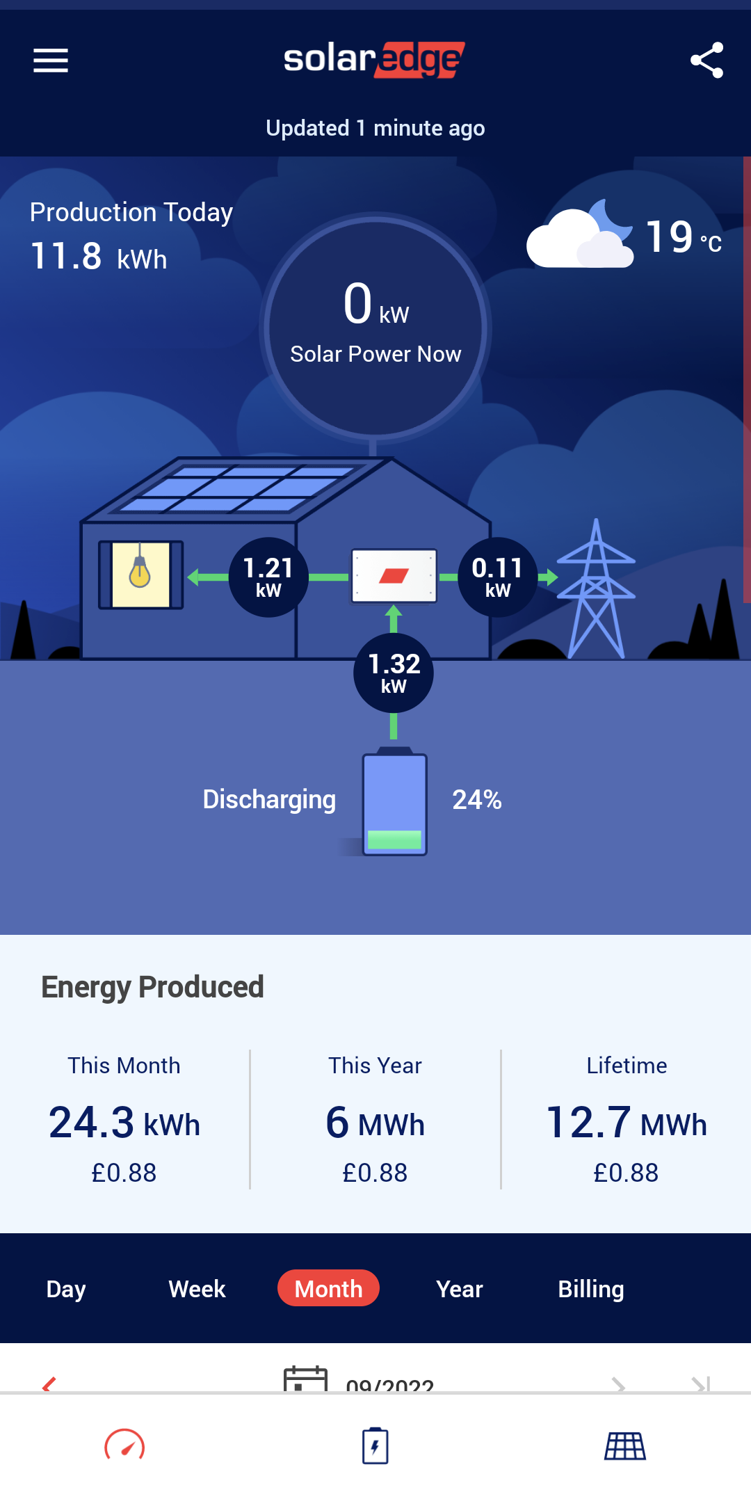

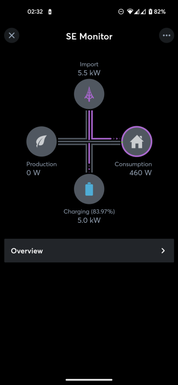

joth Posted September 2, 2022 Author Posted September 2, 2022 Install is fine, only snag is I'm not seeing the battery in the mySolarEdge app. We think I should be, but instead it just showing PV production zeroed out. (the sun is out so definitely not zero right now). Any ideas what I should see here?

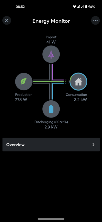

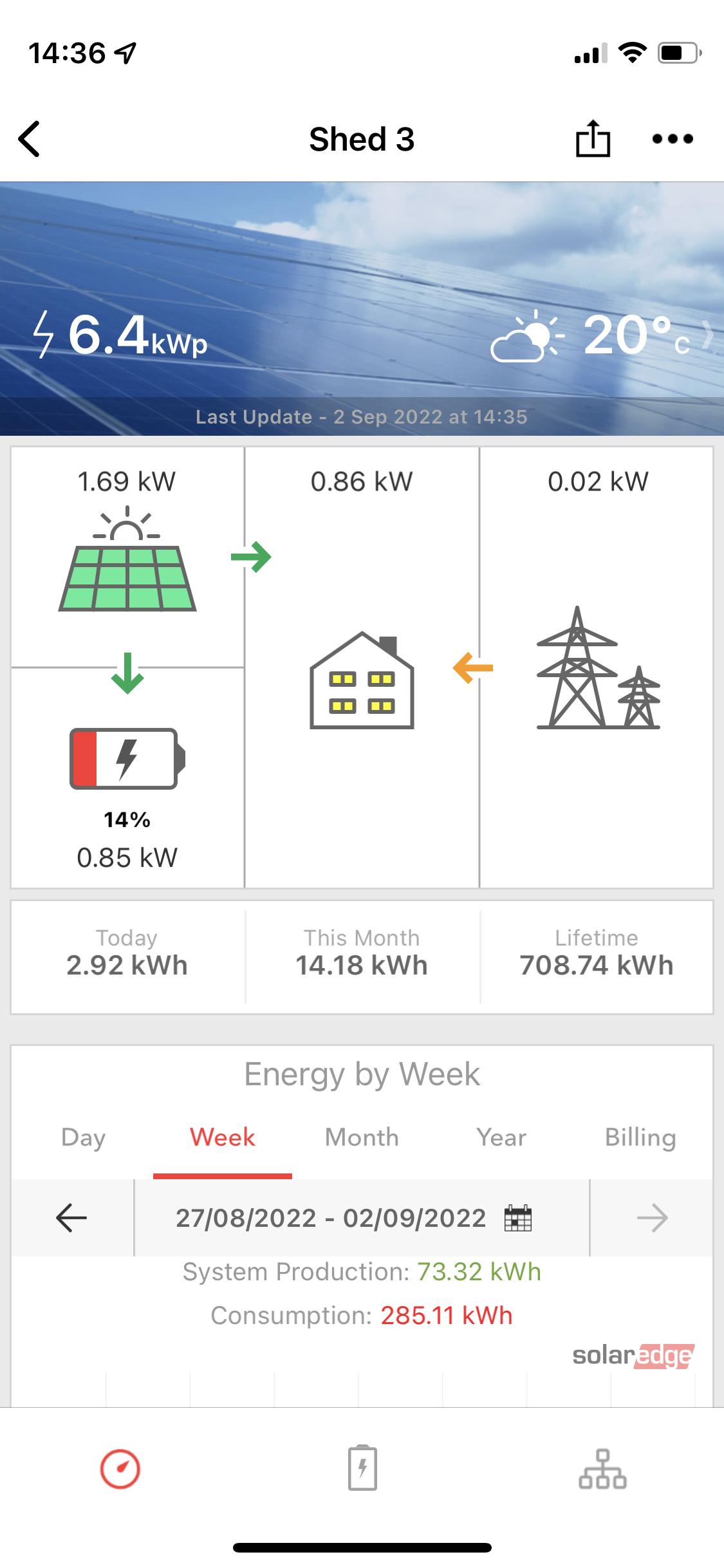

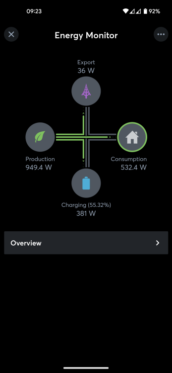

bertybuttface Posted September 2, 2022 Posted September 2, 2022 23 minutes ago, joth said: Install is fine, only snag is I'm not seeing the battery in the mySolarEdge app. mySolarEdge is the consumer facing app, make sure your installer leaves you with access to "SetApp" and "SolarEdge" apps. Here are some screenshots from both apps in case it helps. What do you have fitted so far? Battery, inverter and meter?
joth Posted September 2, 2022 Author Posted September 2, 2022 (edited) Fab! Yes the "Solar Edge" app is now working per your screenshot @bertybuttface but the mySolarEdge isn't quite. It now shows the battery, greyed out, and without a charge level or the arrow going in / out of it. Nevermind, hopefully it will pop up in the morning. (Or I can just switch to the other app). > What do you have fitted so far? Battery, inverter and meter? Yes, SE8000H inverter, Energy bank battery, and as of today the modbus EnergyNet meter. I've got admin access to my site on the portal, so I went in and setup a "Charge from AC overnight from Octopus Go" storage profile (per instructions) and assigned to our site, so hopefully in the morning I'll wake up to a battery full of energy 🙂 [[Interestingly, I now seem to have full admin access to my entire installer's company account, so can view all the other sites, and even edit the permissions of all the other employees. I think this must be a bug on the solaredge portal not enforcing the site-restricted admin settings as I couldn't see this before. So if everyone sees weird and unrequested changes to your accounts around now, it maybe similar power-users able to edit each other's sites problem. God don't you just love cloud-managed IoS]] Edited September 2, 2022 by joth
Pocster Posted September 2, 2022 Posted September 2, 2022 6 hours ago, joth said: @pocster in your other thread I see the SE app should indeed show the battery independent of the PV production. How did you do it? Did it take some time or action to get the app to do this? Yes the SE app can faff Sometimes my battery is apparently “ not connected “ , or greyed out ; or there is no option to even look at the battery in the app . Me thinks SE feck about with cloud based shite a bit too often
joth Posted September 2, 2022 Author Posted September 2, 2022 We got there at last! "Just wait" is the solution. Looking forward to seeing a full battery on a few hours 3
