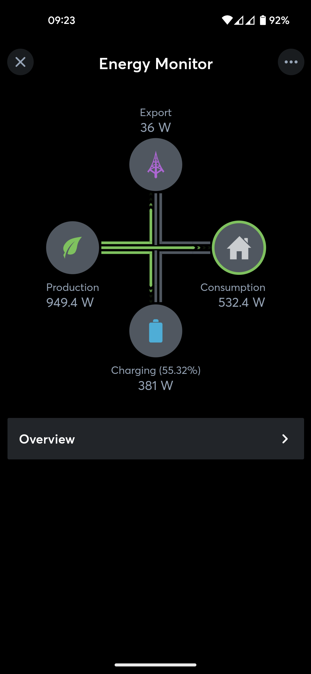

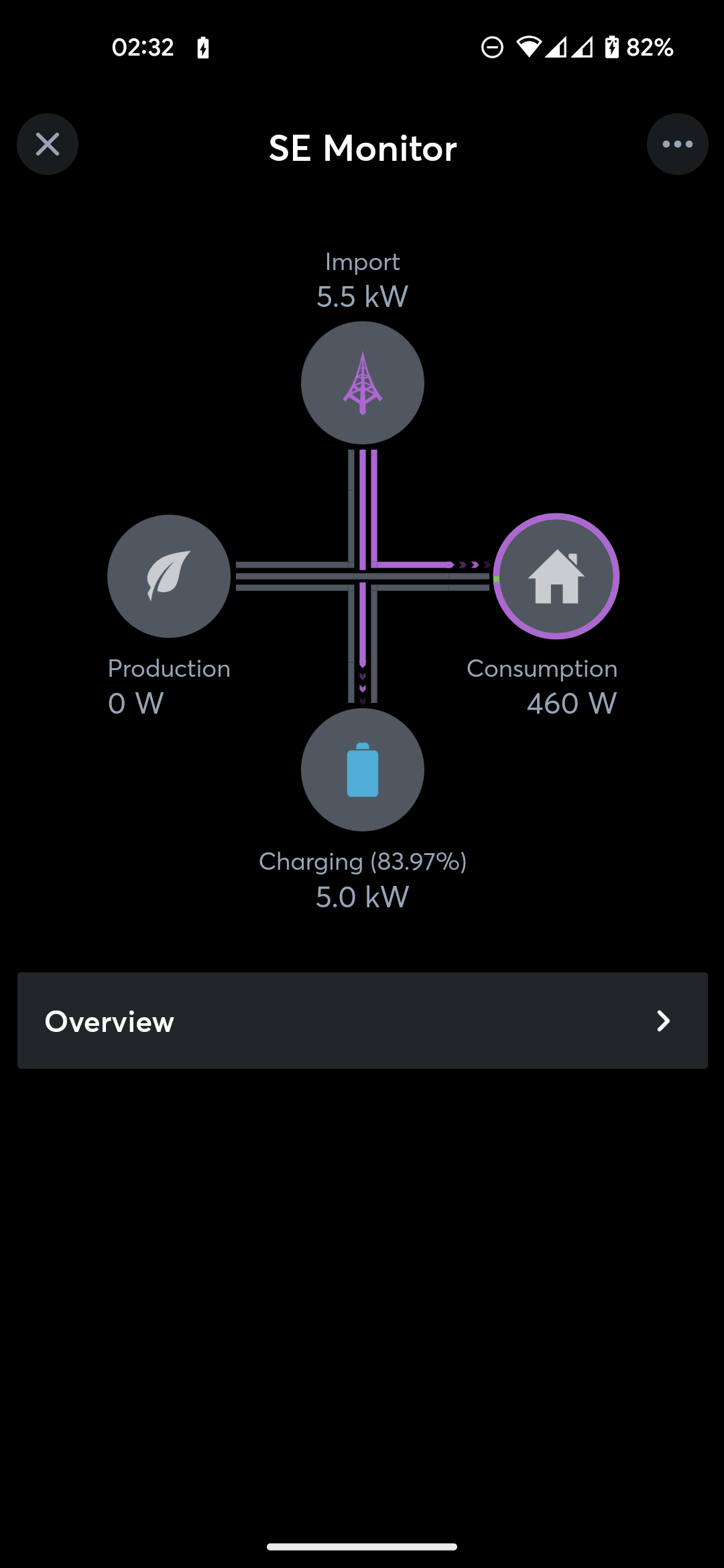

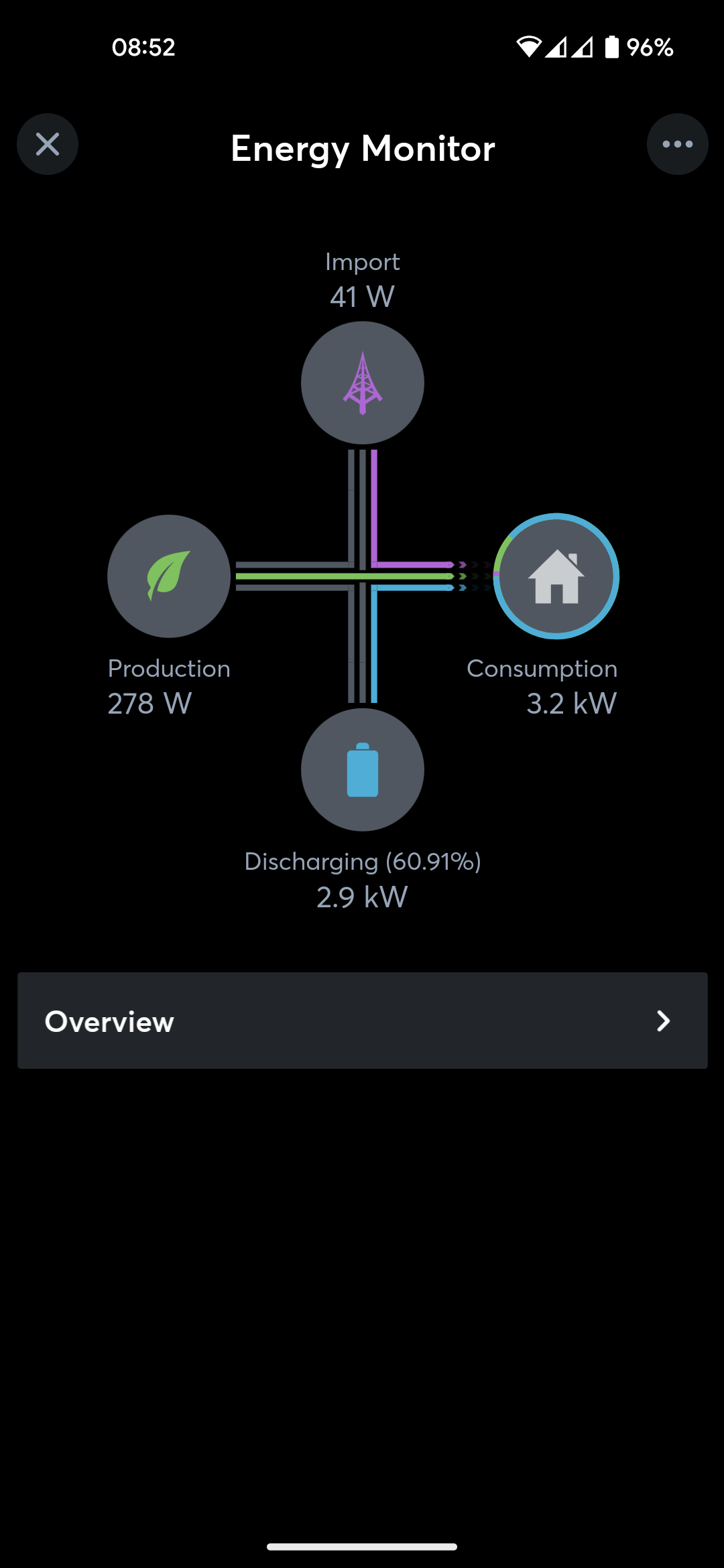

This was super helpful. I also found the solaredge example on Loxone knowledge base which was slightly helpful (the author unfortunately did not understand basic additive mathematics), and some pointers on the Loxone discussion group, and I got the full monitoring/reporting integration working! Direct Loxone to inverter over TCP, not external servers or cloud involved.
It'd be fun to do charge control from Loxone too, but first I need to try and address the glitchiness of the scale factors changing (polling them races against the value being scaled), and also figure out what units the accumulated energy meter is in, it claims watt hours, but looks more like joules to me!
Images show overnight cheap rate charging from grid, discharging this morning, then charging from PV.
