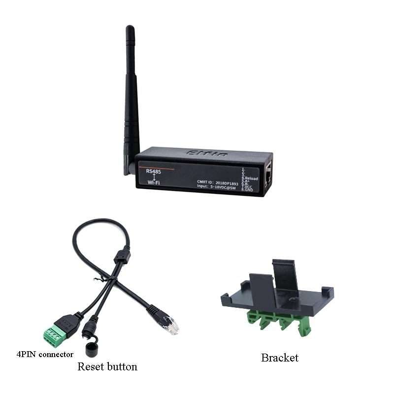

52 minutes ago, bertybuttface said:
With the CT clamp (an extra £40ish) the SolarEdge Energy Monitor is £235. I'd then need to run a wire from the fusebox at the front of the house all the way to the shed at the back of the house, it would either need to be surface mount on the outside or a real pain to run hidden. In which case I'd need 2 x wireless gateways anyway. That would be another £80 so I'd be looking at £320 or so.
Got it, thanks. Basically about the data cable and high expenses of making it wireless.
My inverter is right next to the DNO cutout so way easier to keep with the SE CT clamp, in the first instance. (If the damn thing ever arrives)
Cheers
Cheers
Yeah pretty much and some sick masochistic desire to overcomplicate things because life isn't quite hard enough.
Wireless RS485 is easily done, I use the EW11 and link 2 SMA inverters to a Solar-log which can now sit anywhere in wifi range without risk of a lightening strike on the inverter taking it out via a cable running outside. My panels are wall mounted in an old sillage pit so well away from the house but no shading and angle can be changed monthly if needed.
Serial-Port-RS485-to-WiFi-Serial-Device-Server-Elfin-EW11-Support-TCP-IP-Telnet-Modbus-TCP.jpg
Edited by kommando
