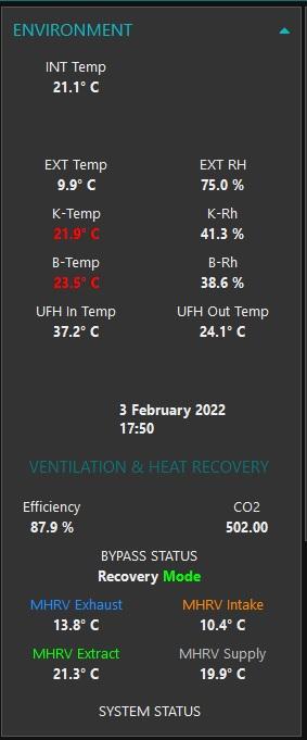

Ajn Posted February 3, 2022 Posted February 3, 2022 A snapshot of ours running at 16 l/s for two people and 95sqm

Ajn Posted February 4, 2022 Posted February 4, 2022 12 hours ago, MikeSharp01 said: Ajn Looks to be doing even better that those levels That is a snapshot at the time. CO2 is monitored in the extract and it will increase to the standard .35 ACH if CO2 gets to 1000ppm and above. Thing is, with doors opening due to dog or grandkids in and out etc etc there isn't a need for higher flows. Bathroom and Kitchen RH is monitored to control the boost which is set at standard levels. Boost is loud but the unit is not boxed in yet. At night 2230 - 0700 it always runs in bypass mode and it does give the feeling of slightly nicer air. This is done as we don't have windows I can open.

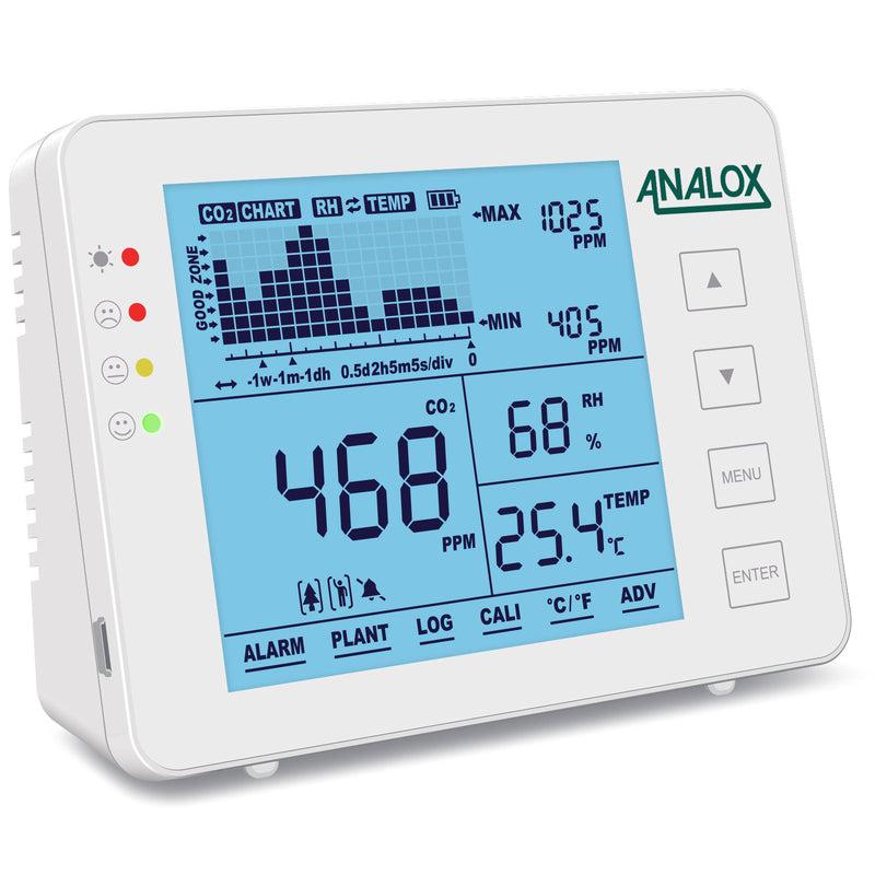

Adrian Walker Posted February 4, 2022 Posted February 4, 2022 (edited) You needs to get yourself a CO2 sensor/logger. This is where I get mine from https://www.gasdetectorsdirect.com/products/air-quality-guardian-aqg Edited February 4, 2022 by Adrian Walker

SteamyTea Posted February 4, 2022 Posted February 4, 2022 4 hours ago, Adrian Walker said: You needs to get yourself a CO2 sensor/logger. This is where I get mine from https://www.gasdetectorsdirect.com/products/air-quality-guardian-aqg Can you get the logged data out of it and onto a PC?
