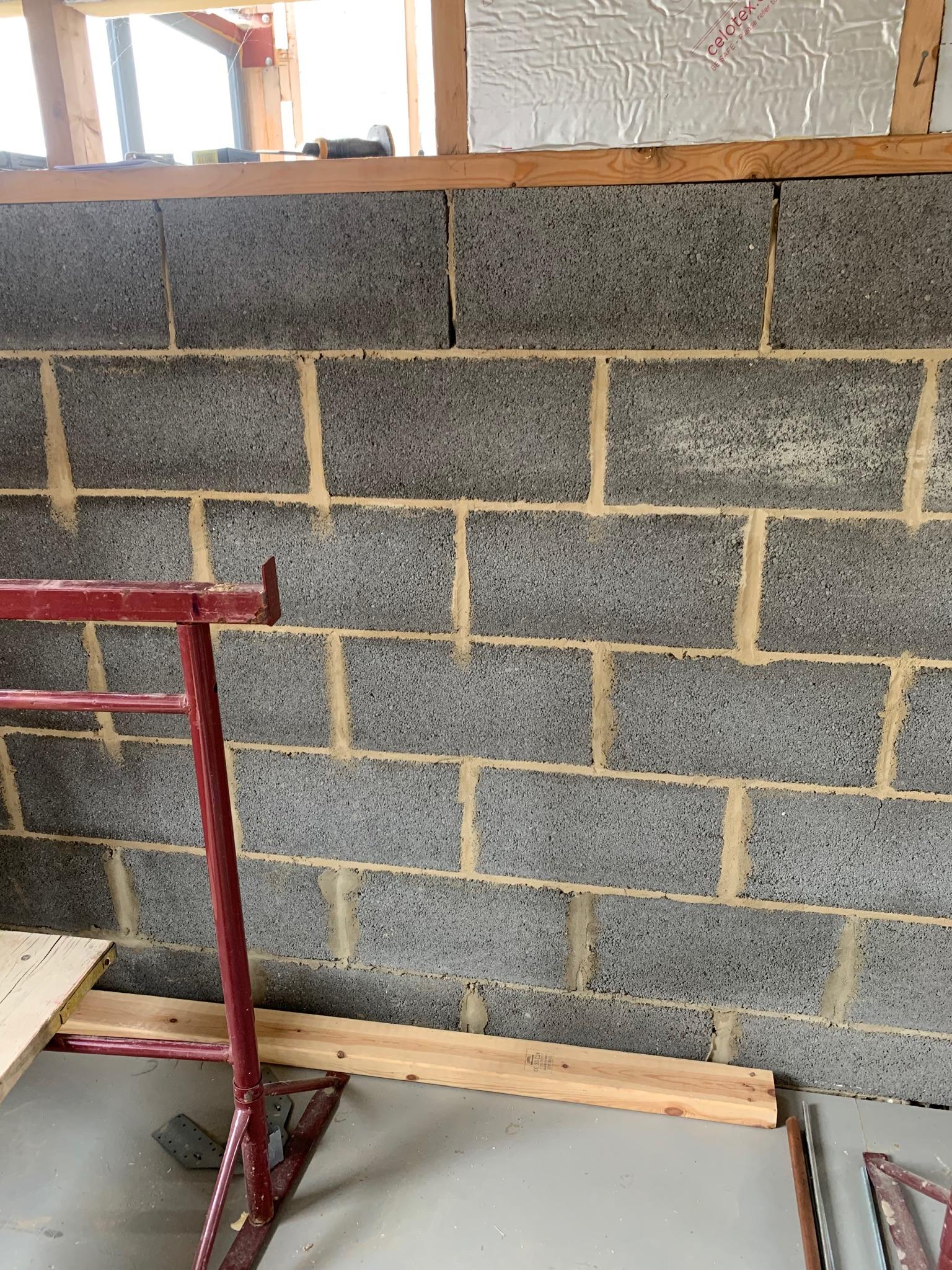

James94 Posted October 17, 2021 Share Posted October 17, 2021 I’m going to have two wall hung toilets fitted into a couple of walls I’m going to be building I’ve seen a few videos and read a little but still unsure. I’m hoping someone on here can clear a few things up. Which ones have you all bought and fitted and what was the reasoning, there seem to be so many to choose from so confused. Thought about purchasing two and building them in as I go, is this necessary? I think only issue is by the time house is done they’ll be out of warranty, do I have to worry about that? The timber I’m using is 4x2 rough sawn, will the waste fit in this stud space or do I have to bring studs away from block wall and if so best way of fixing to block work for structural strength. These are the two walls they will be going against the one with the two wastes in is the down stairs the other is directly above. Regards. James Link to comment Share on other sites More sharing options...
Dave Jones Posted October 17, 2021 Share Posted October 17, 2021 they have to be built in yes. Once you have the floors screeded build them into the stud. Try and use stud internal walls rather than block so you dont wast space as you will have to box them out which looks a bit gash. Link to comment Share on other sites More sharing options...
James94 Posted October 17, 2021 Author Share Posted October 17, 2021 @Dave Jones I might connect the waste from top toilet once fitted as it might be easier to get waste in before stud walls. The downstairs toilet wall will be left until FFL is complete, both toilets are going against block work so timber stud walls are being built to house the frames. So will it be best to buy the frame and build studs round it, has anyone got pics of these builds? Link to comment Share on other sites More sharing options...

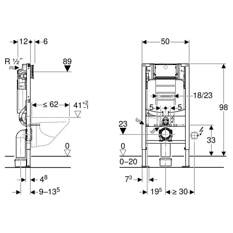

Temp Posted October 17, 2021 Share Posted October 17, 2021 WC Waste pipes are typically 110mm diameter which is more than 4". Are these wall hung WC going on a Geberit frame or similar? They typically provide drawings for how deep the studwork needs to be. Link to comment Share on other sites More sharing options...

Temp Posted October 18, 2021 Share Posted October 18, 2021 (edited) Typically frame drawings look like this.. Note how they specify the distance from the front face to the centre line of the waste. Then the other half diameter of the waste pretty much sets the minimum depth. If you have a horizontal waste pipe it's actually it's better to allow more depth so you can have timber frame in front of the waste pipe to support the "plasterboard" (I recommend Hardibacker board for this). Edited October 18, 2021 by Temp Link to comment Share on other sites More sharing options...
James94 Posted October 25, 2021 Author Share Posted October 25, 2021 Thanks for all the great advice, I’ve seen the diagrams with the dimensions and they look a bit confusing, surly could make them simpler. Anyway just to let you all know I’ve ordered two of the Geberit UP320’s least se how we get on fitting them when they arrive. Regards. James Link to comment Share on other sites More sharing options...

Temp Posted October 25, 2021 Share Posted October 25, 2021 2 hours ago, James94 said: Thanks for all the great advice, I’ve seen the diagrams with the dimensions and they look a bit confusing, surly could make them simpler. The only issue I have is with the way they write dimensions eg 135 to mean 135mm. I think more info would help, particularly if you have a horizontal waste pipe rather than vertical as it complicates the boxing somewhat. Link to comment Share on other sites More sharing options...
Onoff Posted October 26, 2021 Share Posted October 26, 2021 2 hours ago, James94 said: Thanks for all the great advice, I’ve seen the diagrams with the dimensions and they look a bit confusing, surly could make them simpler. Anyway just to let you all know I’ve ordered two of the Geberit UP320’s least se how we get on fitting them when they arrive. Regards. James I found the Geberit instructions confusing to start with, what with their mixing mm and cm. Once you crack the code so to speak and it's crystal clear. I've fitted a Geberit wall frame and wall drain now and tbh love the stuff. I found the videos really helped. Just YouTube "Geberit UP320". 1 Link to comment Share on other sites More sharing options...

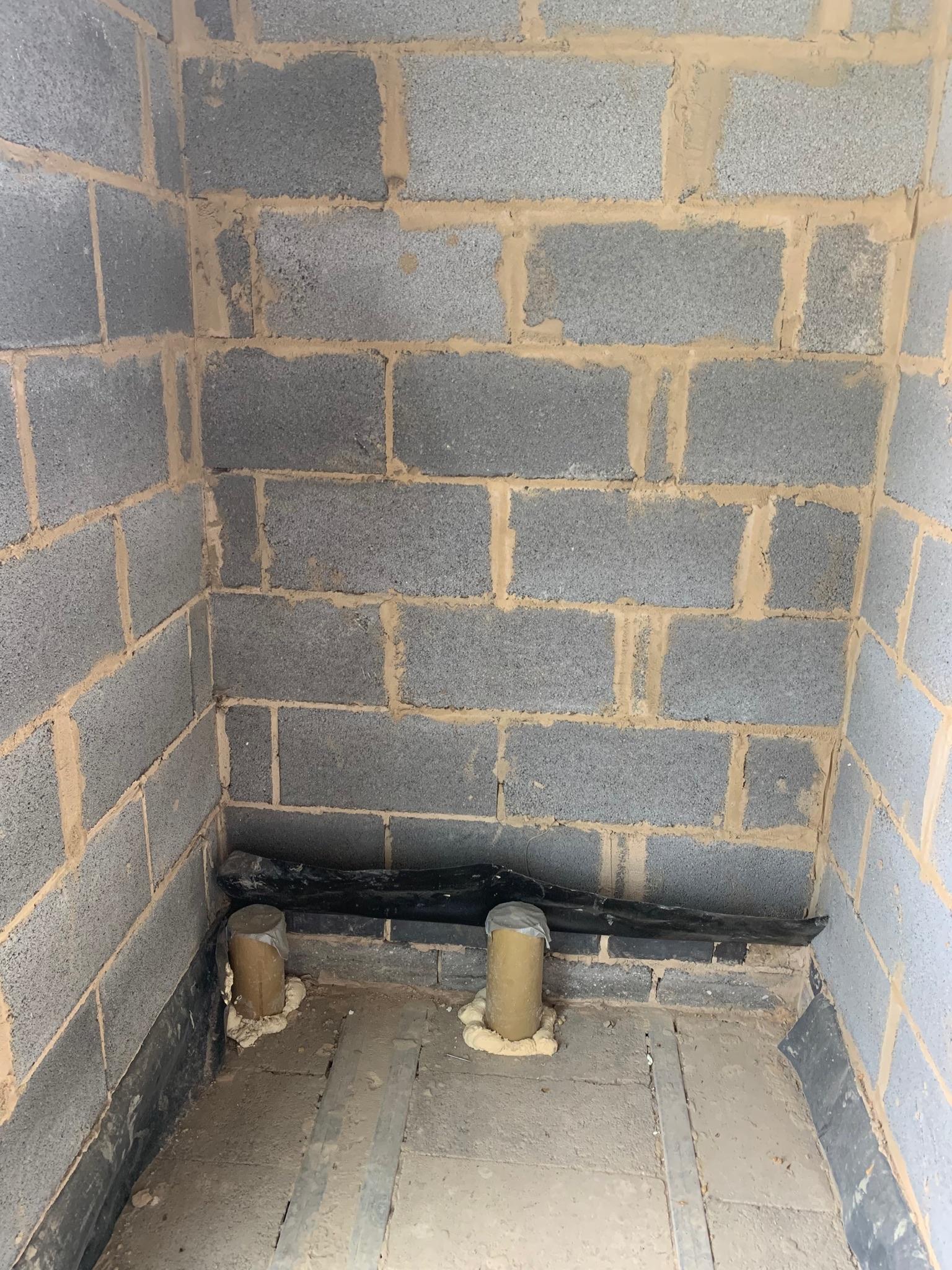

vala Posted October 27, 2021 Share Posted October 27, 2021 (edited) @James94 Currently I'm at this stage. The upright the piece of ply is resting against is the right hand side (when looking at it) of the toilet frame. Frame arrives later today so tomorrow I'll hopefully fit it and will take another pic. the pipe that's curling up to the left of that ply is the water feed to it. I've got 200mm from the block wall to the front of the timber so that should comfortably allow the waste pipe to go right and then exit out of the wall in between the 2 windows. Stack is going there on the outside. Will see when the frame arrives later today what side the electrical connection comes in from and fit some conduit on the wall to run that down. I'll get another pic done once it's fitted. Edited October 27, 2021 by vala Link to comment Share on other sites More sharing options...
