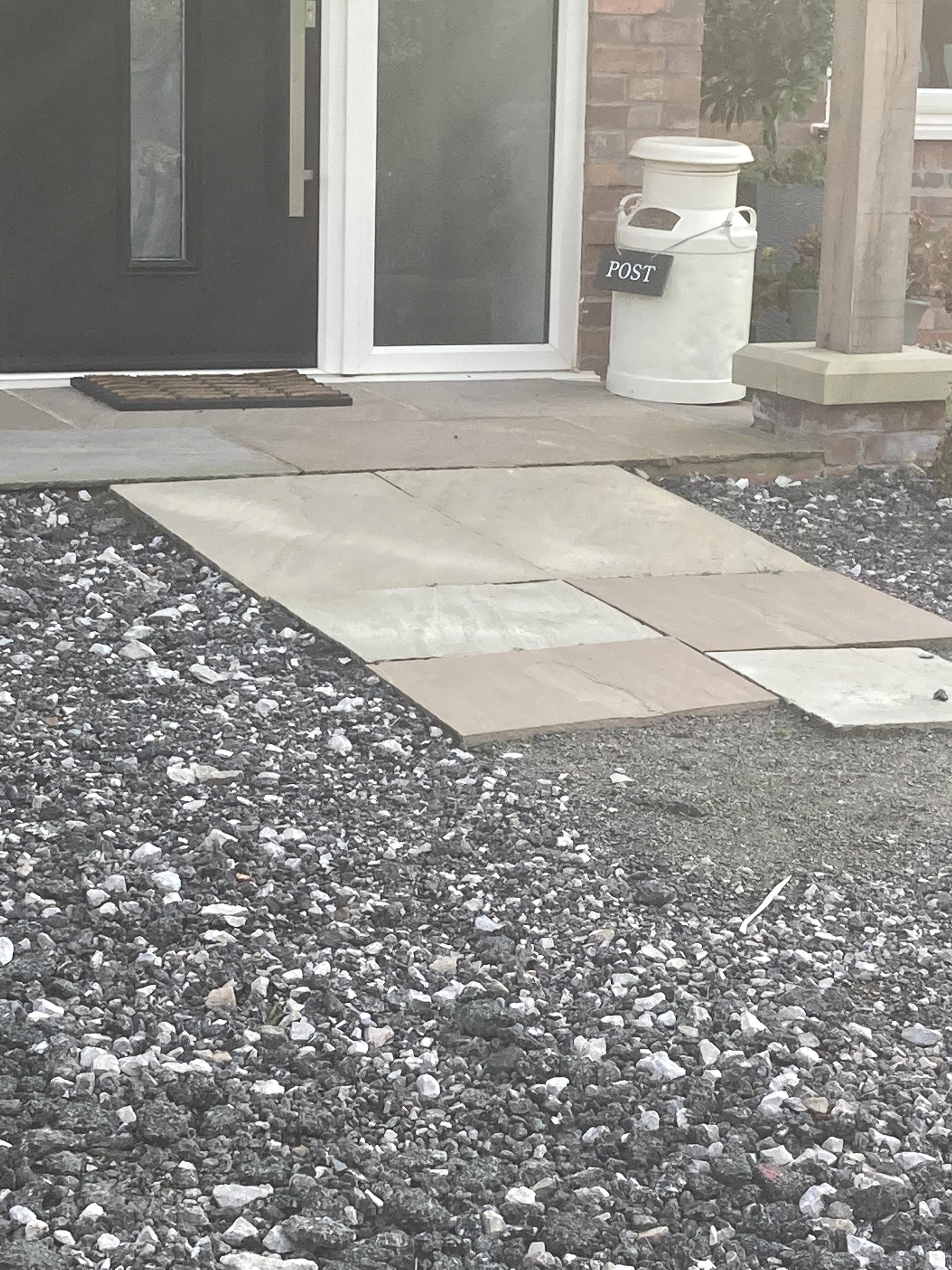

nod Posted October 17, 2021 Posted October 17, 2021 Though our friends have had there build signed off on Friday by one of the private companies Disabled access passed with flying colours
