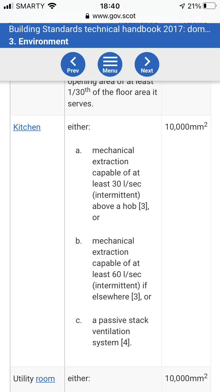

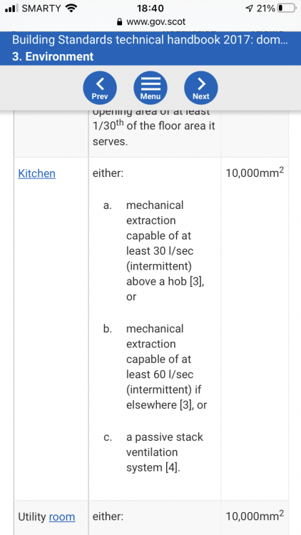

Happy Valley Posted October 15, 2021 Author Posted October 15, 2021 2 hours ago, ProDave said: So mvhr covers your kitchen and bathroom extract requirements. I'll need to check the spec to ensure that they meet the BR requirements - the kitchen will need to be 60l/sec if not directly over the hob
ProDave Posted October 15, 2021 Posted October 15, 2021 31 minutes ago, Happy Valley said: I'll need to check the spec to ensure that they meet the BR requirements - the kitchen will need to be 60l/sec if not directly over the hob There is a different set of requirements for constantly running mvhr, I am sure it is less than 60L/min. but that is why mvhr has a boost mode where it runs faster while showering and cooking. In our case we have a choice of 4 speeds to run the MVHR so I have set it for the very fastest when boosted by the upstairs boost switch and one down from fastest when boosted by the kitchen boost switch. In any event you don't want or need a separate extract fan for a kitchen or a bathroom when you have mvhr. The Scottish regs call for 0.5 ACH continuous ventilation with mvhr and a 25 to 50% boost. Check what the English regs say. 1
