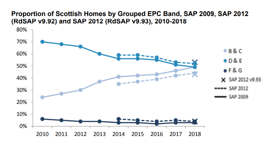

billt Posted October 12, 2021 Share Posted October 12, 2021 That graph implies that existing housing stock is improving. I doubt that that's the case. EPCs last for 10 years and you only need to get a new one if selling, so the reduction is most likely caused by new builds with better EPCs skewing the results. (The graph also has the journalists/politicians cutting off extremes of the scale, making the improvement look better than it actually is.) This house had an EPC of D 58 in 2010, the fabric hasn't changed and it is extremely difficult to improve it without massive disruption. Does PV still improve the EPC? I've got the best part of 15kW of PV panels (not grid connected or MCS installed); in the previous house that would have moved the EPC from D to A. 1 Link to comment Share on other sites More sharing options...
SteamyTea Posted October 12, 2021 Share Posted October 12, 2021 (edited) 15 hours ago, IanR said: If that was replaced solely by heat pumps, then that's a total of 1.75 million hp installs a year, incl. new builds About the same as car sales then. https://www.best-selling-cars.com/britain-uk/2020-full-year-britain-new-car-market-overview-and-analysis/ A quick look at the ONS data shows 3,800 people employed in the retail and repair of motor vehicles (which feels to me a small number, but no matter). These people probably have the skills, after retraining, to help fit HPs. They would have to fit 450 system each year, do 10 a week. So not an insurmountable challenge, but not easy. These points have been made before by Al Gore (in 2006) and David MacKay (in 2008). Banging on about who is going to pay and who is going to make, and fit the systems is not the problem. We have had 20 years of knowing about this, there just seems a real reluctance to change. This is not helped by the trade and media saying that HPs are only for modern houses built to the latest specifications. That is like saying only modern cars can tow a trailer. And the statement that HPs are only truely carbon neutral, in operation, if our electricity supply is only truely renewable, is just a diversion. Don't let energy of the best be the better. Edited October 12, 2021 by SteamyTea Link to comment Share on other sites More sharing options...
Ferdinand Posted October 12, 2021 Share Posted October 12, 2021 3 hours ago, billt said: That graph implies that existing housing stock is improving. I doubt that that's the case. EPCs last for 10 years and you only need to get a new one if selling, so the reduction is most likely caused by new builds with better EPCs skewing the results. (The graph also has the journalists/politicians cutting off extremes of the scale, making the improvement look better than it actually is.) This house had an EPC of D 58 in 2010, the fabric hasn't changed and it is extremely difficult to improve it without massive disruption. Does PV still improve the EPC? I've got the best part of 15kW of PV panels (not grid connected or MCS installed); in the previous house that would have moved the EPC from D to A. Yes, I think solar does still make a difference. I broadly take the "massive disruption" point ??. That is where mine is - extension / rebuild took it to EPC 74C in 2009, and it would be unjustifiablee to gut it for a another decade or two, so it is now tactical. However - on your point quite a lot of improvement schemes have an EPC as part of the process iirc - eg for a time solar FIT was restricted to higher EPC number, some projects do "before and after", and rentals are regulated on it so have to be able to demonstrate a minimum level. Now, an E - due to go to a D soon. Since newbuild is only about 0.7% of the stock per year, it would not shift the average *that* much, and (checking) the ECO programme has now done nearly 3 million "Energy Efficiency Improvement Actions". The English Housing Survey is sample based, so quite robust. However, dig into the data from the EHS and you can see the shifting between bands, and other aspects improving. Not fast enough, as ever, but improving. https://assets.publishing.service.gov.uk/government/uploads/system/uploads/attachment_data/file/945013/2019-20_EHS_Headline_Report.pdf eg EPC C's are up from 11% to 38% in 3 years, whilst the total newbuild is only about 6-8% of the stock. eg eg 2 Link to comment Share on other sites More sharing options...
