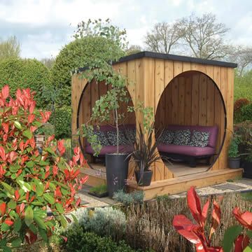

March 31, 20179 yr Author 55 minutes ago, ProDave said: @Crofter is your man for inspiration. Sounds very much like his build. If you make it that warm and cosy everyone will move out of the house into the shed. Didn't you ought to finish the bathroom before starting a new project? I knew that dig would be incoming from someone! Easily bored that's my problem! I love this for the aesthetics but can see huge solar gain issues. A bit of decent glass too might be costly but I could possibly get some rectangular, commercial curtain walling. Then have the "round window" as an offset frame and hidden, sliding brise soleil like pocket doors behind that. Gotta have dreams!
