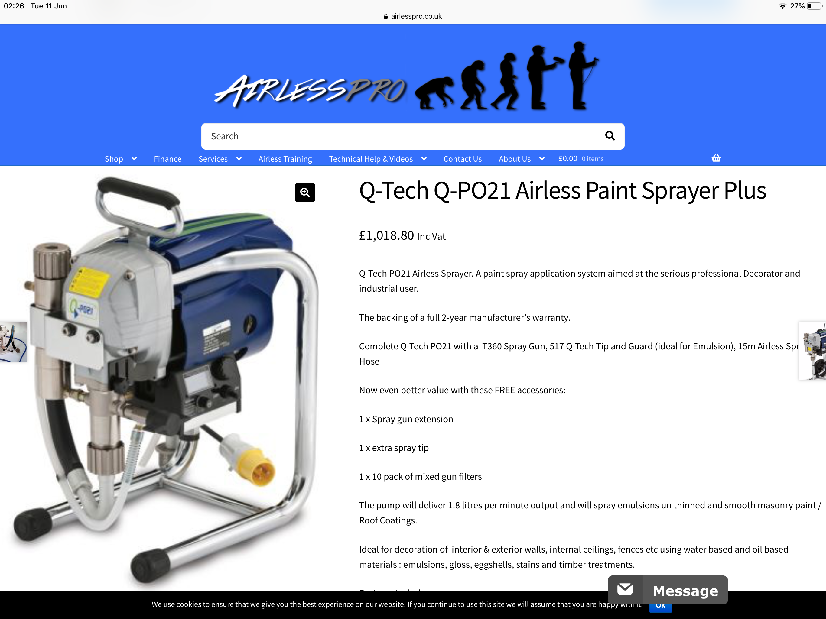

June 11, 20197 yr I've got the Qtech QP019. I bought it second hand and found it hugely frustrating in that it keeps getting blocked after about an hours use and seems to use far too much paint. I gave up and used a roller in the end!
June 11, 20197 yr 10 hours ago, bassanclan said: I've got the Qtech QP019. I bought it second hand and found it hugely frustrating in that it keeps getting blocked after about an hours use and seems to use far too much paint. I gave up and used a roller in the end! Thanks for that. It seems the bearing is a issue and it takes 30 mins to get to it. seen one for £200 on eBay and thought it might be worth taking a chance. I’ll give it a miss. ?
