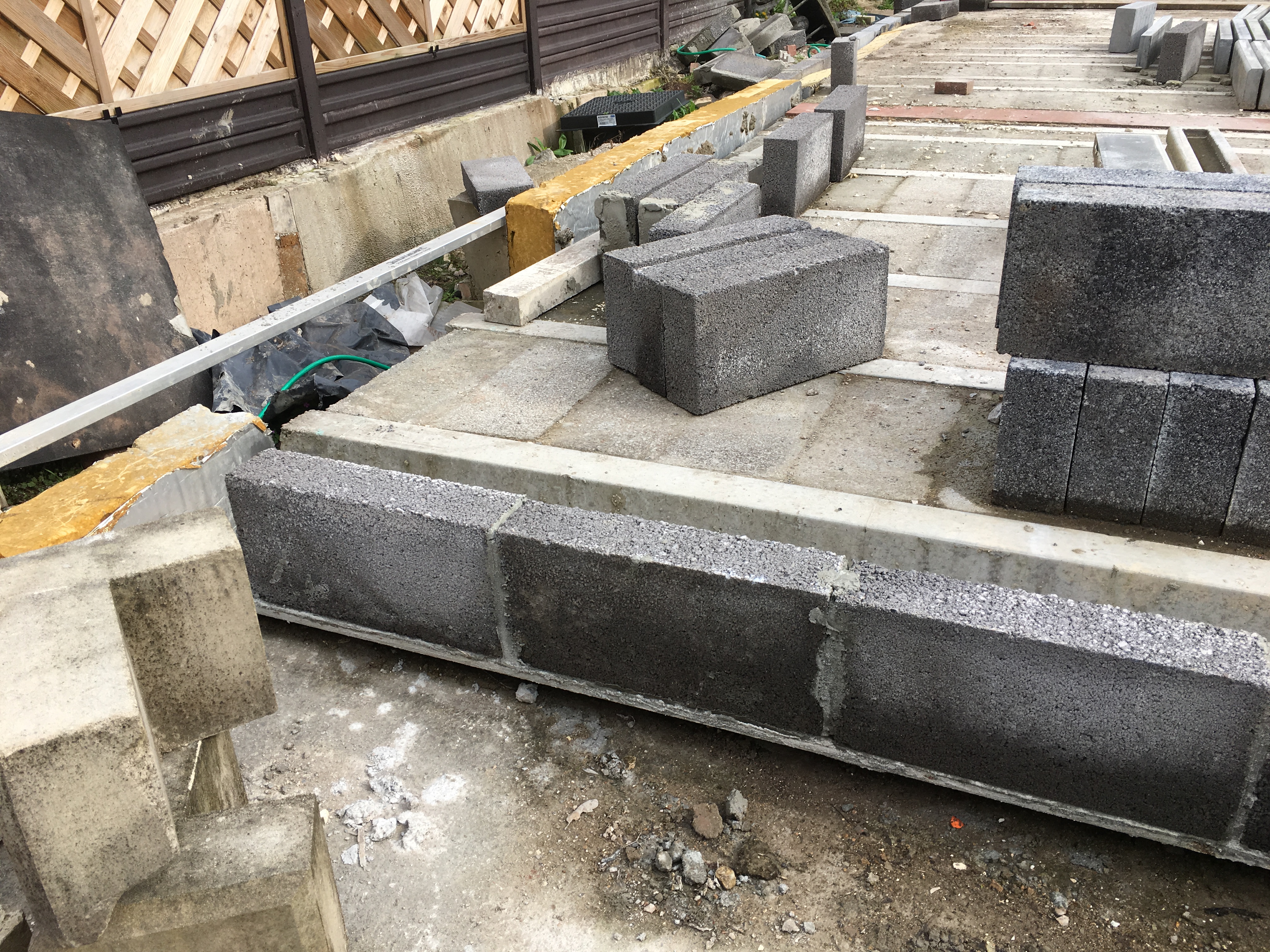

Pocster Posted March 30, 2017 Author Share Posted March 30, 2017 (edited) Hey all, Concrete blocks below DPC. To check my level i.e. know it was out; I cemented 1 brick at a corner. Then cemented another further along about 3 metres or so. I have a nice straight piece of steel I sat across the 2 and then stuck a spirit level on it. I adjusted the bed depth of the bricks until I'm pretty much level - then I can see my concrete blocks (below DPC) are out maybe 20mm tops in the middle (i.e. they rise). So my plan was to do a run of bricks making sure they are all level between those 2 fixed bricks. repeat this down the side of the build (around 9m). DPC on top of this and then thermalite blocks have a pretty level base to go from. Cheers all. Edited March 30, 2017 by pocster Link to comment Share on other sites More sharing options...
Brickie Posted March 30, 2017 Share Posted March 30, 2017 Mmm,transferring levels like this isn't the best-if you're levels slightly out then you're not getting a true reading,then you've got slight human error (could read the bubble slightly wrong) which accumulates every time you move your steel. If you don't have access to a dumpy or laser level,I'd buy a water level. Don't think they're dear & are very accurate. Link to comment Share on other sites More sharing options...
Pocster Posted March 30, 2017 Author Share Posted March 30, 2017 (edited) 2 hours ago, Brickie said: Mmm,transferring levels like this isn't the best-if you're levels slightly out then you're not getting a true reading,then you've got slight human error (could read the bubble slightly wrong) which accumulates every time you move your steel. If you don't have access to a dumpy or laser level,I'd buy a water level. Don't think they're dear & are very accurate. Hmmmm, ok. Seems pretty level though.... :-) I do have another issue though. See attached photo. These concrete blocks are the front. But I have to add 85mm reinforced concrete and insulation. So my DPC at this point would be less < 150mm. These blocks though are just about the same height all round the build - so I have a 'reasonable' level. As you can see my internal floor level is near the top of the block. if I add another entire block course my DPC will be fine but my door entrance (I assume DPC *must* run under doorway). If I do say half blocks or bricks to 'gain' height for my DPC then the entire perimeter block work will be lower and I don't fancy increasing it's height just to align everything. So what concerns me is my DPC level at the front and how I tie the corner together between the side wall (not visible yet - though can see see my steel running to the side behind the insulation to show it's height) and the front wall if the block courses are at different levels. I assume cutting a 'L' in a thermalite block to lap a corner (and allow for different heights) is not a recommended practise..... Edited March 30, 2017 by pocster Link to comment Share on other sites More sharing options...
Onoff Posted March 30, 2017 Share Posted March 30, 2017 1 hour ago, pocster said: I assume cutting a 'L' in a thermalite block to lap a corner (and allow for different heights) is not a recommended practise..... Well if that's wrong..... 1 Link to comment Share on other sites More sharing options...

Pocster Posted March 30, 2017 Author Share Posted March 30, 2017 Lol so ...... rather than do an entire perimeter of extra bricks just to make all the edge level ( but with differing dpc ) can I 'lap' corners ?? . In theory it shouldn't matter ....... Link to comment Share on other sites More sharing options...
Onoff Posted March 30, 2017 Share Posted March 30, 2017 I'd lap it personally. Some strategically placed building materials, diversionary plate of biscuits or missus in a low cut top should the BCO pay too much attention. Link to comment Share on other sites More sharing options...
Pocster Posted March 30, 2017 Author Share Posted March 30, 2017 2 minutes ago, Onoff said: I'd lap it personally. Some strategically placed building materials, diversionary plate of biscuits or missus in a low cut top should the BCO pay too much attention. Lol ! so it won't be the usual stagger on the corner - I suppose it doesn't really matter . I'll make sure some sheet ply is resting against the corner when the building inspector looks ... :-) Link to comment Share on other sites More sharing options...
Brickie Posted March 30, 2017 Share Posted March 30, 2017 42 minutes ago, pocster said: Lol ! so it won't be the usual stagger on the corner - I suppose it doesn't really matter . I'll make sure some sheet ply is resting against the corner when the building inspector looks ... :-) You're losing me here-are you proposing to build the entire job with block coursing at different heights on adjacent flanks? Link to comment Share on other sites More sharing options...
