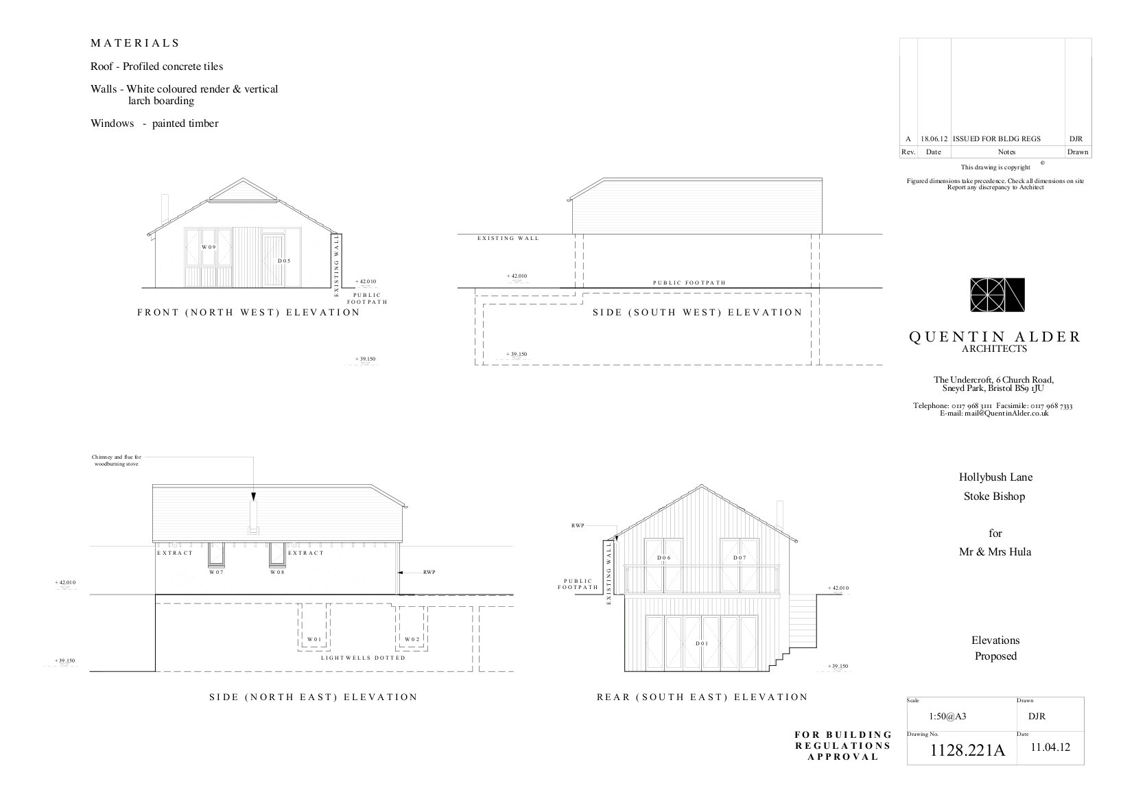

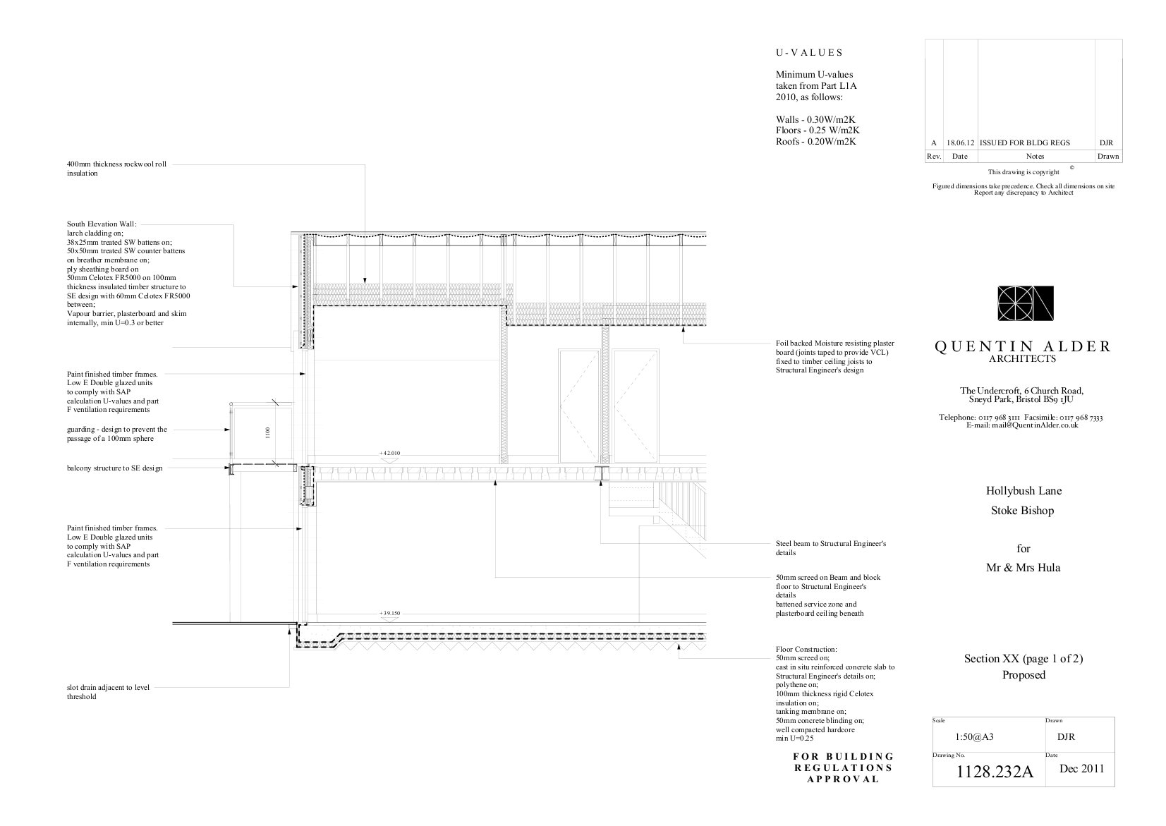

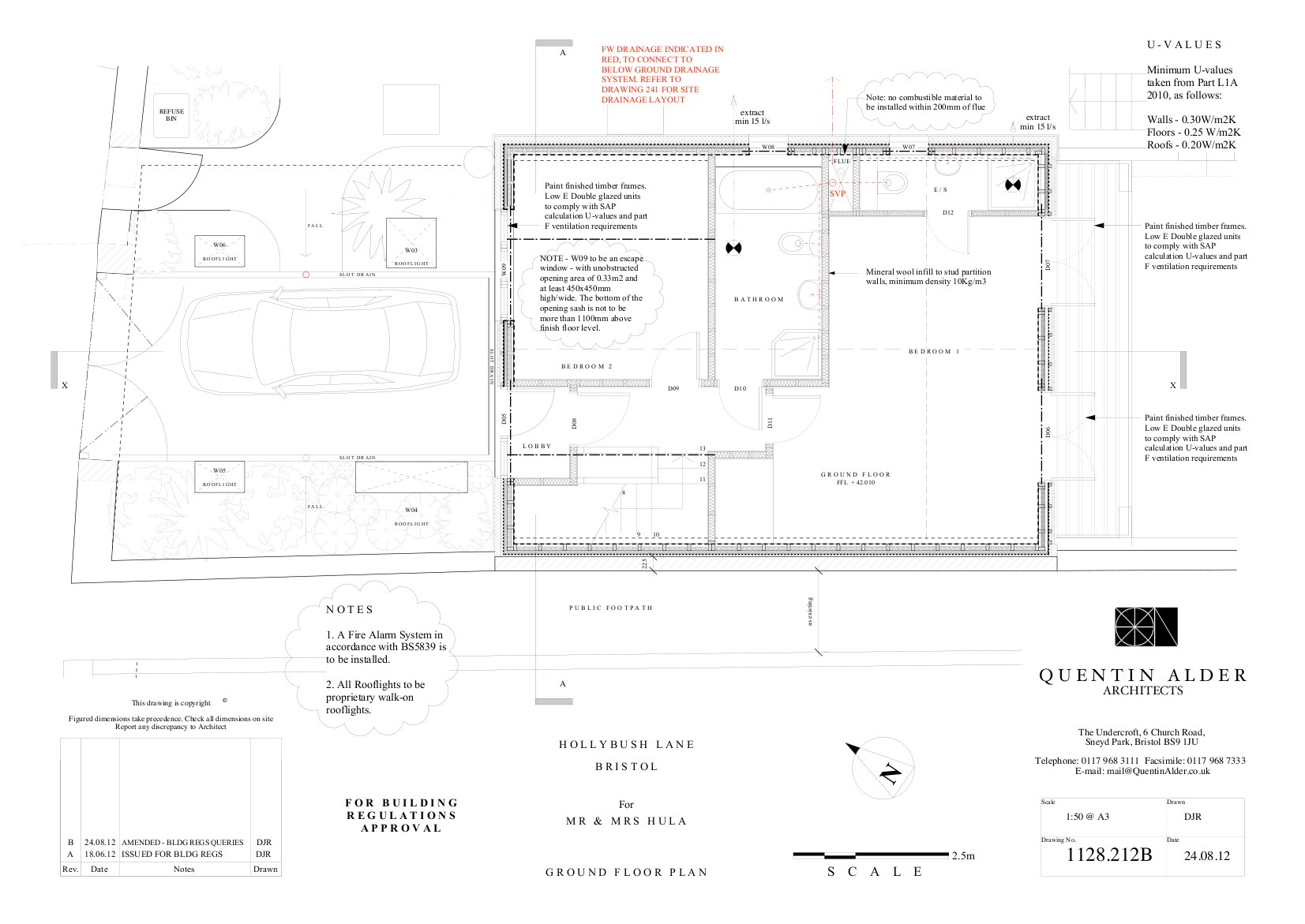

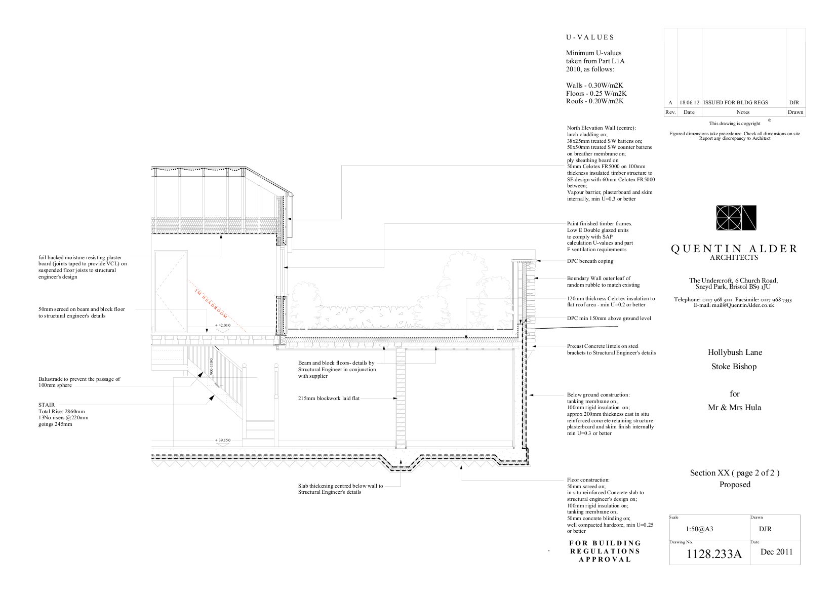

i *think* I understand what to do so will post my thoughts so you guys can check I'm  on the right line . Will upload some plans .
my se and architect were on board until a few months ago and bco has checked everything to date . So I don't think I've done anything insanely stupid yet . Am away this weekend enjoying a much needed break - will post with details and questions later tomorrow.

3) DPC confuses me. I thought the general rule was 150mm above external level. But I think Brickie mentioned it's kind of relative to your inner floor finished level. So on this basis do I assume the DPC is about the same height as the finished internal floor level (as long as externally it's at least 150mm)?
4) The ground floor at the rear of the build has a sunken garden effectively - so no DPC required for the back wall? (perhaps just a bit on the returns?)

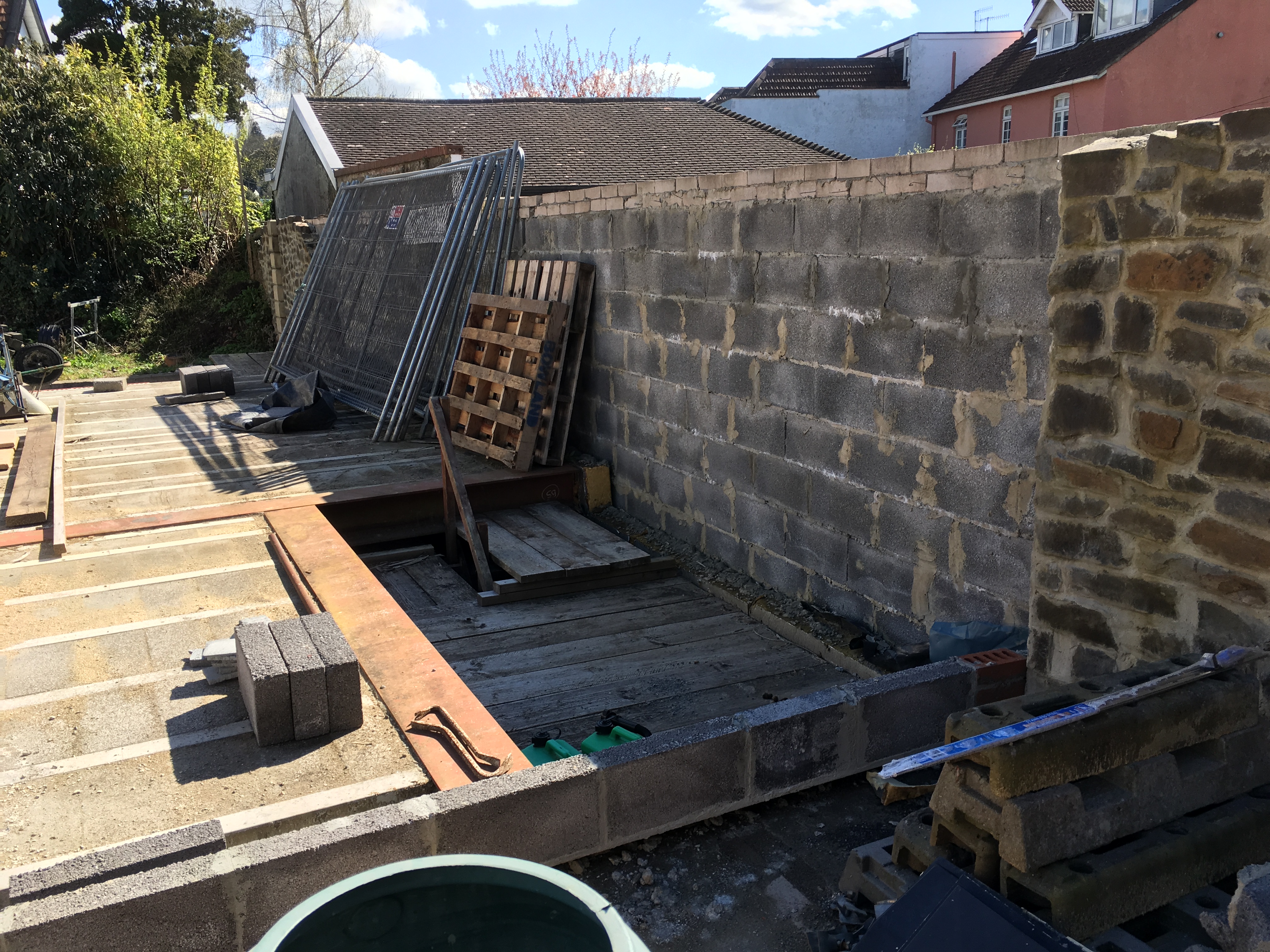

5) If you look at the photo (not plans) you'll see I had to build a single skinned concrete block wall. This is tied on the outside to stone work. Errecting the timber frame/ cladding and membrane externally wouldn't be possible at this point. The wall is at full height so assume tieing from above that to the frame would be fine; i.e. the wall at this point is self supporting.
6) Although the SE/architect/BOC have inspected everything - they all (including myself!) missed that there is no DPC on this wall mentioned in question 5). Any suggestion on how to retrospectively fit a DPC???. I'm not sure how much rain splashing or rising damp this block work would get in reality - but worth asking!
black splash the whole thing (paint it with a couple of coats of liquid waterproofer,) there will be other ways to do this part but i recon this will be the cheapest option.
