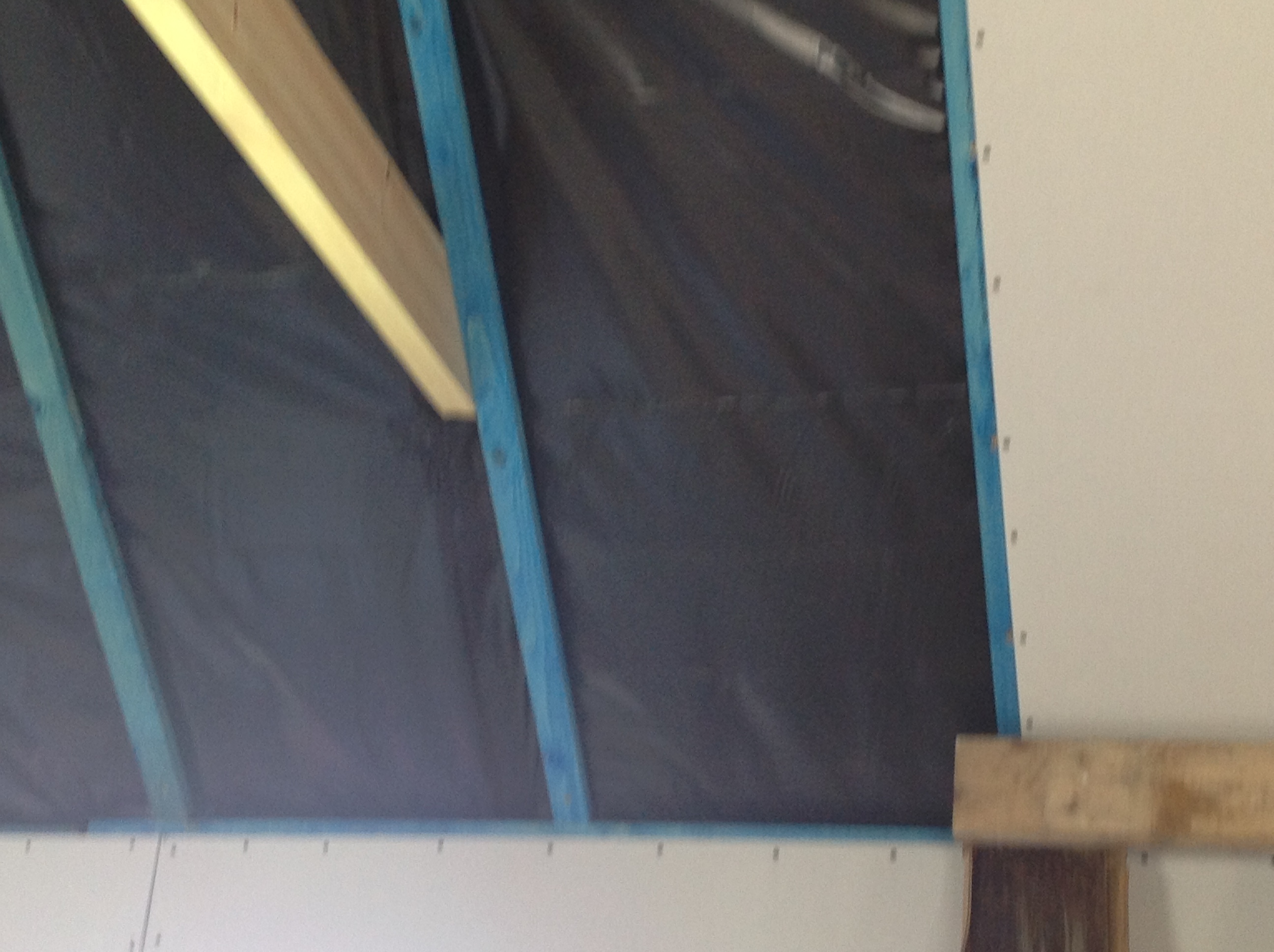

Crofter Posted April 3, 2017 Author Share Posted April 3, 2017 Another wee question: On the vaulted ceiling, there are exposed beams that the boards will have to be cut around. In some places the beam is at the edge of the board and I will cut a small chunk out, all good, but other beams land smack bang in the middle of a board. So I presume my options are: - split a board longways up the middle, and fit it around the beam. Pros: no additional battens needed. Cons: full length cut edge joint. - split the board across its width and put one part above and one below the beam. Pros: shorter total joint length. Cons: Will need extra battens to support it What would you chaps do? And don't say "make sure the beams are all on 1200 centres", it's a bit late for that! Link to comment Share on other sites More sharing options...

Crofter Posted April 4, 2017 Author Share Posted April 4, 2017 (edited) 18 hours ago, jamiehamy said: Pics?! I think it know what you mean but want to check Here we go... the next bit of pb on the left has to be cut to fit round the beam... so vertically or horizontally? I have already planned the boarding of the ceiling so as to maximise the number of full boards, but there are three each side that clash with the beams. Edited April 4, 2017 by Crofter Forgot photo! Link to comment Share on other sites More sharing options...
jamiehamy Posted April 4, 2017 Share Posted April 4, 2017 tbh it's really six and half a dozen. Initially I thought split across the width and join with some osb/4x1 but the longways cut will do fine. I would cut across if I was doing it today. Sorry that's not very helpful! Link to comment Share on other sites More sharing options...
jamiehamy Posted April 4, 2017 Share Posted April 4, 2017 Cut across. Definitely. 1 Link to comment Share on other sites More sharing options...
