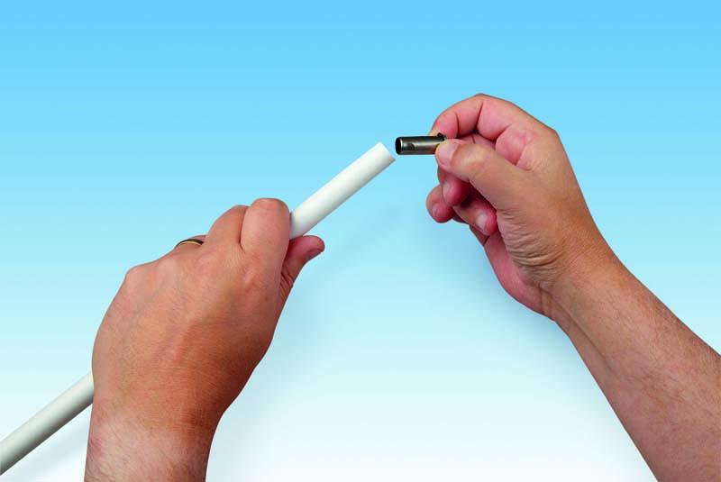

Onoff Posted September 11, 2021 Share Posted September 11, 2021 You're supposed to use a metal insert in the ends of the grey plastic pipes. It sort of reinforces the end where it goes into the plastic elbow. Indeed it would help at the red rubber pipe junction: Or as said above use a short bit of copper pipe instead of the plastic (going into the red). As an aside if you haven't already then invest in a cheap Vernier type caliper, invaluable for measuring pipe dia etc when asking questions. Random link. You can often pick up Lidl/Aldi for a tenner: https://www.amazon.co.uk/LEDLUX-Professional-Stainless-Digital-Caliper/dp/B08ZJDVPLJ/ref=mp_s_a_1_10? 1 Link to comment Share on other sites More sharing options...

Onoff Posted September 11, 2021 Share Posted September 11, 2021 8 minutes ago, joe90 said: Yes these don’t need an insert. You do for the short bit of pipe! 1 Link to comment Share on other sites More sharing options...

canalsiderenovation Posted September 12, 2021 Author Share Posted September 12, 2021 23 hours ago, Onoff said: You're supposed to use a metal insert in the ends of the grey plastic pipes. It sort of reinforces the end where it goes into the plastic elbow. Indeed it would help at the red rubber pipe junction: Any idea where I can source these from? I think the best option is going to be cut down the plastic grey bit, new olive and refit and see if that's made it lower. Or alternatively if this doesn't give us the height we need do what @Nickfromwalessuggested and fit an new elbow and move the grey thing further down as well. We made it home safely either way for now so need to do a couple of jobs before our next trip. Link to comment Share on other sites More sharing options...
Onoff Posted September 12, 2021 Share Posted September 12, 2021 6 minutes ago, canalsiderenovation said: Any idea where I can source these from? I only mean inserts both ends on the short horizontal pipe. Is there anything written on it, maybe "Hep2O"..."15mm"? When the red pipe came off, did you notice an insert in the end of the grey pipe, (they can be metal or plastic)? Link to comment Share on other sites More sharing options...
