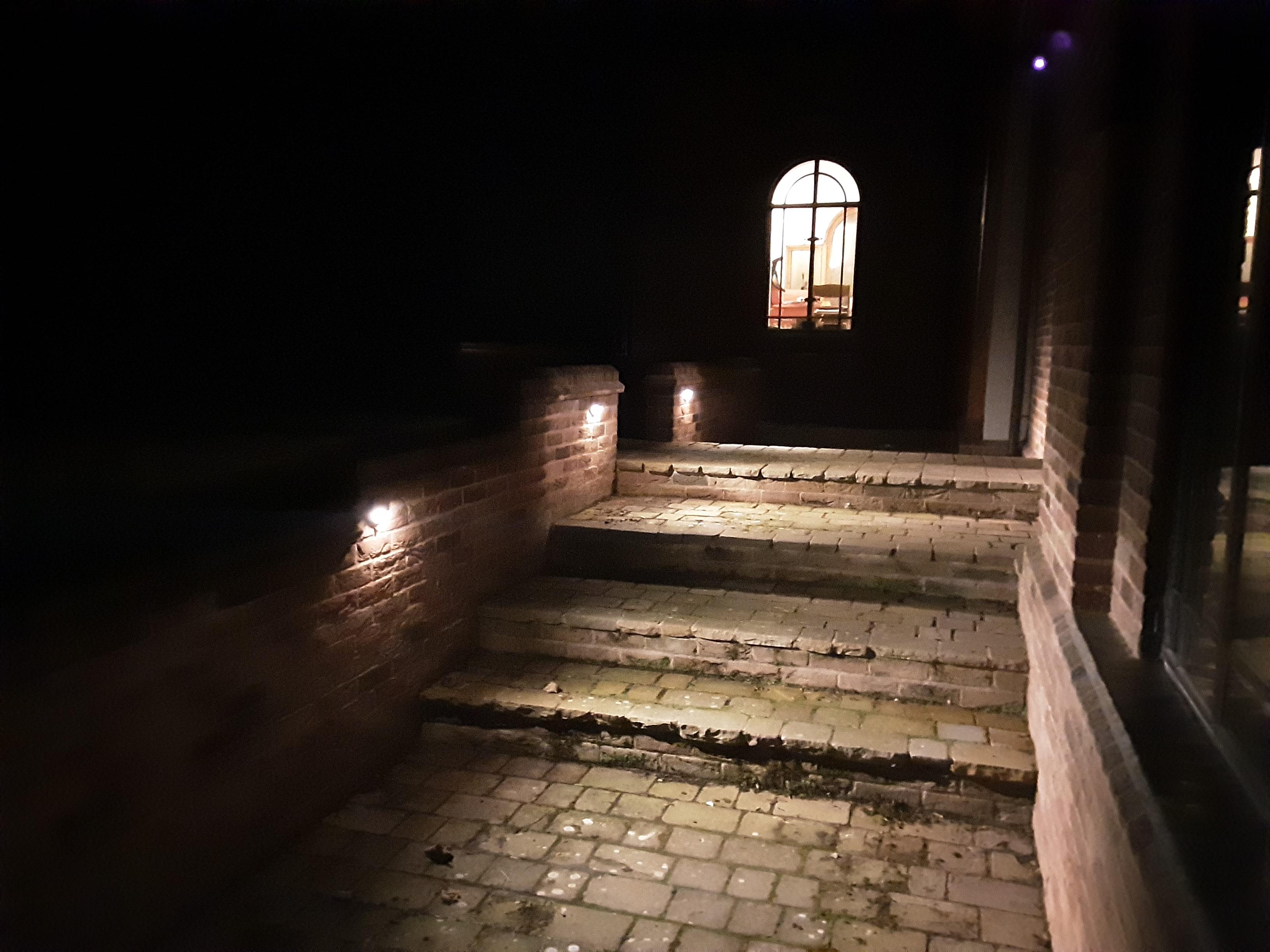

MJNewton Posted January 25, 2022 Posted January 25, 2022 3 hours ago, cwr said: Is another option to use Shelly relays to control the lights and have them time based? That's what I do for our patio lights, or rather they are set to come on at sunset and off at 11pm as their primary purpose is to remove the 'black hole' look that our bank of sliding doors would otherwise appear as when looking out from the house at night. There's a manual switch (or the app of course being 'smart' and all that!) to allow them to be overridden if/as required.
