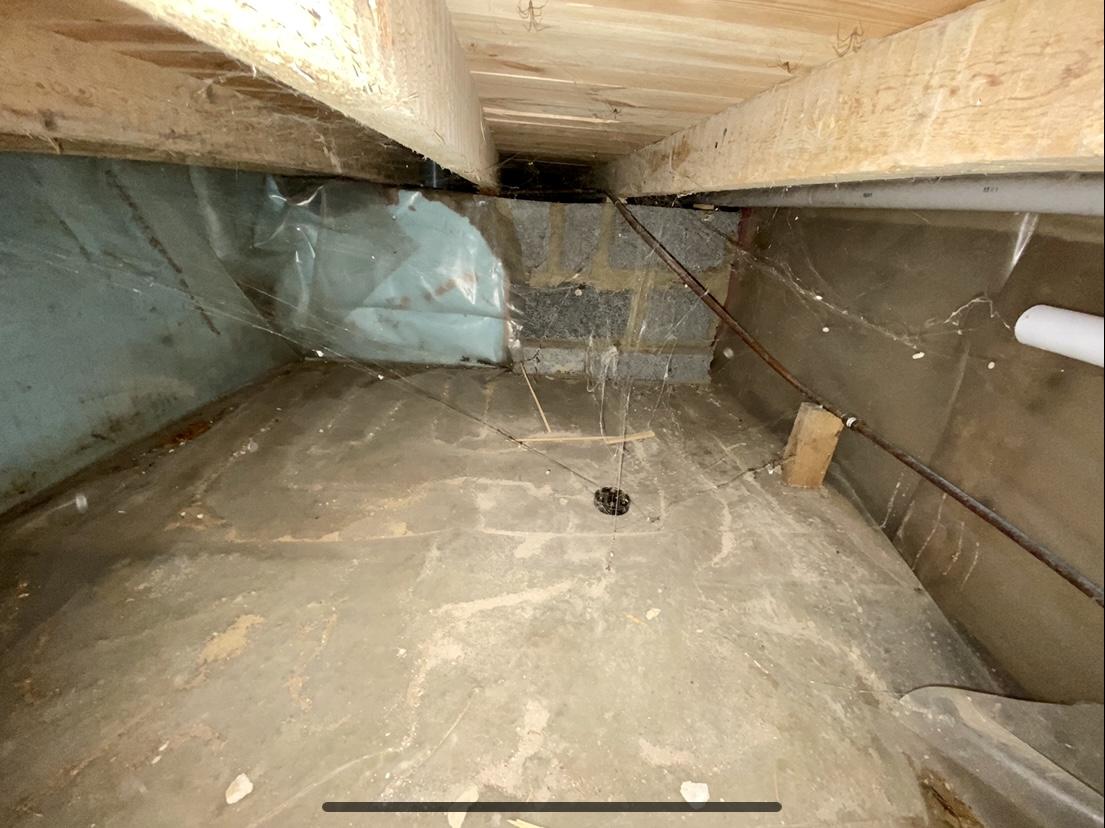

CotswoldDoItUpper Posted August 31, 2021 Posted August 31, 2021 Well, I knew it was there, but hadn’t really considered its potential use. Its currently uninsulsted and about 1700mm wide, 700mm tall (to underside of joists) and about 1600 long. It’s directly below where the UFH manifold will be going. Is there any way I can use this space for buffer tank / expansion vessels / HW cylinder? there will be/could also be access from the side (the right hand side in the pic which is just stud/plasterboard) there will be no access from the top once the floor is down. pic below because I know you all love a good pic!! 1
tonyshouse Posted August 31, 2021 Posted August 31, 2021 You can get lying down cylinders, and presumably buffer tanks too, easy for an expansion vessel
CotswoldDoItUpper Posted August 31, 2021 Author Posted August 31, 2021 (edited) 22 minutes ago, tonyshouse said: You can get lying down cylinders, and presumably buffer tanks too, easy for an expansion vessel Would something like this square one be ok? also, it would be below the manifold level. Would this be ok? https://www.advanceappliances.co.uk/product/141-buffer-stores/?gclid=EAIaIQobChMI0P3b7tzb8gIVS-rtCh3dew0PEAMYAyAAEgIxOvD_BwE Edited August 31, 2021 by CotswoldDoItUpper
ProDave Posted August 31, 2021 Posted August 31, 2021 Almost every house has a void like that. It will be below DPC, cold and damp. Anything you put there in the way of tanks etc will need GOOD access. Are you really that tight for space? Best thing you can do is crawl in there, insulate the space under the floor then seal it up and forget about it.
CotswoldDoItUpper Posted August 31, 2021 Author Posted August 31, 2021 (edited) 6 minutes ago, ProDave said: Almost every house has a void like that. It will be below DPC, cold and damp. Anything you put there in the way of tanks etc will need GOOD access. Are you really that tight for space? Best thing you can do is crawl in there, insulate the space under the floor then seal it up and forget about it. We don’t have a DPC (yet, tho there is plastic sheeting in there!), and this is below external ground level anyway by about 2m. Not tanked when it was built AFAIK. the access would be the whole side (700/1600) with doors. Hidden behind a sideboard. I’m trying to placate SWMBO who doesn’t want a tank in her 2m long hall cupboard. Putting the UFH manifold in there was a battle! Think the other option is the loft…. On the other side of the house…. ? Edited August 31, 2021 by CotswoldDoItUpper

Ferdinand Posted August 31, 2021 Posted August 31, 2021 Reading the above it seems to be an above ground level void (sloping site), so it looks useful as either an insulated space, or uninsulated space (ie insulate the door) depending on your needs.
CotswoldDoItUpper Posted August 31, 2021 Author Posted August 31, 2021 18 minutes ago, TonyT said: Pop up mini wine cellar Yes! Tho wine doesn’t seem to stick around in our house long enough to need a place to store it…. 16 minutes ago, Ferdinand said: Reading the above it seems to be an above ground level void (sloping site), so it looks useful as either an insulated space, or uninsulated space (ie insulate the door) depending on your needs. exactly! Sloping site it certainly is. how should I go about insulating it? Fix PIR to straight to wall and floor or batten out first? If so, what size batten? Does it need an air gap? No air bricks or anything that I can see. Joists 30+ years old and seem in perfectly good condition.

Iceverge Posted September 2, 2021 Posted September 2, 2021 If it's underneath groundfloor joists I assume it's ventilated. Insulation is pointless if you need to keep an airflow going to stop your joists rotting out. Even insulating between the joists you need to be careful not to block any airpaths through here. I'd put an inspection hatch in the plasterboard or the floor above. Insulate the floor and forget about it like @ProDave says. Potentially you could just use it to store things you wouldn't mind being a bit damp, spare tiles, pots of paint, wedding presents, small children........
Ferdinand Posted September 2, 2021 Posted September 2, 2021 We're avoiding it because it could be a detailed question, but let's chat. It depends on the conditions and what you want to do with it. Do you know what the temperature is in there? Is it like a space under the ground which will have a constant temp give or take (once you are a couple of feet down it will be 5C or so most of the time), or does it fluctuate? What about humidity? is it ventilated to the outside either properly eg air brick or via air leaks? Does it get moisture going through? (Ideally: run a min/max thermometer/humidistat in there for a bit. Useful things - I have about 3 of these at £10. https://www.amazon.co.uk/dp/B017KNQNZA) At present is it adjacent to the outside in any dimension, or is it buried underneath the middle of the house? If you want it eg to put tools in, dryness is important, whilst if you want it for eg wine or jam or plastic things or your drain-rodding kit or bulk household storage, it may be a bit more tolerant. Is it a room above that floor, and do you need to insulate that? Once you have decided what you want it for, then if you need to insulate you either leave it at current temp and insulate the door * and sides adjoining the house, or install an insulated box inside the cupboard and do usual airtiightness things if you want it inside the insulation envelope of the house. If you just want to stand things on the bottom, or install a freestanding shelf-frame in there, then you may be able to get away without a frame and just either glue sheets of insulation together (I did an insulated box for our cat like that), or perhaps glue them to the sides. Imagine using eg large offcuts, or 75mm or 100mm sheets. If you need a frame, then you could potentially glue your battens to the sides and affix to those, and screw to the joists above. Were I doing it, I would want to know it was dry, and I would do it in a dismountable way which lets me get behind the cupboard without destroying it. I hope that is a few points. Spare materials for the house is a good call. Ferdinand * One neat way to do that is with magnetic catches and a panel with two handles that is 'magneted' to the wall.
