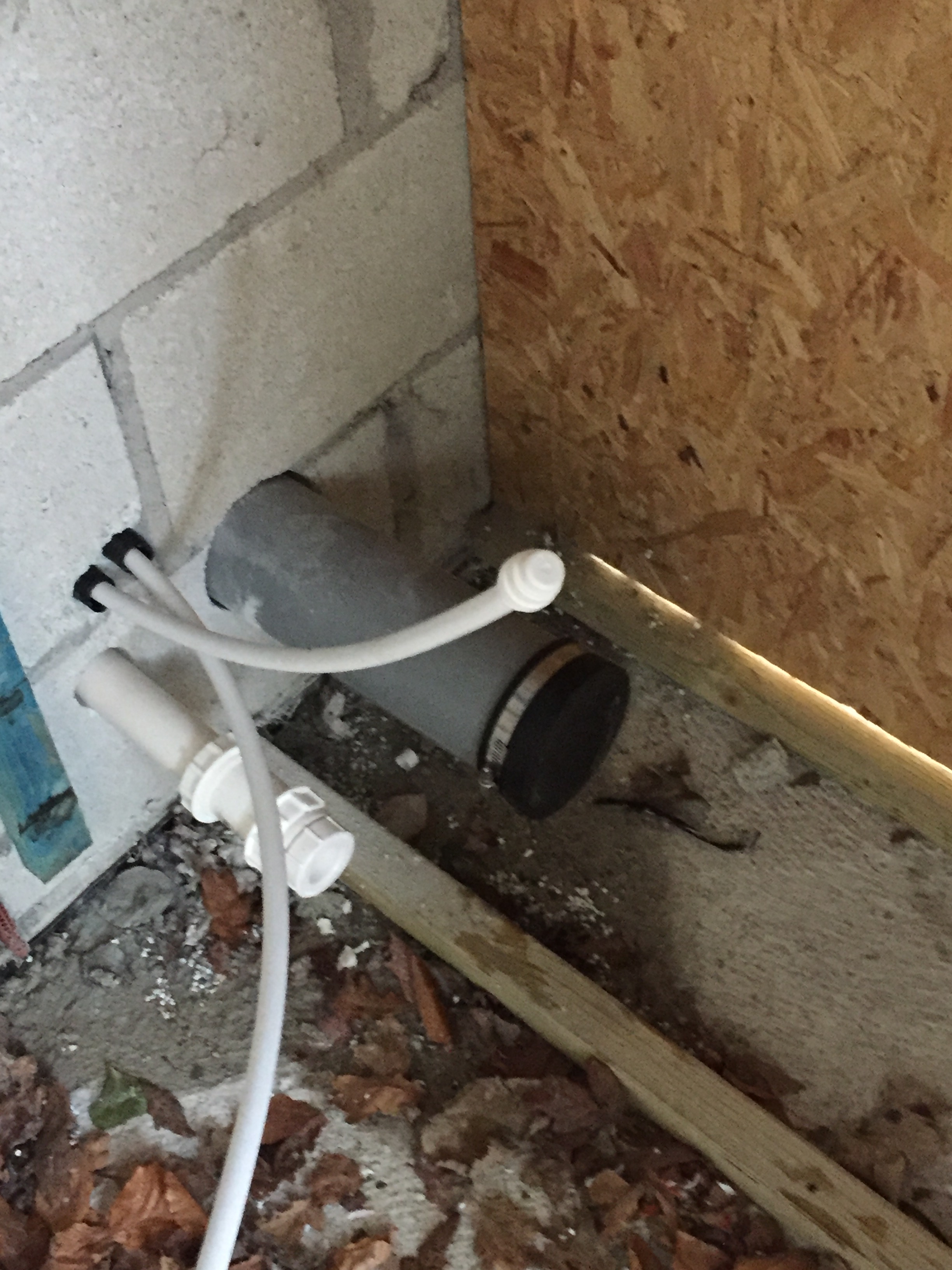

Barney12 Posted March 24, 2017 Share Posted March 24, 2017 Just wanted a quick bit of collective advice? Here's a picture of the soil pipe coming out into the new outside toilet. It's 20cm into the room (due to the rear wall of the garage being thicker than the simple stud frame of the outside loo). The close coupled WC (already purchased) is going against the wall which is OSB clad. So I can either stud out a false wall to bring the WC forward (which isn't a problem, I've got room) or some how I've got to move the pipe back. Some form of "S" bend in 110 pipe doesn't feel like a good idea and I don't normally like those flexi connectors but this is feeling like a situation where that's the only option? Any other thoughts? Link to comment Share on other sites More sharing options...
ProDave Posted March 24, 2017 Share Posted March 24, 2017 Two 45 degree single socket bends one into the other might give enough set back. Link to comment Share on other sites More sharing options...

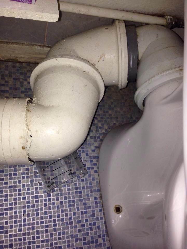

Onoff Posted March 24, 2017 Share Posted March 24, 2017 Sort of like I've done here then: Possibly a couple of 67.5o bends? I'll have a look later at the, ahem "over ordered" bits I have... Link to comment Share on other sites More sharing options...
Nickfromwales Posted March 24, 2017 Share Posted March 24, 2017 +1. Chase the block work around the pipe to get a 45o bend ( double socket ) recessed into the wall and then a single socket 45o bend into that to get you back tight against the wall. 2 x single socket 45's prob won't get you back far enough. Link to comment Share on other sites More sharing options...

Onoff Posted March 24, 2017 Share Posted March 24, 2017 Out of interest, would 90os be a definite no-no here, in the interests of keeping everything tight? Or is that just asking for a literal log jam? Link to comment Share on other sites More sharing options...
Nickfromwales Posted March 24, 2017 Share Posted March 24, 2017 You won't get two 90's back to back in that short a space. At 200mm from the back wall to the back of the soil, it's less than a whole pipe width . Link to comment Share on other sites More sharing options...

Onoff Posted March 25, 2017 Share Posted March 25, 2017 Just playing with some fittings here in case it helps, assume the maple Contiboard is the OSB wall: Two 45o solvent weld, M/F then a solvent/ring seal adaptor then push fit pan connector. 150mm from "OSB" to centre of 110mm. Projects nom 300mm along: Then two 67.5o solvent weld M/F, puts centre of pipe nom 200mm from "OSB". Projects along about 275mm: 1 Link to comment Share on other sites More sharing options...
Barney12 Posted March 25, 2017 Author Share Posted March 25, 2017 1 hour ago, Onoff said: Just playing with some fittings here in case it helps, assume the maple Contiboard is the OSB wall: Two 45o solvent weld, M/F then a solvent/ring seal adaptor then push fit pan connector. 150mm from "OSB" to centre of 110mm. Projects nom 300mm along: Then two 67.5o solvent weld M/F, puts centre of pipe nom 200mm from "OSB". Projects along about 275mm: Thats fab. Thanks for doing that. Link to comment Share on other sites More sharing options...

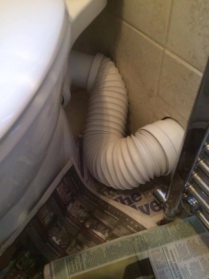

Russell griffiths Posted March 25, 2017 Share Posted March 25, 2017 All you chaps just seem to over complicate things, just get a flexible fitting like this one. Jobs a goodun. Link to comment Share on other sites More sharing options...
Nickfromwales Posted March 25, 2017 Share Posted March 25, 2017 1 minute ago, Russell griffiths said: All you chaps just seem to over complicate things, just get a flexible fitting like this one. Jobs a goodun. Two words for that. Dog & shit. Link to comment Share on other sites More sharing options...

Barney12 Posted March 25, 2017 Author Share Posted March 25, 2017 1 hour ago, Russell griffiths said: All you chaps just seem to over complicate things, just get a flexible fitting like this one. Jobs a goodun. I assume the newspaper is to soak up the leaking poo? Link to comment Share on other sites More sharing options...

ProDave Posted March 25, 2017 Share Posted March 25, 2017 Is that REALLY a flexible pan connector? It looks like that horrible flexible ducting for extract fans to me. Link to comment Share on other sites More sharing options...
Nickfromwales Posted March 25, 2017 Share Posted March 25, 2017 1 hour ago, ProDave said: Is that REALLY a flexible pan connector? It looks like that horrible flexible ducting for extract fans to me. That would probably do a better job Link to comment Share on other sites More sharing options...
