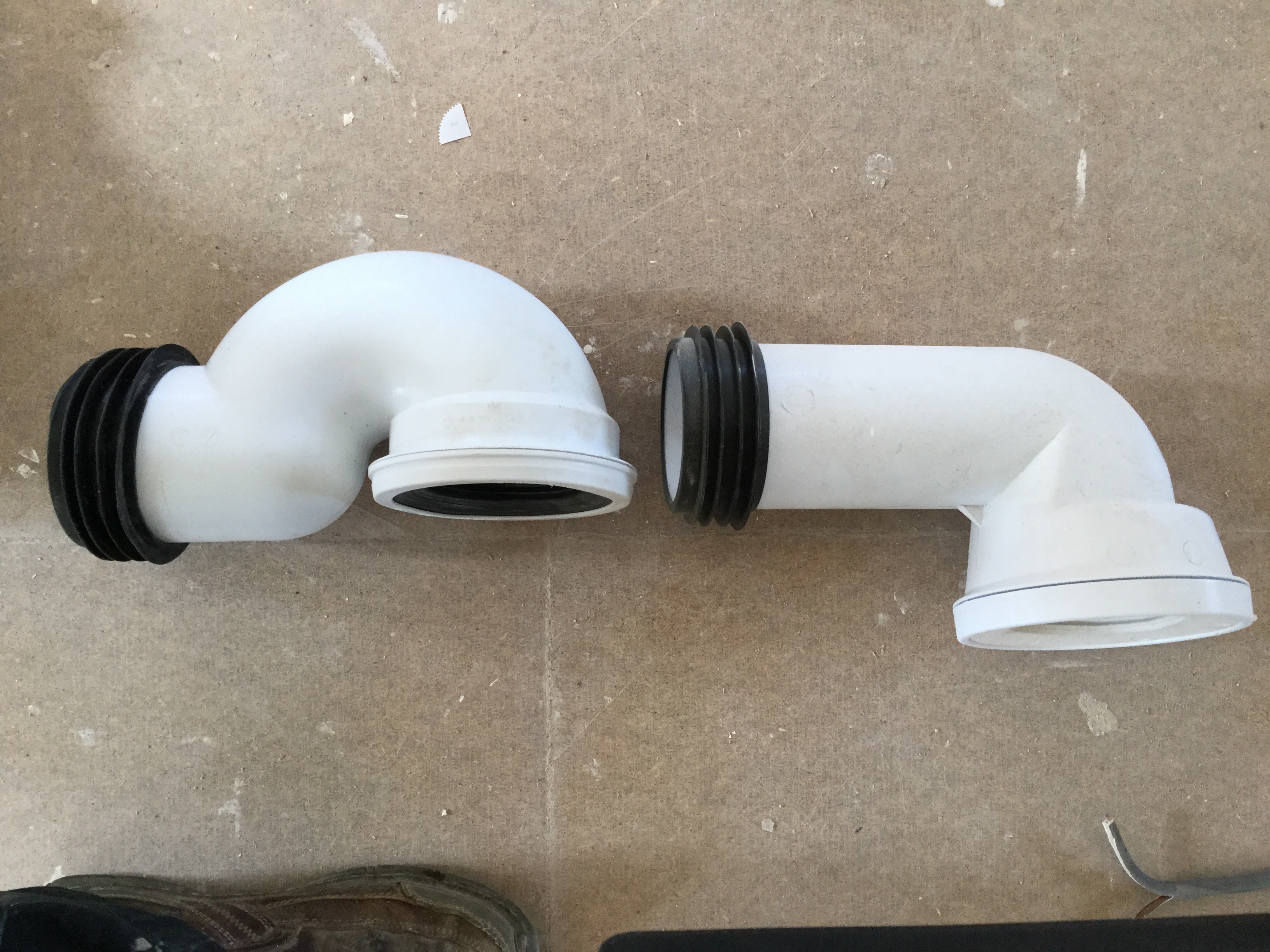

I too have a toilet connecting problem so adding to this thread. The pipe in the floor is a bit far from the wall and a standard connector leaves the cistern out from the wall about 25mm, ( I could batten it out but a bit of a bodge in my opinion)  if I use a swan neck connector it won’t quite reach the toilet. Does anyone know of a connector half way between the two?

Cant you push back on the standard one 10-15mm and then just lean the cistern back the last 10mm so it can be affixed? Thats what I'd do.

what about using an extension  https://www.toolstation.com/shop/p19642
Thats not an extension as such, and if you push that into another pan connectors then you have rings sitting inside rings, rather than rings being compressed against a circular wall.
Ive done it where there has been no other choice, but its not ideal at all.

If you removed the rings, would it not just be a male to female?
Just visited my local builders merchant and hey presto, a shorter version of the one I had that was too long so the problem is fixed. Thanks for your comments guys.?
