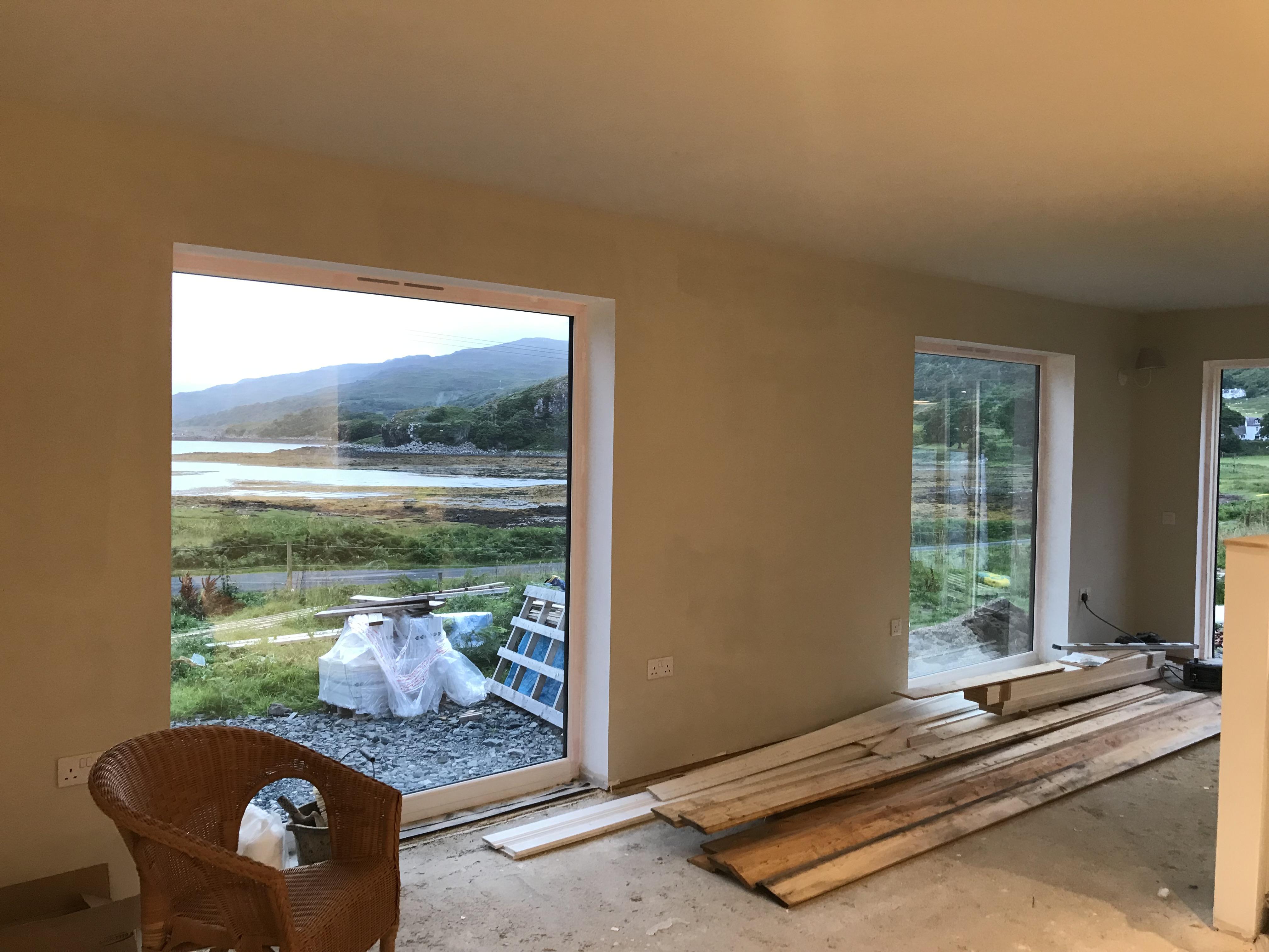

Grian Posted August 21, 2021 Posted August 21, 2021 Not polished, but just ordinary concrete made as level and smooth as possible and painted - is there a reason not to use it as a floor? I have wet underfloor heating in the slab so it wouldn't be cold. I don't see it being any harder or more slippery than tiles, and an advantage being it can be repainted for a change of colour. In practice I've only had this on utility/garage floors, but it seemed fine there. I must be missing something or people would have this...? Thank you!

saveasteading Posted August 21, 2021 Posted August 21, 2021 Nobody will notice as they will be looking at the view. Just make sure the concrete is dry before sealing it. 1
Grian Posted August 21, 2021 Author Posted August 21, 2021 2 minutes ago, saveasteading said: Nobody will notice as they will be looking at the view. Just make sure the concrete is dry before sealing it. Am hoping that applies to my painting too! Thanks.

dpmiller Posted August 21, 2021 Posted August 21, 2021 I see the view, and don't care about the floor covering. It's gorgeous, I'm very jealous. 1
