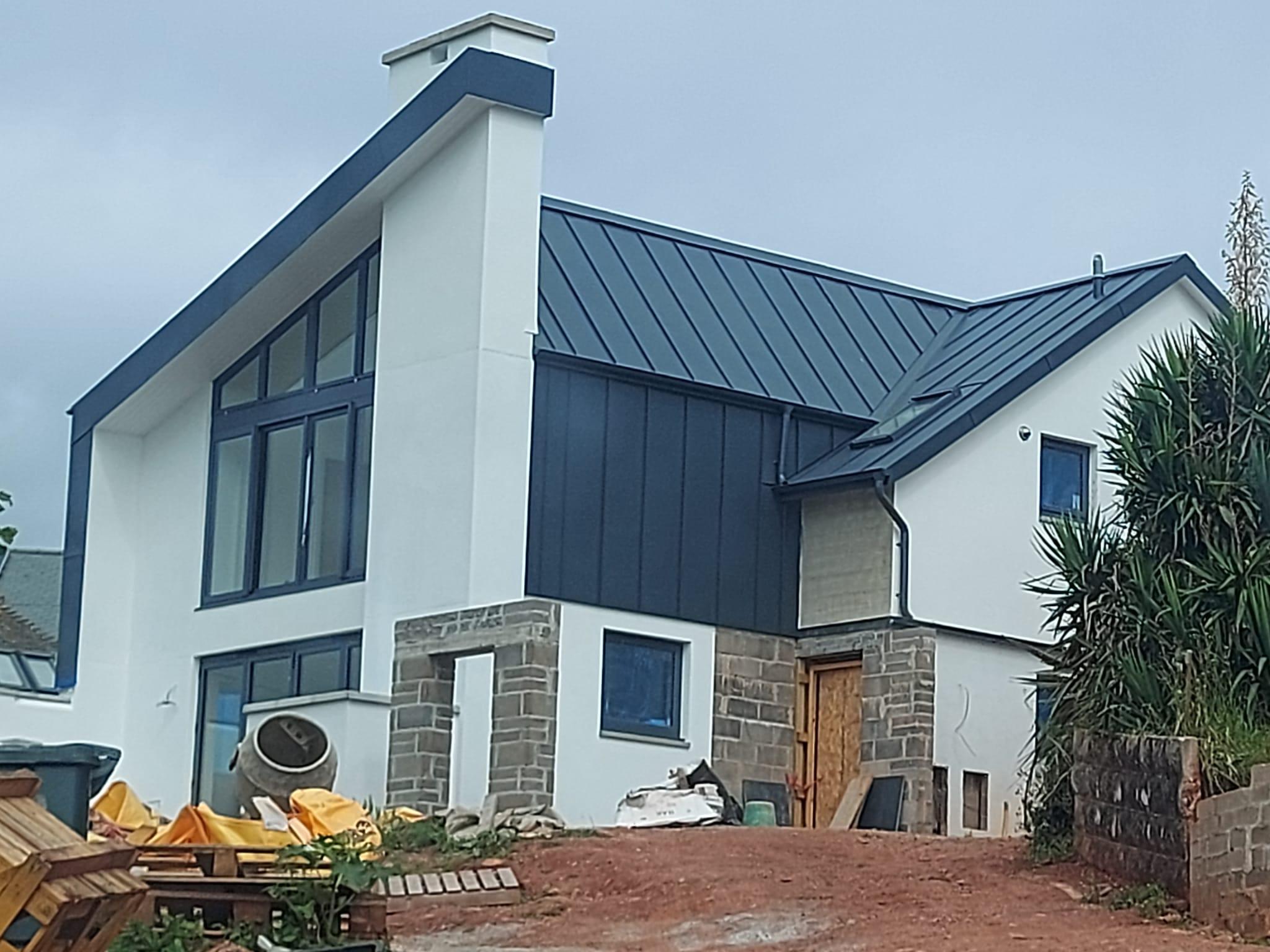

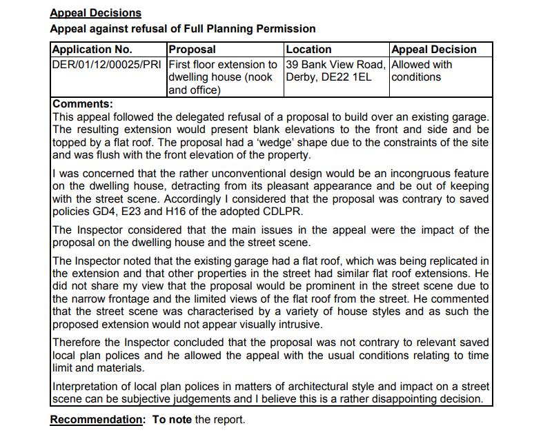

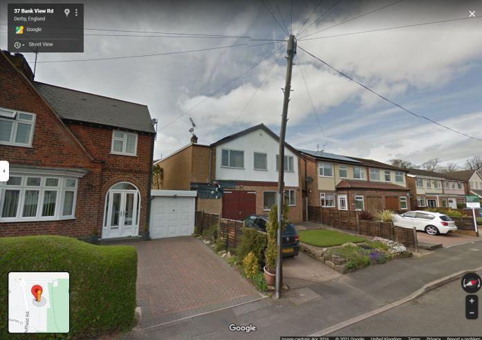

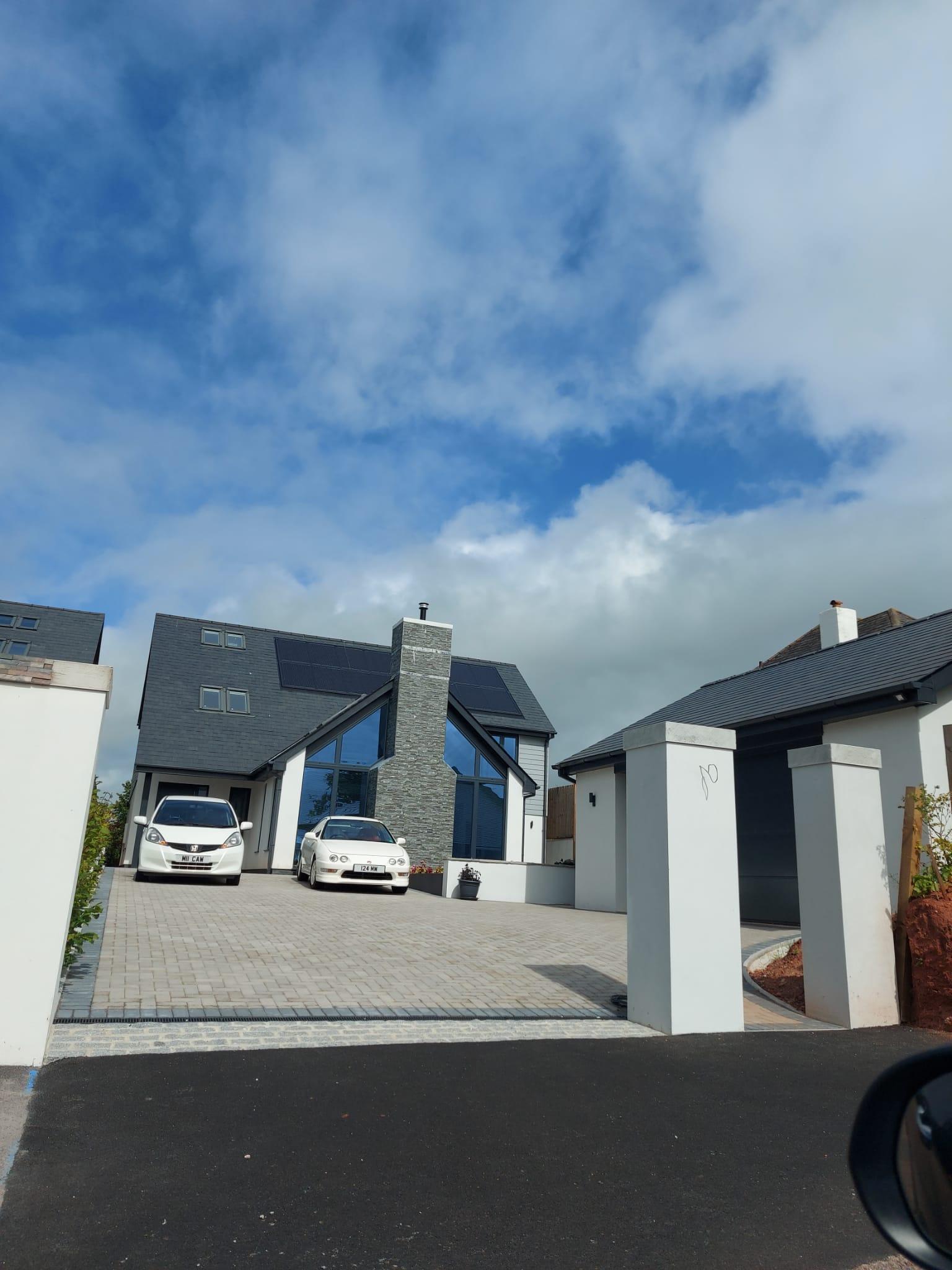

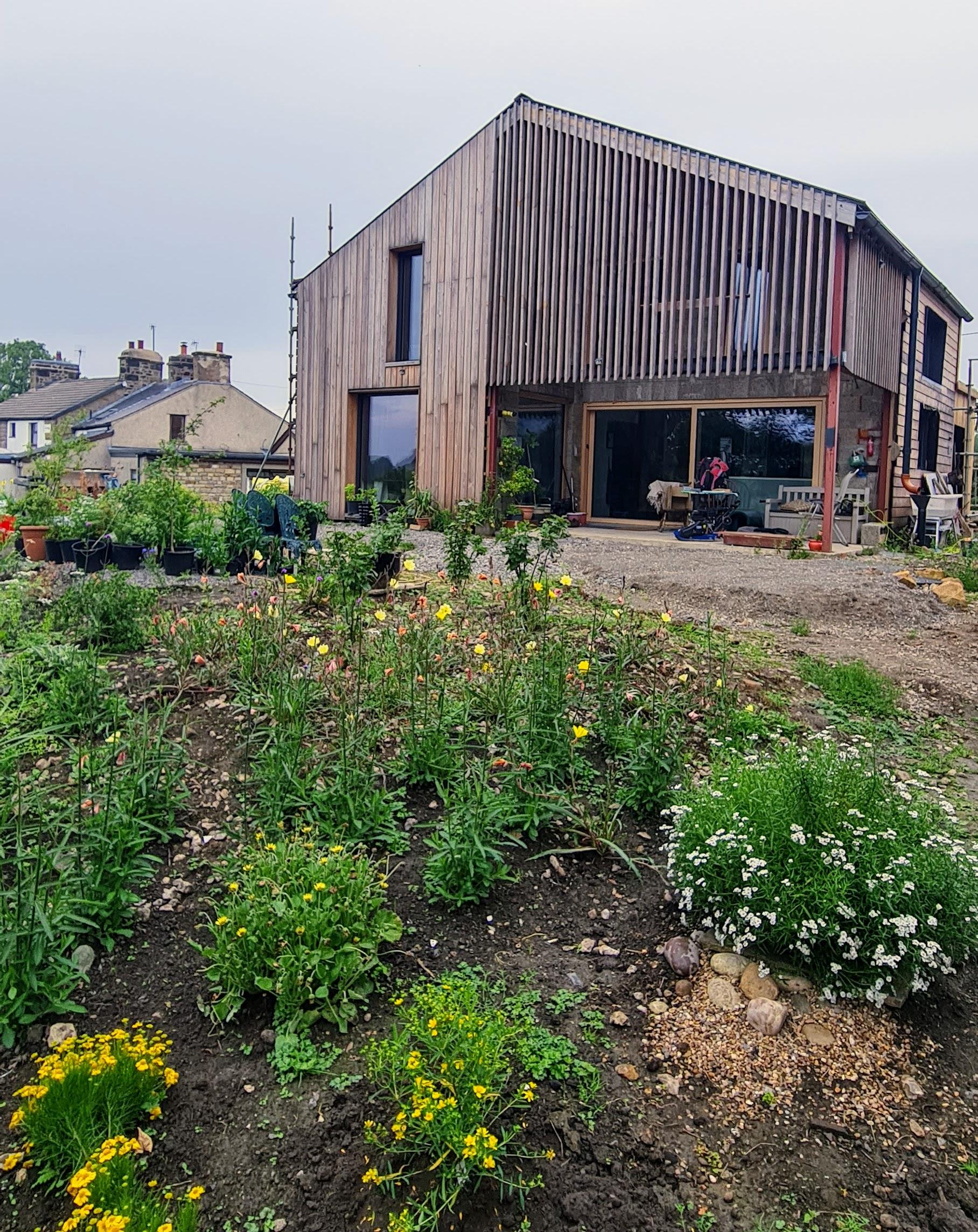

ToughButterCup Posted August 16, 2021 Posted August 16, 2021 Not in keeping with the street scene as a valid reason for refusal, eh......... ? Hmmmm, well have a look at this First our old house and below, the house we've built in what was the garden of the house photographed above ... on the same street 25 meters away. You can just see the back view of the house above A valid reason for refusal? No. Here's the very first google hit I found for the search string ' ... not in keeping with the street scene ...' @RichyC : tinker with the design a bit, listen between the lines - you will get there. Ian downloaded and converted to a photo from https://democracy.derby.gov.uk/CMIS5/Document.ashx?czJKcaeAi5tUFL1DTL2UE4zNRBcoShgo=6sfcDwW%2FB6oXuOm7JmS4CE7cM6rThhSZgYE5EyQIUAhfOYL5qXs2bQ%3D%3D&mCTIbCubSFfXsDGW9IXnlg%3D%3D=hFflUdN3100%3D&kCx1AnS9%2FpWZQ40DXFvdEw%3D%3D=hFflUdN3100%3D&uJovDxwdjMPoYv%2BAJvYtyA%3D%3D=ctNJFf55vVA%3D&FgPlIEJYlotS%2BYGoBi5olA%3D%3D=NHdURQburHA%3D&d9Qjj0ag1Pd993jsyOJqFvmyB7X0CSQK=ctNJFf55vVA%3D&WGewmoAfeNR9xqBux0r1Q8Za60lavYmz=ctNJFf55vVA%3D&WGewmoAfeNQ16B2MHuCpMRKZMwaG1PaO=ctNJFf55vVA%3D 16/08/2021

Ferdinand Posted August 16, 2021 Posted August 16, 2021 On 16/08/2021 at 09:36, ToughButterCup said: Not in keeping with the street scene as a valid reason for refusal, eh......... ? Hmmmm, well have a look at this Here's the very first google hit I found for the search string ' ... not in keeping with the street scene ...' @RichyC : tinker with the design a bit, listen between the lines - you will get there. Ian downloaded and converted to a photo from https://democracy.derby.gov.uk/CMIS5/Document.ashx?czJKcaeAi5tUFL1DTL2UE4zNRBcoShgo=6sfcDwW%2FB6oXuOm7JmS4CE7cM6rThhSZgYE5EyQIUAhfOYL5qXs2bQ%3D%3D&mCTIbCubSFfXsDGW9IXnlg%3D%3D=hFflUdN3100%3D&kCx1AnS9%2FpWZQ40DXFvdEw%3D%3D=hFflUdN3100%3D&uJovDxwdjMPoYv%2BAJvYtyA%3D%3D=ctNJFf55vVA%3D&FgPlIEJYlotS%2BYGoBi5olA%3D%3D=NHdURQburHA%3D&d9Qjj0ag1Pd993jsyOJqFvmyB7X0CSQK=ctNJFf55vVA%3D&WGewmoAfeNR9xqBux0r1Q8Za60lavYmz=ctNJFf55vVA%3D&WGewmoAfeNQ16B2MHuCpMRKZMwaG1PaO=ctNJFf55vVA%3D 16/08/2021 Expand This was built. 39 Bank View Road, Derby is the one in the middle below. You can see the "blank wall" etc.

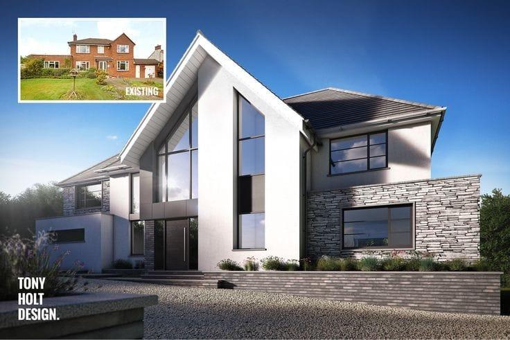

RichyC Posted August 17, 2021 Author Posted August 17, 2021 So this isn't a demolish and rebuild. We were trying to work on the existing footprint to save it being demolished. Thr architect suggested cascading the front facade into align with the current look. Thr Planners are flatly refusing anything like this stating 1. Too much glass ; needs to look more domesticated 2. Too many gables 3. Too large (however plot is nearly third of acre) 4. Requires pitched roof to the left hand side of the building (we're very confused as to why they want this). In this instance the architect said they weren't keen to give opinions as to advice for a successful application. Rather just tell us what they don't like. My original idea and one I still prefer is something like the picture below. However, it was suggested this was Too massive with a flat front facade and huge entrance gable.. plus it's a house, not a bunglow. It would also require demolition of existing which I was initially against. The issue is now we're about 7k in with nothing to show.(ecology survey was 2k due to size of plot) To put another say 3k into a redesign means in 10k in the hole and it may still be refused.

AliG Posted August 18, 2021 Posted August 18, 2021 I think that an issue the planners may have is that it looks like more than one house or it will from a distance. The house looks quite a different shape to the existing to me so I am not convinced you could even use the existing foundation. Irrespective the 20% VAT saving would pay for new foundations. If the two elements to the left were combined then you would lose a gable and two of the pointy windows and it would look a lot more like the house you referenced. This would seem like a pretty modest redesign. I guess they want a hipped roof at the left, seems a bit prescriptive to me. Does the house cover more of the plot than before? If not often simply giving them the numbers for plot coverage gets around this. It’s not always obvious just by looking.
