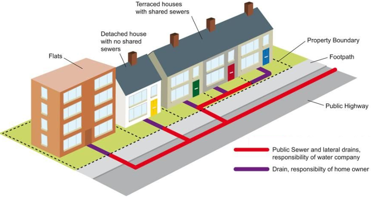

Carrerahill Posted August 18, 2021 Posted August 18, 2021 (edited) On 14/08/2021 at 23:53, ashthekid said: @Temp that is very interesting. I wonder if the neighbours are aware of that. I wonder if it matters that the pipe leaves our boundary and into the neighbours back patio before then passing underneath their property to the main road. That illustration shows it out front by the public pavement. I can say with absolute certainty, your neighbours are dealing with a sewer in their garden, not your soil pipe, a soil pipe is a private water waste line, a sewer is a public duct for water waste. The builder will know this too, he doesn't want the water board to know. I would call the water board. Edited August 18, 2021 by Carrerahill

epsilonGreedy Posted August 18, 2021 Posted August 18, 2021 29 minutes ago, Carrerahill said: It is not your soil pipe as soon as it leaves your boundary, it becomes a sewer after this point and is the responsibility of the water board. That is an interesting subtlety I was unaware of. I thought the public sewer began at the most upstream connection point of private soil pipes, but your post and the @temp diagram indicate the public sewer starts at the upstream boundary of the plot where the connection is made. I wonder what financial hit the bean counters at the big water co's calculated when the new 2011 legislation came into effect since they are now responsible for a much larger drainage network.

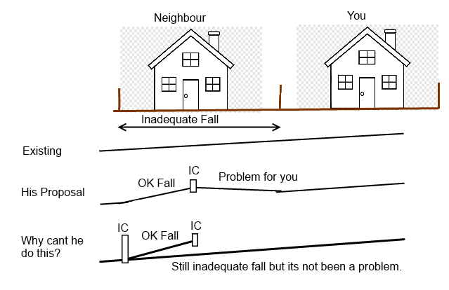

ashthekid Posted August 18, 2021 Author Posted August 18, 2021 @Temp The neighbours already have an existing manhole which he says has an almost equally bad run into their neighbours next to them. They aren’t installing any new pipework for themselves. It’s just my pipework that they are concerned about apparently. He said that the Water Company might insist on all of our runs to be dug up and repaired with a proper run that will pass building control recommendations for gradients. @dangti6 I don’t think there is anything in the deeds that specifically relates to these pipes or sewerage. I couldn’t see anything about it. And no sewerage plans upon purchase as it went into the neighbouring property and there were no obvious problems or issues with waste disappearing. @Carrerahill it’s not fit for purpose apparently because the gradient isn’t sufficient to give it a good enough run and according to the builder it won’t last once our conversion project is finished and my family is living there using multiple toilets/showers/sinks etc. The whole run from all three property’s that share the same pipe is probably inadequate according to Building Control despite it being fine for many years. That said, the neighbour has apparently experienced some issues with blockages from their property to the shared pipe but that’s not been on the section from my property of course.

ashthekid Posted August 18, 2021 Author Posted August 18, 2021 Update: So it seems the neighbours builder has created a workaround - to create a totally new drain for them. Replace the existing pipework from ours, leaving us with access to the existing manhole inside their patio(that isn’t being built on). We will be the only ones using the existing drain and they will have access to a newly created drain which I’m assuming will be raised so they have the adequate run whilst we will continue to use the current run that has existed for years, albeit without the little raise that was there but not causing us a problem. They’ve asked me if I want to raise the inlet on our side of the boundary party wall then I must let them know by 4pm tomorrow. Sadly we can’t do that because of all the pipework we have already concreted into the groundworks with the correct runs etc. Seems a logical solution?!? Do you think I still get Water Company involved at this stage?

Temp Posted August 18, 2021 Posted August 18, 2021 2 hours ago, ashthekid said: They aren’t installing any new pipework for themselves. It’s just my pipework that they are concerned about apparently. He said that the Water Company might insist on all of our runs to be dug up and repaired with a proper run that will pass building control recommendations for gradients. Normally the BCO won't look at existing drains unless alterations or new connections are being made. I'm wondering if the BCO knows they should have got approval from the water co and that's the real reason for his concern. 2 hours ago, ashthekid said: He said that the Water Company might insist on all of our runs to be dug up and repaired with a proper run that will pass building control recommendations for gradients. I think its unlikely given there haven't been any problems with it and nobody is making any changes to it. If the neighbours are building over the sewer then they should be getting approval from the water co. The water co might insist the sewer is diverted around their foundations or allow them to build over. In some cases it is not possible to do what water co insist on. In such circumstances it might not be possible to build what/where they want.
Temp Posted August 18, 2021 Posted August 18, 2021 15 minutes ago, ashthekid said: So it seems the neighbours builder has created a workaround - to create a totally new drain for them. Replace the existing pipework from ours, leaving us with access to the existing manhole inside their patio(that isn’t being built on). We will be the only ones using the existing drain and they will have access to a newly created drain which I’m assuming will be raised so they have the adequate run whilst we will continue to use the current run that has existed for years, albeit without the little raise that was there but not causing us a problem. Get photos of the existing layout and the new one. If the new pipe is no longer shared then it might become your responsibility rather than the water co. If you have photos you can prove it was theirs and the neighbours changed it. 1
