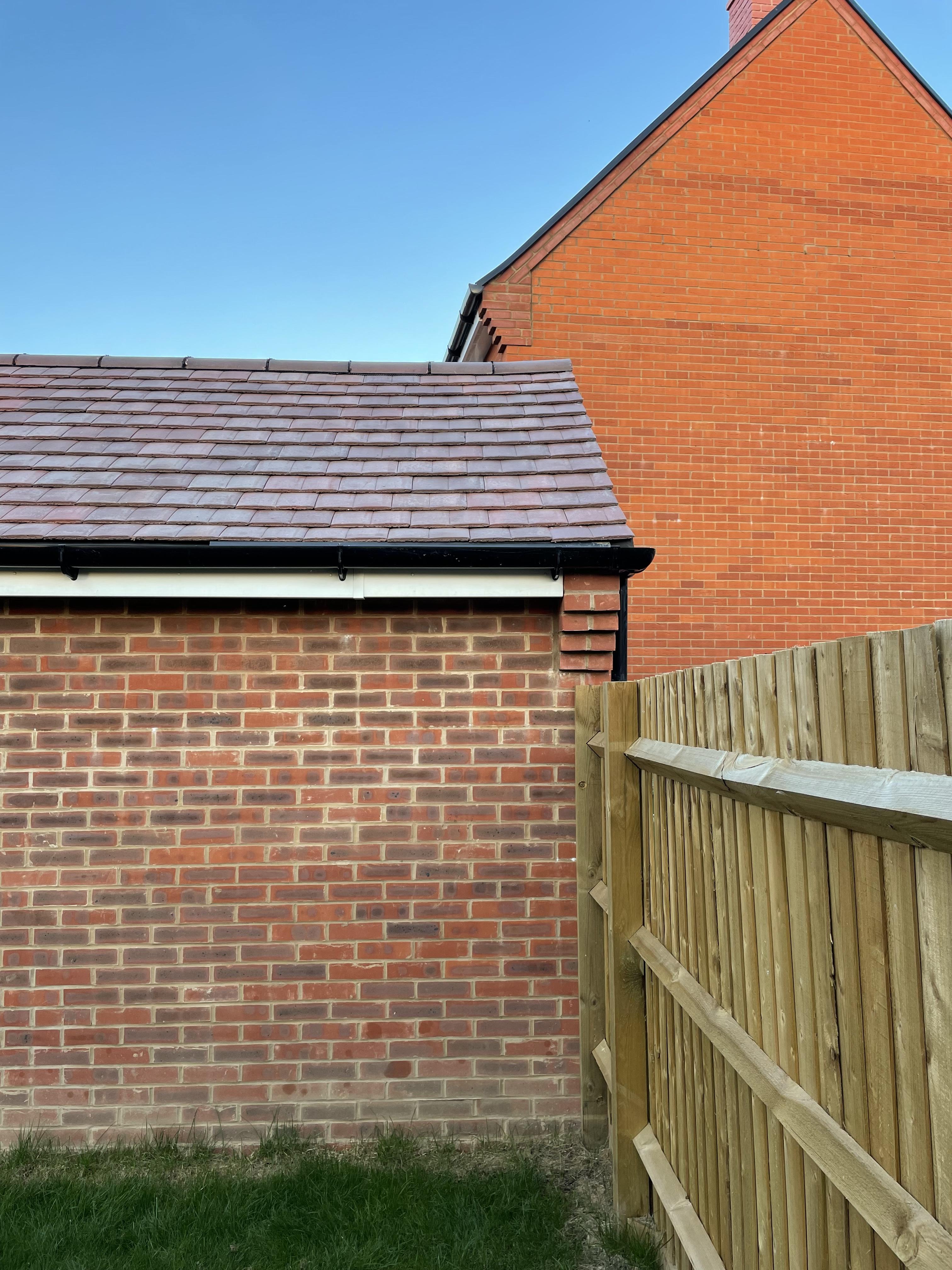

Ryan G Posted August 4, 2021 Share Posted August 4, 2021 Hi all Hoping for some advise regarding a garage roof. In short, both ends of the garage ‘bow upwards’, and I would like to understand if this is normal, expected, and if it’s in/out of acceptable tolerance. Attached is a pic, which shows the final top tile pointing slightly upwards, and the corner of the bottom tile pointing upwards. In addition to this, the edge of the roof is mortar and doesn’t have a ‘cap’. Is this expected? None of this looks right to my untrained eye, so some input from people more qualified would be much appreciated. Thanks in advance Link to comment Share on other sites More sharing options...
PeterW Posted August 4, 2021 Share Posted August 4, 2021 Yep find that when the brickwork is slightly high and the tile battens run over the gable. More noticeable with those sorts of tiles but top marks to the roofer to cut the second to last ridge tile so you don’t see a cut end. 1 Link to comment Share on other sites More sharing options...
Faz Posted August 4, 2021 Share Posted August 4, 2021 +1 - I think he has done that right mate given he has tiled to the brick gable end. It might have wanted a brick less on the gables but the solution works. I wouldn't worry about it unless the Mrs starts moaning (which she won't if you don't point out the issue!). Link to comment Share on other sites More sharing options...
joe90 Posted August 4, 2021 Share Posted August 4, 2021 Some roofers kick the ends up slightly to drive any water away from the gable end. 1 Link to comment Share on other sites More sharing options...
Bonner Posted August 4, 2021 Share Posted August 4, 2021 +1 - looks like a good job to me. Traditionally slate and tile roofs had slight kick at the gable end to prevent rain running off the edge. Link to comment Share on other sites More sharing options...
Gus Potter Posted August 4, 2021 Share Posted August 4, 2021 1 hour ago, PeterW said: Yep find that when the brickwork is slightly high and the tile battens run over the gable. More noticeable with those sorts of tiles but top marks to the roofer to cut the second to last ridge tile so you don’t see a cut end. Peter.. your eye is remarcable! the cut ridge tile. 1 hour ago, Ryan G said: Hi all Hoping for some advise regarding a garage roof. In short, both ends of the garage ‘bow upwards’, and I would like to understand if this is normal, expected, and if it’s in/out of acceptable tolerance. Attached is a pic, which shows the final top tile pointing slightly upwards, and the corner of the bottom tile pointing upwards. In addition to this, the edge of the roof is mortar and doesn’t have a ‘cap’. Is this expected? None of this looks right to my untrained eye, so some input from people more qualified would be much appreciated. Thanks in advance Ryan. Technically you could get out all the standards, manufacture's info and see if it complies. That will take a lot of time an effort. Even if you do this you often come up against the phrase " visually acceptable" and that is an issue.. acceptable to whom? Just a question as the photo is not that high resolution. Are there some really narrow cuts in the roof? In other words are the side laps ok? In other words we know that up and down the roof the tiles / slates need to over lap the ones below by a certain amount. But they also need to overlap sideways.. parallel to the ridge by a certain amount. You can get this side lap size from the manufacture's data sheet. If all ok then once it's weathered a bit then it will mostly all blend in. Link to comment Share on other sites More sharing options...
saveasteading Posted August 4, 2021 Share Posted August 4, 2021 I rather like the upward curve. A Japanese feel to it. This has the advantage of deflecting all water down the slope and not dribbling down the gable. The picture is high def as it has reached me. Thus I can see that the tiles are 'dummy doubles', ie moulded to look smaller than they are. So the apparently thin ones at the gable are more like one and a halfs. The ridge though seems to have been fixed and sealed with lots of black mastic....is that approriate? There is also something in the gutter. Link to comment Share on other sites More sharing options...
SuperJohnG Posted August 4, 2021 Share Posted August 4, 2021 A kock can be normal as mentioned above to put water back to the roof and then into gutter. But I wouldn't be pointing a roofer if you don't like the kick I'd be at the bricky and or joiner who should have made it all line through. Looks fine. Link to comment Share on other sites More sharing options...
Ryan G Posted August 5, 2021 Author Share Posted August 5, 2021 Thank you all for your input. So what I have learned is that the brickwork is clearly a little high on that end, I think I can live with that though. Thanks again for your help Link to comment Share on other sites More sharing options...
