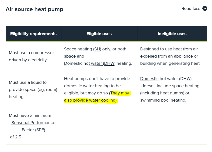

IanR Posted August 5, 2021 Share Posted August 5, 2021 45 minutes ago, nod said: The three I spoke to All thought cooling effected the RHI Up to 2017 ASHP were not permitted to cool on RHI, but that changed at the end of 2017. From the Ofgem website: 1 1 Link to comment Share on other sites More sharing options...
Marvin Posted August 5, 2021 Share Posted August 5, 2021 Hi IanR Thanks for this. I think you said this before. Sorry I didn't take notice. I will follow this up with my supplier.. M Link to comment Share on other sites More sharing options...
Marvin Posted August 5, 2021 Share Posted August 5, 2021 1 hour ago, IanR said: Up to 2017 ASHP were not permitted to cool on RHI, but that changed at the end of 2017. I'm not sure what this means. When they talk about heating a room Ofgem use the phrase "space heating". Why didn't Ofgem say "space cooling" instead of water cooling? If no one knows the answer I will have to ask Ofgem.? Any help out there? Link to comment Share on other sites More sharing options...
Marvin Posted August 5, 2021 Share Posted August 5, 2021 I am now reading the 63 pages of the ofgem Domestic Renewable Heat Incentive Essential Guide for Applicants which will be followed by 65 pages of the ofgem Domestic Renewable Heat Incentive Reference Document. To try and find what is meant by water cooling....? Link to comment Share on other sites More sharing options...
Dan F Posted August 5, 2021 Share Posted August 5, 2021 17 minutes ago, Marvin said: To try and find what is meant by water cooling....? Simply means you have to use a air-to-water heat-pump for heating/cooling and aircon type units are not allowed. 1 1 Link to comment Share on other sites More sharing options...
Ommm Posted August 5, 2021 Share Posted August 5, 2021 (edited) It is mentioned under a strange heading: Quote Heat pumps can’t be designed to use ‘exhaust air’: Air source heat pumps can’t be designed to use exhaust heat. That’s residual heat which has been expelled from a building or appliance, as in, for example, building ventilation systems. Heat pumps that provide cooling are eligible, but RHI payments will not include energy used for cooling. Heat pumps that only provide cooling, such as air conditioning units, are not eligible. https://www.ofgem.gov.uk/sites/default/files/docs/2021/03/drhi_essentialguideforinstallers_mar2021_v6.pdf It's unclear if that's solely about MVHR heat pumps or applies to heat pumps generally. If it was about MVHR the third sentence doesn't really make sense (MVHR forbidden, MVHR with cooling still forbidden, non-MVHR ASHP allowed?) Edited August 5, 2021 by Ommm Link to comment Share on other sites More sharing options...
