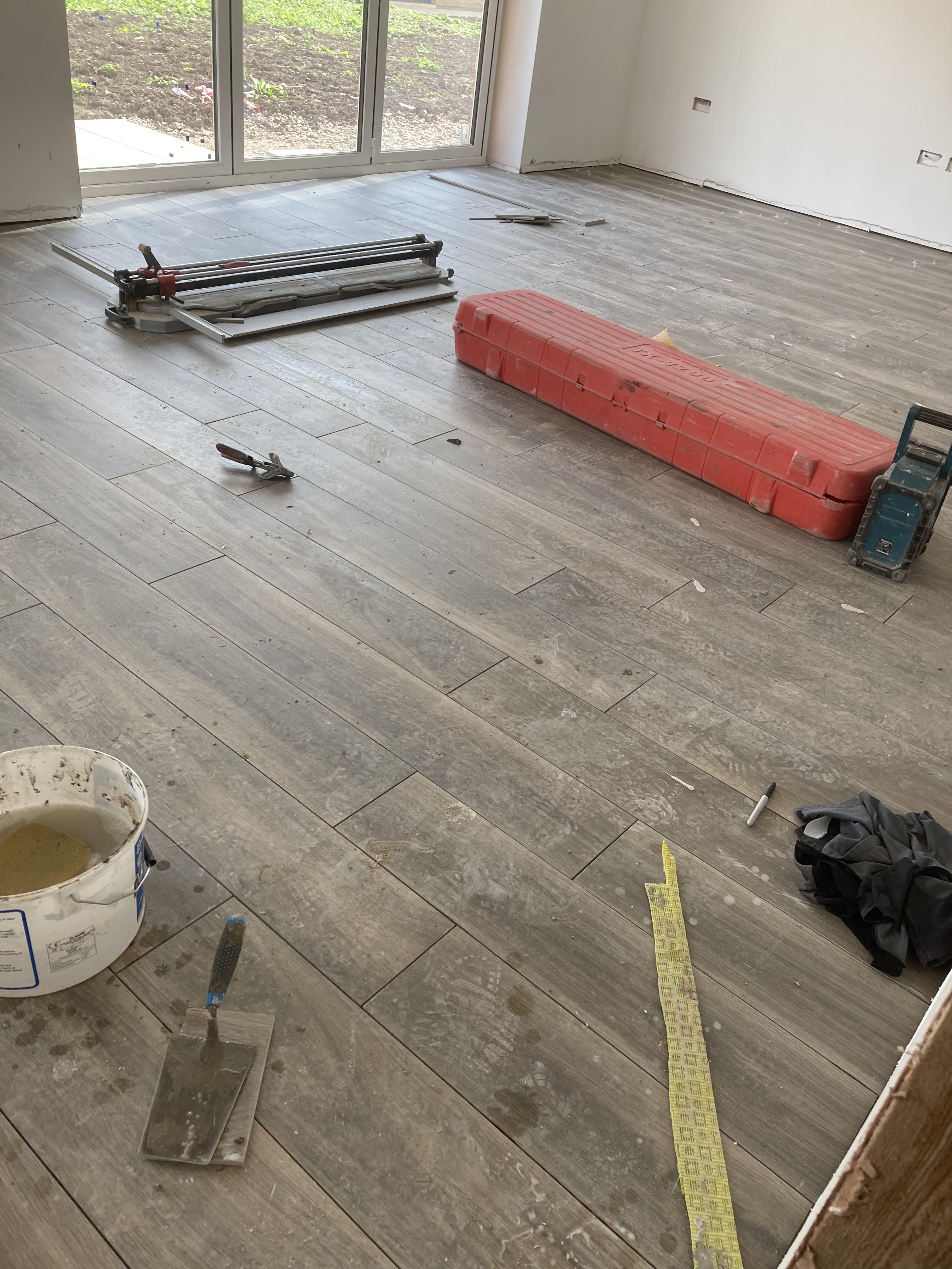

Onoff Posted December 19, 2021 Share Posted December 19, 2021 100mm slab. Feb 2016: Then the wet room corner April 2018: Tiled the corner Aug 2018: I think it's the Irish who wonder what the English do with the time they save by rushing. I'm part Irish... Link to comment Share on other sites More sharing options...
