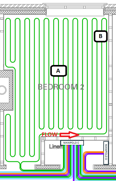

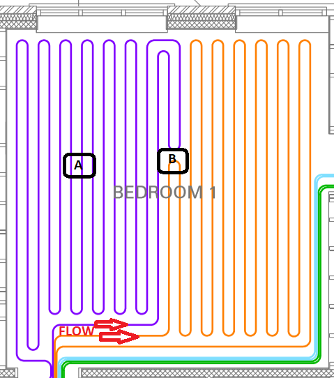

I've been getting my bits from WUNDA and wondered ( ? ) if their floor probes (aka Thermostat sensor) are any good? Being something that gets cast into the screed I can't change my mind later.
Also, in terms of placement within the room. Should they be placed near the start of a floors circuit (B) or mid circuit (A)? Near the start makes sense to me as the purpose of the sensor is to protect floor finishes and so the hottest point needs to be detected, but I may be missing something.
Finally, I also assume that the Thermostats can only take one temperature sensor input.

you don't cast them in, you cast in a short length of pipe with a closed end (or similar) and feed the prove into this thermopocket.
Cool, that allows fixing them if they break which is good. Can you recommend a type of pipe to use?

just a bit of your UFH pipe crimped flat at the end will do

I'll have to avoid crossing  over like you have as I don't have the mesh, but where I have serpentine pattern I can just go between two loops.
I see you have put your sensor at the hottest point (B from my original post)
