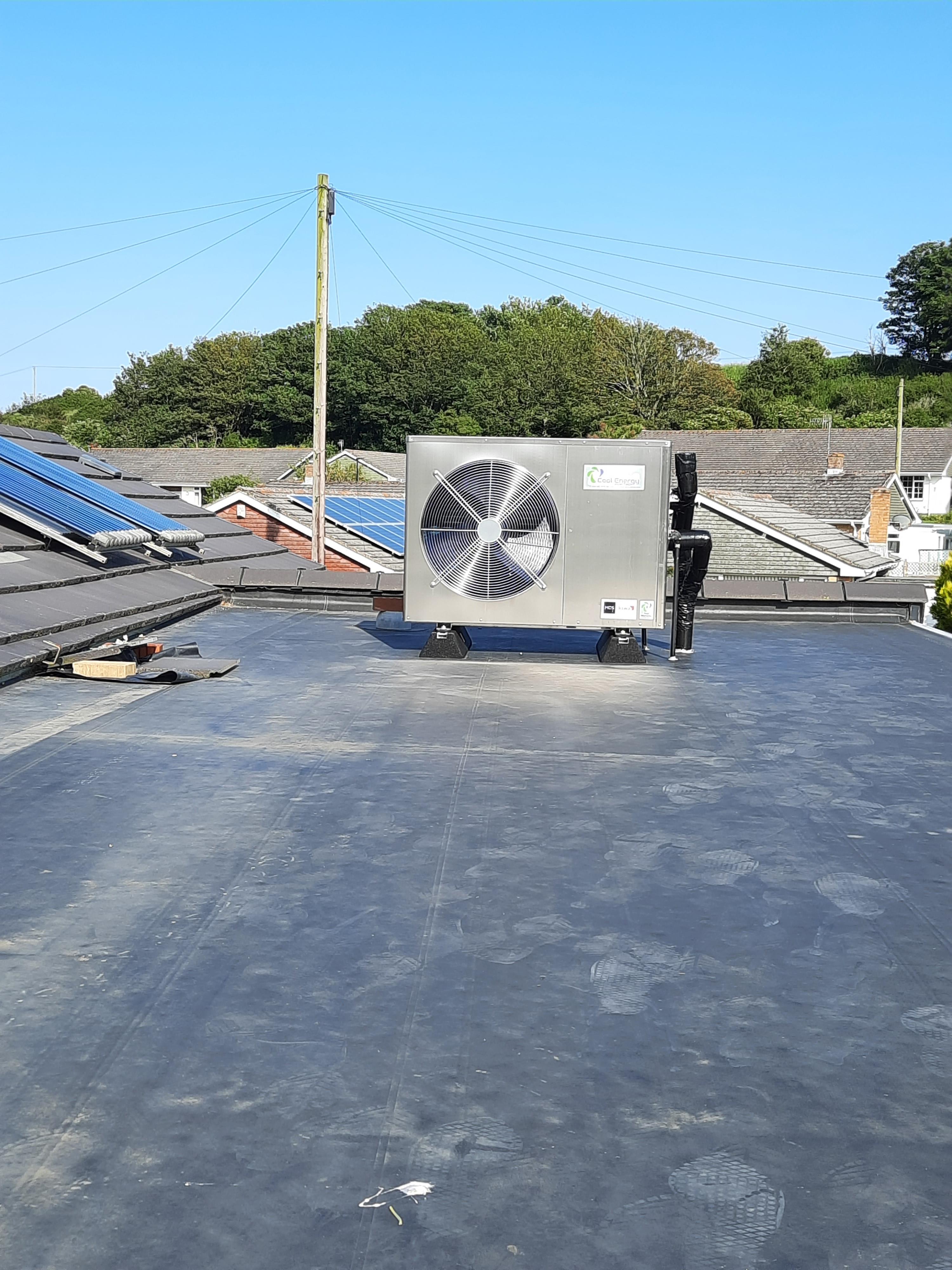

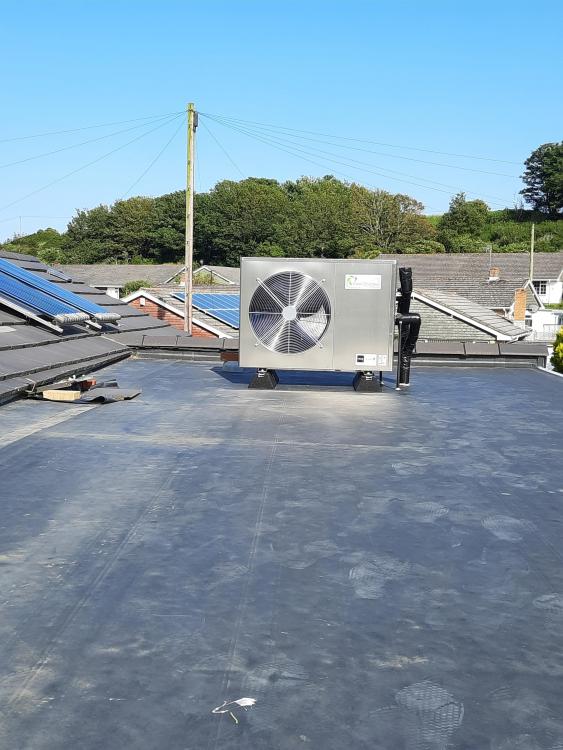

Marvin Posted August 22, 2021 Posted August 22, 2021 I have a Coolenergy CE -iVT9 installed. This is the first few months. We removed the bottled gas boiler and installed the ASHP on the radiator system. I do not know what the results will be but so far so good. It runs quietly and the controls are not too difficult for us to use.
