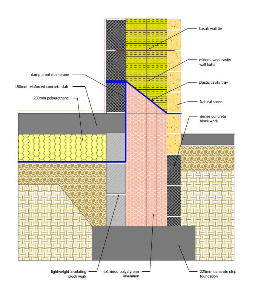

Mr Punter Posted July 18, 2021 Posted July 18, 2021 5 hours ago, bgmill said: My question is: what's a real-world u-value we could expect to achieve going this route? and, what could/should we specify to improve things? You will need to do some maths here to find the sweet spot between internal area, cost of footings, cost of wall ties and cost of insulation. A 150mm cavity gets a passable u value with platinum blown beads. Use thermally broken cills and lintels. Use Marmox or Foamglas course at the base of the internal blockwork.
joe90 Posted July 18, 2021 Posted July 18, 2021 1 minute ago, Mr Punter said: Use Marmox or Foamglas course at the base of the internal blockwork. Or do the founds like I did….. 1
Mr Punter Posted July 18, 2021 Posted July 18, 2021 1 minute ago, joe90 said: Or do the founds like I did….. Were those basalt wall ties expensive?
tonyshouse Posted July 18, 2021 Posted July 18, 2021 Yes, but in the great scheme of things it pales into insignificance

joe90 Posted July 18, 2021 Posted July 18, 2021 1 hour ago, Mr Punter said: Were those basalt wall ties expensive? I didn’t use them, losses through ordinary ties are minimal.
