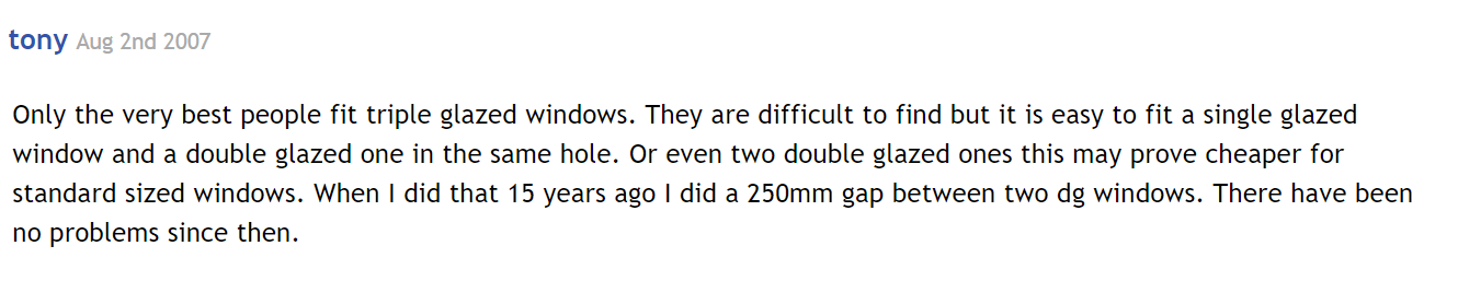

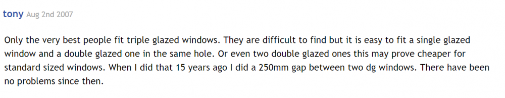

Ferdinand Posted July 11, 2021 Share Posted July 11, 2021 Nice to see Tony being (I think) consistent over 15 years, and how it has changed. You get to be one of the Best People. (That thread is worth a read btw for how they used to be thought about.) ? F http://www.greenbuildingforum.co.uk/newforum/comments.php?DiscussionID=527&page=1 Link to comment Share on other sites More sharing options...
