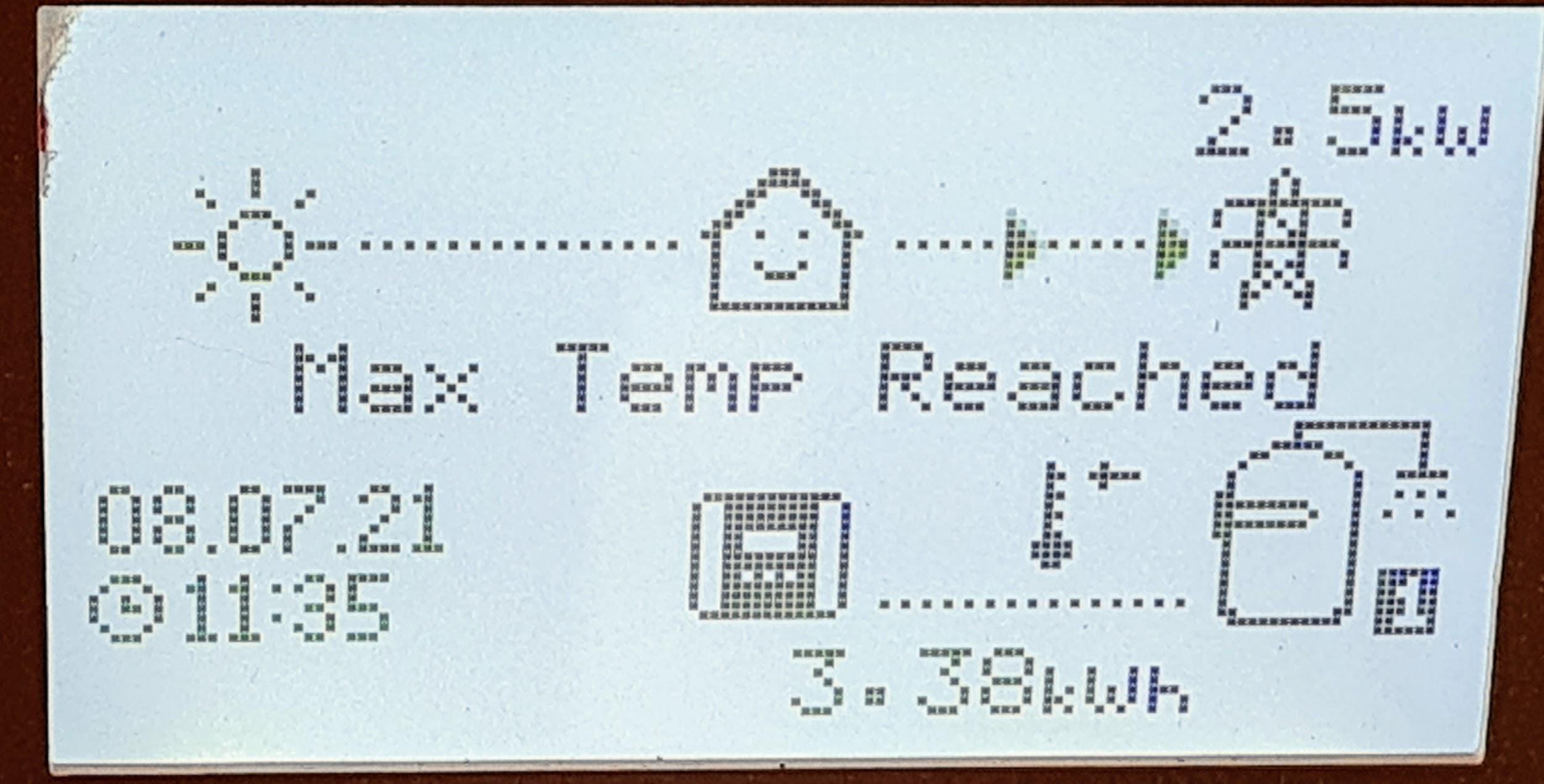

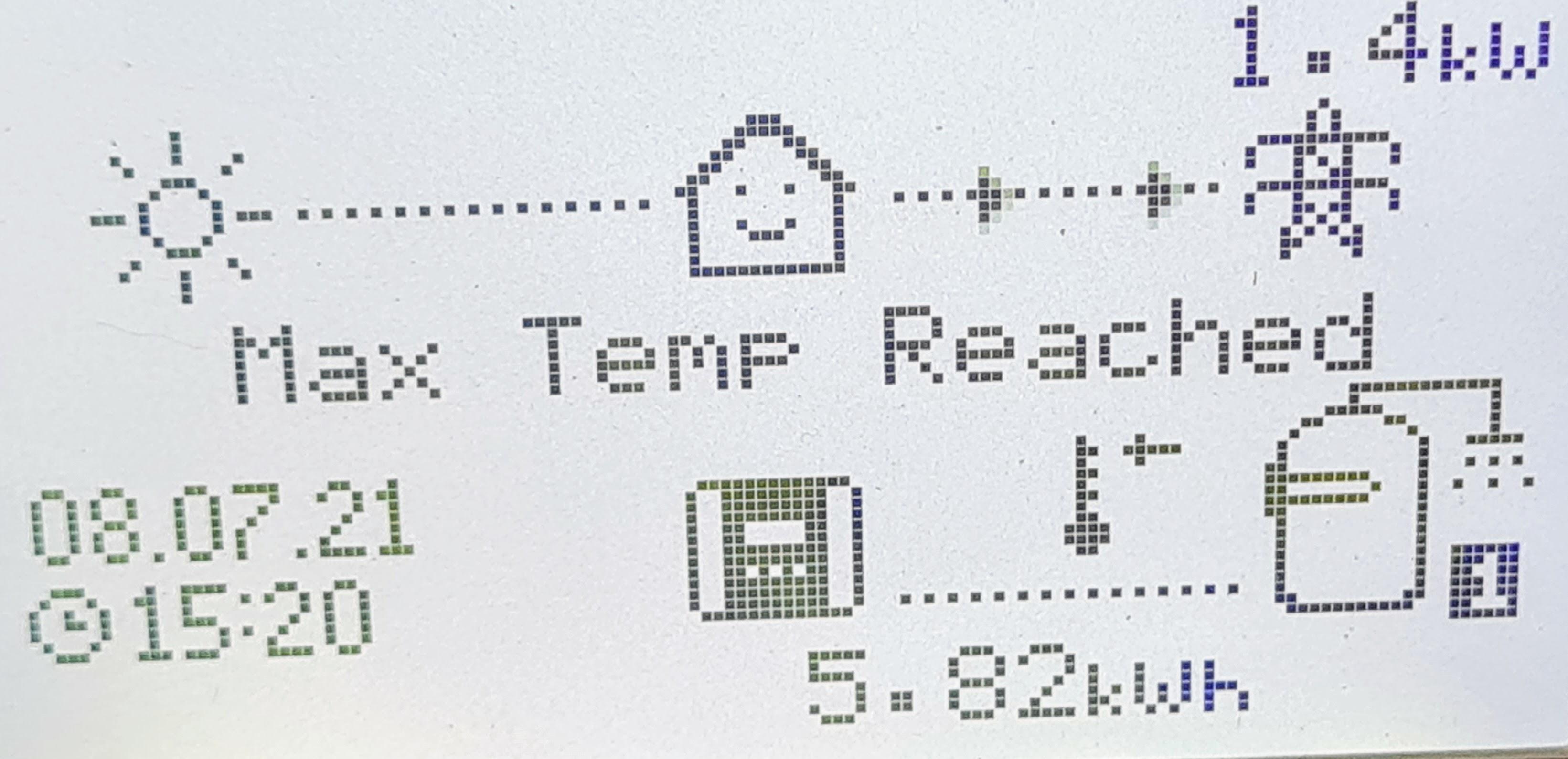

ToughButterCup Posted July 8, 2021 Posted July 8, 2021 (edited) Owning a SunAmp , for me, is a bit like a Guess-The-Weight-Of-The-Baby competition. You've had a rubble of your own babies, looked after God knows how many other ones, so you've got a good 'feel' for how much the little tike weighs. Oooops, a bit less now - sick down the back of your shirt. You know the routine. Same routine with a SunAmp: it makes you guess how much (be gentle @SteamyTea) energy (?) is left in the bloody thing after SWMBO has had one of her bath-of-the-century incidents, and the daughter has run the shower for gaud knows how long.... ( ask @ProDave, he knows the score ?) Mine's (SunAmp) a 13.7 kW machine. And up to today, I've assumed that the average bath gets rid of about 5kW, and a shower 3kW. Roughly. But today I thought I'd try a bit of slewthing. When the SunAmp's full, you see this on the Eddi thingy that shunts energy to the SunAmp From this image I can see that its taken 3.38 kWh to heat the PCM from what it was to 'Full' ( hmmmm waasat mean?) Quick sprint to the shower, play with my ducks and have rub down with the Sports News. A bit later that day (today) - no other hot water used Another 2 and a half kWh or more have been sucked into the SunAmp. Does that mean the shower I took earlier today consumed 5.82 - 3.38 kWh's worth of energy? Or am I missing something? Put differently, is my assumption that one of our showers consumes about 3kWh's worth of energy per average shower correct? (We have a quite powerful HansGrohe 'rain' head) Edited July 8, 2021 by ToughButterCup
SteamyTea Posted July 8, 2021 Posted July 8, 2021 3 minutes ago, ToughButterCup said: Does that mean the shower I took earlier today consumed 5.82 - 3.38 kWh's worth of energy? Or am I missing something? Put differently, is my assumption that one of our showers consumes about 3kWh's worth of energy per average shower? (We have a quite powerful HansGrohe 'rain' head) Measure the flow rate, the output temperature on the hot pipe and the input temperature on the cold pipe. Then do the sums.
ProDave Posted July 8, 2021 Posted July 8, 2021 A typical "good" electric shower uses 10kW and a typical lady shower is at least 15 minutes so that's 2.5kWh. Yours will use more than that as with a decent rainfall head you are probably getting twice the flow rate than from an electric shower. I think the other issue, is the sunamp does not seem very good at determining itself when it is "full" and has a lot of hysteresis, so won't accept any more input until if thinks it has some spare capacity. To a lesser extent I see this with my ASHP and cylinder. The temperature probe is in the lowest pocket, about 1/3 from the bottom of the cylinder. So the ASHP does not even know you have used any hot water until you have used 1/3 of it. Or put it another way, my 300L tank might have only a little over 200L of hot water when the epic showering starts, and then you have the potential for a "ran out of water" situation.
ToughButterCup Posted July 8, 2021 Author Posted July 8, 2021 30 minutes ago, SteamyTea said: Measure the flow rate, the output temperature on the hot pipe and the input temperature on the cold pipe. Then do the sums. Ok. Can I ask you for a formula that I can apply to those numbers, please? I know that the HansGrohe is pre-set at 40 , and the input temp is about 18ish....... Flow rate is 18 litres a minute or thereabouts....
Dan F Posted July 8, 2021 Posted July 8, 2021 3 minutes ago, ToughButterCup said: Ok. Can I ask you for a formula that I can apply to those numbers, please? I know that the HansGrohe is pre-set at 40 , and the input temp is about 18ish....... Flow rate is 18 litres a minute or thereabouts.... 0.46kWh/min I think. Which would mean your 2.4kWh shower earlier today was about 5.3 minutes? https://www.omnicalculator.com/physics/specific-heat?c=GBP&v=equation:0,c:4181.3!jkgk,substance:1543850775,m:18!kg,T:22!C
