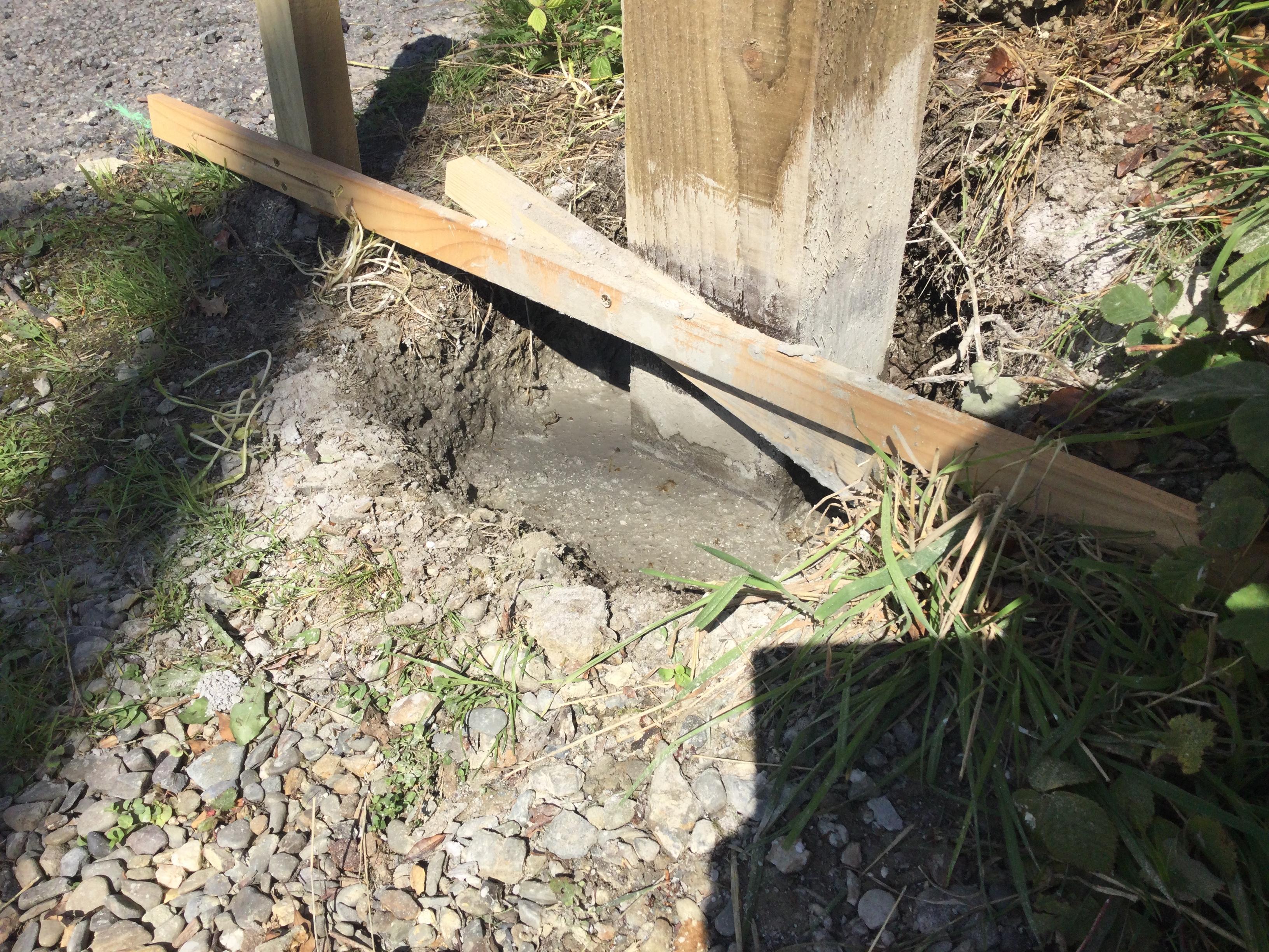

zoothorn Posted August 27, 2021 Author Share Posted August 27, 2021 (edited) Heres my current result.. i aimed to have another 2" of concrete in, so Im a bit shy at 29" depth. Nearly hard. Great. Should i do a mix of cement/ sand/ water ( mortar.. i think) to add on to here to get me up 2", round off the top a bit for rain drain away? I can pinch a bucket of hardcore from a pile ive seen (not telling you where) i could pick out the stones & just use the finer gravelly numnums for aggregate-? Edited August 27, 2021 by zoothorn Link to comment Share on other sites More sharing options...
joe90 Posted August 27, 2021 Share Posted August 27, 2021 6 hours ago, zoothorn said: to add on to here to get me up 2" Yes, posts rot at ground level mostly, so ramp the concrete up the post slightly so water will run away from the post. Link to comment Share on other sites More sharing options...
zoothorn Posted August 27, 2021 Author Share Posted August 27, 2021 50 minutes ago, joe90 said: Yes, posts rot at ground level mostly, so ramp the concrete up the post slightly so water will run away from the post. Understood John, had this in mind.. but Im still not sure, Im sorry to say, what concrete is after using the postcrete stuff. IE. I have cement & sand. Can I make some form of concrete, from these, adding something/ or not needing to add anything at all? Its a ridiculously naiive q I realise, but Im just not on board now after my postcrete mini fiasco. Link to comment Share on other sites More sharing options...
Ferdinand Posted August 27, 2021 Share Posted August 27, 2021 8 hours ago, zoothorn said: Heres my current result.. i aimed to have another 2" of concrete in, so Im a bit shy at 29" depth. Nearly hard. Great. Should i do a mix of cement/ sand/ water ( mortar.. i think) to add on to here to get me up 2", round off the top a bit for rain drain away? I can pinch a bucket of hardcore from a pile ive seen (not telling you where) i could pick out the stones & just use the finer gravelly numnums for aggregate-? I would top that up when you put the other one in next week, if still to do. Link to comment Share on other sites More sharing options...
Onoff Posted August 27, 2021 Share Posted August 27, 2021 A useful, generic "concrete" is nominally 3:2:1 - 3 of sharp (aka coarse) sand, 2 of aggregate that is "stones" up to 20mm and 1 of cement. Alternatively you can mix cement and "all in one" ballast which is a mix of aggregate and sharp sand. Never use builders sand for concrete. Builders sand is for bricklaying mortar and render. Link to comment Share on other sites More sharing options...

joe90 Posted August 28, 2021 Share Posted August 28, 2021 (edited) 12 hours ago, zoothorn said: Understood John, had this in mind.. but Im still not sure, Im sorry to say, what concrete is after using the postcrete stuff. IE. I have cement & sand. Can I make some form of concrete, from these, adding something/ or not needing to add anything at all? Its a ridiculously naiive q I realise, but Im just not on board now after my postcrete mini fiasco. yes I understand, it’s an anomaly, as said above concrete should contain aggregate and postcrete appears not to. Treat “postcrete” as a Trade name, not a “substance”. As you say postcrete can be expensive but it’s very convenient, I see no problem in banking this post up with ordinary “Mortar” if you have the sand and cement hanging about ?. try reading this…….https://www.withamtimber.co.uk/blog/postcrete-vs-concrete (I think postcrete uses fast setting cement) Edited August 28, 2021 by joe90 Link to comment Share on other sites More sharing options...

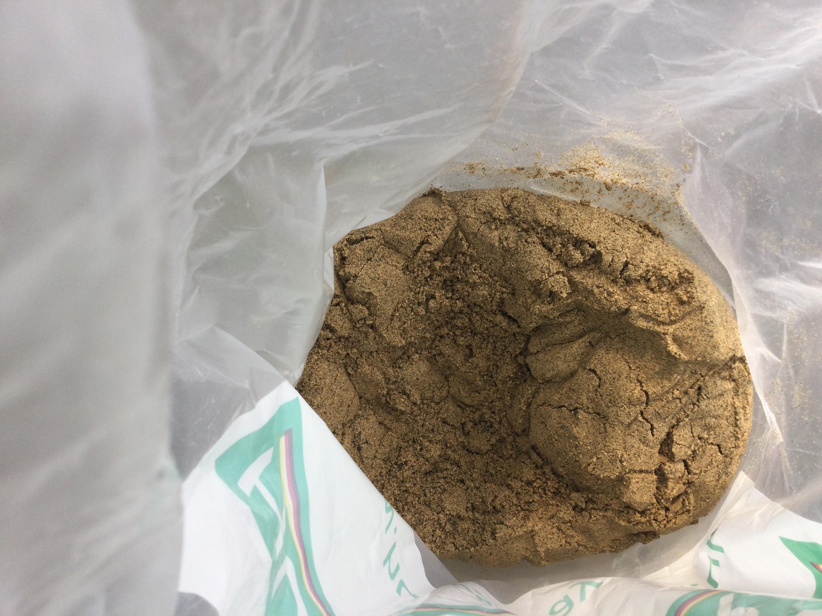

Onoff Posted August 28, 2021 Share Posted August 28, 2021 33 minutes ago, zoothorn said: Hi Onoff. Thats nice & simple.. but havent i just got " builders sand", having asked for sand at a builders yard & given 3 bags? (I mean how could this not be builders sand-?) Maybe it is called this, & Ive used the wtong sand all along for my porch render mortar job then. Its just slightly damp, light brown sand.. if that dan help distinguish it. Im tryingto recall the sand big bag i was shovelling from, for my mixer/ concrete cabin pads. I cant recall it being different to my porch job sand. Tbh Im still just as confused. Post a picture of the bag the sand came in is easiest sling with a good pic of a handful of the sand. Trying to render with a pure sharp sand mix is a bitch. Link to comment Share on other sites More sharing options...

zoothorn Posted August 28, 2021 Author Share Posted August 28, 2021 2 hours ago, Onoff said: Post a picture of the bag the sand came in is easiest sling with a good pic of a handful of the sand. Trying to render with a pure sharp sand mix is a bitch. Nothing on bag you see, & muggins just asked for " 4 bags of sand please mister " with my 1 cement bag. Link to comment Share on other sites More sharing options...

markc Posted August 28, 2021 Share Posted August 28, 2021 20 minutes ago, zoothorn said: Interesting that. Thank god the buggers didnt get over here then. Can you ID my sand Onoff? Are you sure it’s sand? Looks more like Demarera sugar. looks too course for ordinary (red) mortar sand, maybe a local sharp sand so should be perfect for concrete or screed 1 1 Link to comment Share on other sites More sharing options...
