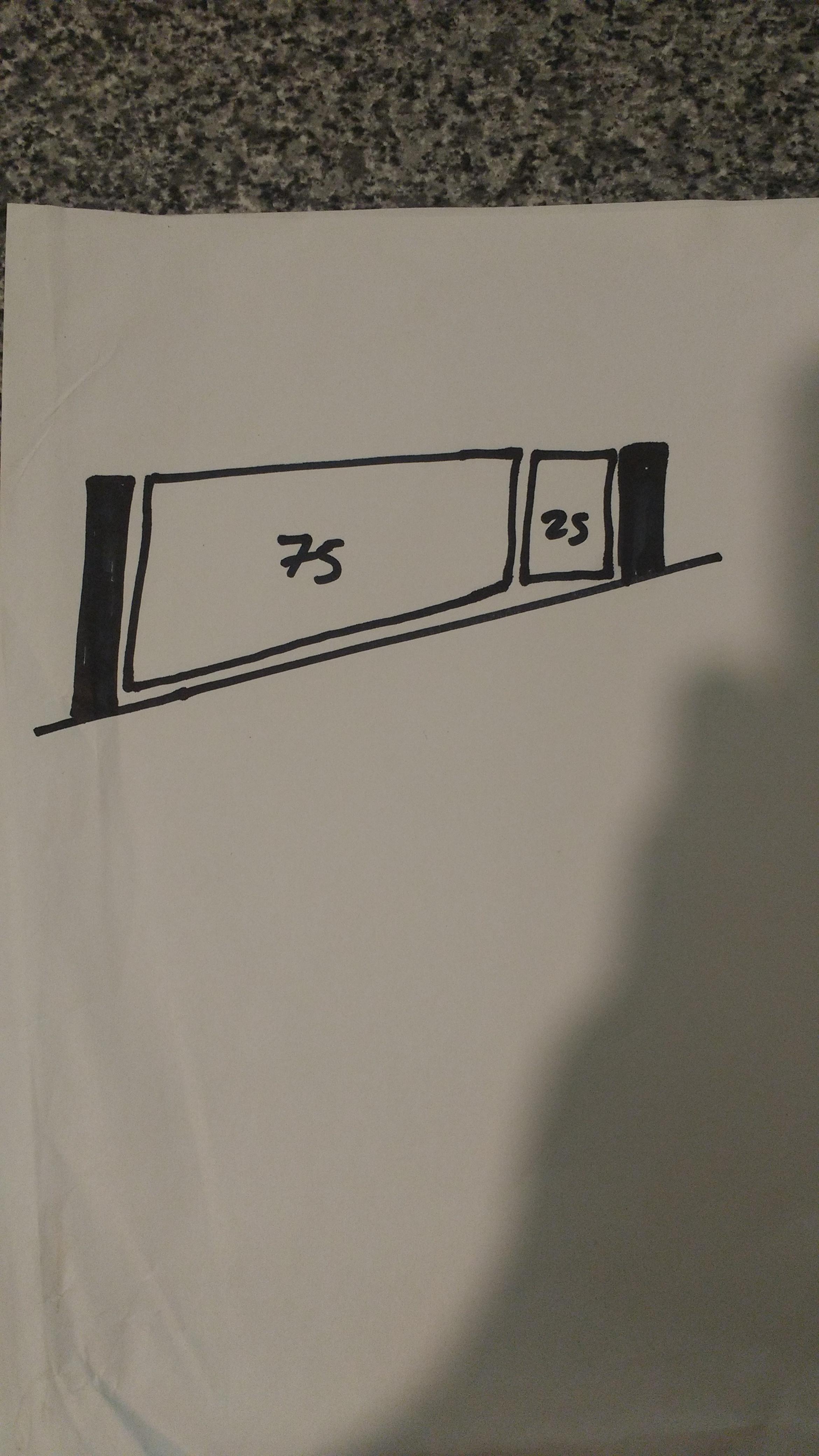

joe90 Posted July 16, 2021 Posted July 16, 2021 (edited) C,mon @zoothorn you know you can, think of the stuff you have done before eh?. And felt proud. 1/ do you need to keep dogs out/in (therefore little gap underneath and fairly close boarded) 2/ you need to measure how slopey it is (using a spirit level giving difference in height across the gate entrance, gatepost to gate post) 3/ you need to measure the slope under the gates when they are open (same using spirit level and measuring height differences.) get this down on paper, CAD would be good (crayon assisted drawing ?) and post here then we will all come up with different solutions for you ? Edited July 16, 2021 by joe90

zoothorn Posted July 18, 2021 Author Posted July 18, 2021 On 16/07/2021 at 14:02, markc said: Honestly, forget about the different slopes and geometry. Standard gates are cheaper etc. but if you want bespoke gates to fit the hole, be that 50/50 75/25 60/40 etc. then it really makes no difference to lining them up. Measure and draw out the shape of the opening to work with the sloping floor. Split the gates where you want to split to be. Have the gates made to this design. Get the gates and offer them upto the slope with required gap underneath, measure amount the hinges need to rise, get hinges made to this rise. Ive done hundreds of them in the past. Hi markc. But how can I forget about the slope l to r? If I put a pair of standard gates in, I'll have a 1 ft gap below the lhs gate. And half a foot gap at the join. I cant see this as being correct. If one purpose of the gates is preventing cats strolling on.. I need them to be fairly decently placed relative to the ground. I mean a 4" gap perhaps. Is this just not possible then? Until I can get my head around this lateral slope, I can't think how a pair of standard gates can be used. Unless their shape is retrofitted, or something. I dont know. All the advice is relating to the slope running towards the gates, rather than perpendicular/ laterally, across the gates. I can understand the funny hinges negate a slope running towards the gates, (fairly simple to understand: & my slope this way isn't perhaps needing such hinges being fairly shallow, certainly not needied at all on the lhs gate post, if this gate is hanging a full 1 ft off the ground). But the lateral slope.. seems to be much more of a problem. thanks zh
Onoff Posted July 18, 2021 Posted July 18, 2021 9 minutes ago, zoothorn said: If one purpose of the gates is preventing cats strolling on.. I need them to be fairly decently placed relative to the ground. I mean a 4" gap perhaps. Erm...cats climb! ? An electric fence is about the only thing that'll stop them. Maybe have the pedestrian gate "normal" and the main gain bottom following the slope and on rising hinges?
markc Posted July 18, 2021 Posted July 18, 2021 @zoothorn, good morning. I agree if you want to fill a weird shaped hole then standard gates would not fill the gap completely, I was referring to bespoke gates to fit the hole. You can use standard gates by adding a fixed or hinged (upwards) triangular infill panel at the bottom to fill the open part. the shape of the gate makes no difference to the rising hinge system.

Onoff Posted July 18, 2021 Posted July 18, 2021 It's quite common to have a standard gate with a shaped bottom panel, often mesh of some sort. Mainly to stop pets escaping. I reckon you could figure a mechanism to lift / hinge the infill panel out of the way as the gate opens...

zoothorn Posted July 18, 2021 Author Posted July 18, 2021 (edited) 52 minutes ago, Onoff said: Erm...cats climb! ? An electric fence is about the only thing that'll stop them. Maybe have the pedestrian gate "normal" and the main gain bottom following the slope and on rising hinges? Hi Onoff..thanks, this is what I was sort of visualising ( but lhs gate the smaller one). So does this shape mean a bespoke made-for gate though? Or a standard one modified? i have no idea. I think maybe start by getting the two posts in, & consider from then on, or I will never figure out a plan beforehand. ( no, the gates will not stop a cat.. but might prevent it, even if half the time; & gates will not stop someone opening them, roaming onto my property & putting things on/ removing things either.. but might prevent this too/ a deterrance of some form in both cases: you wouldn't say though "well theres no point putting up gates then", there'd still be reason to put them in). Edited July 18, 2021 by zoothorn
markc Posted July 18, 2021 Posted July 18, 2021 Unless your post position is fixed then get the gates first and put posts in to suit. Much easier than finding gates to fit the space needed. you can modify a standard gate by adding apiece to the bottom
zoothorn Posted July 18, 2021 Author Posted July 18, 2021 2 hours ago, markc said: Unless your post position is fixed then get the gates first and put posts in to suit. Much easier than finding gates to fit the space needed. you can modify a standard gate by adding apiece to the bottom Hi markc.. that makes alot of sense to me. Good thats a starting point. But with the limited choice out here, delivery etc, Ill be fluking it if I find a 75/ 25 or any combination the correct size tho, will g9 see what's available 1 st up then.

zoothorn Posted July 19, 2021 Author Posted July 19, 2021 2 hours ago, joe90 said: https://www.moleonline.com/farming/timber-fencing?p=3 See if they have one near you!! Hi there joe.. thanks but you wouldn't believe the limited no. of shops we have out here, there wouldn't be one for 100 miles. No unfortunately I have only 1 place/ option here for timber gates, as they'll need to be delivered. Farm place. Ok just been/ they have 6ft gates.. & two will fit perfectly in fact. I think I'll just have to simplify this job by getting these, & hanging straight/ via normal hinges & put up with (or rejig the gates low side) the gap below, or over time maybe fettle the driveway flatter. The tilting hinges.. I just don't like Ive decided: they look too weirdto me. And if one is set 1 ft high anyway due to the lateral slope, then this one doesnt warrant odd hinges anyway. One gate rising weirdly, the other normal? Hmm.. I don't think so.
zoothorn Posted July 20, 2021 Author Posted July 20, 2021 Front view. Between markers = 12 ft. So, Id lose 1 ft if I went 8 ft / 3 ft pair, (although I liked the " 25%" small gate idea like PeterW suggested). As I have to back-in, already often seems a bit tight between my two bushes for some reason on occasions.. constricting to 11 ft would cause problems. So I have no choice than go 6 ft / 6 ft I think. But do I have enough room to put my posts in I wonder?
markc Posted July 20, 2021 Posted July 20, 2021 If gates will only open one way then you can mount hinges on the inside or outside face to save space. If gates will swing either way then allow approx. 3 inches space between gate and post for the hinge
