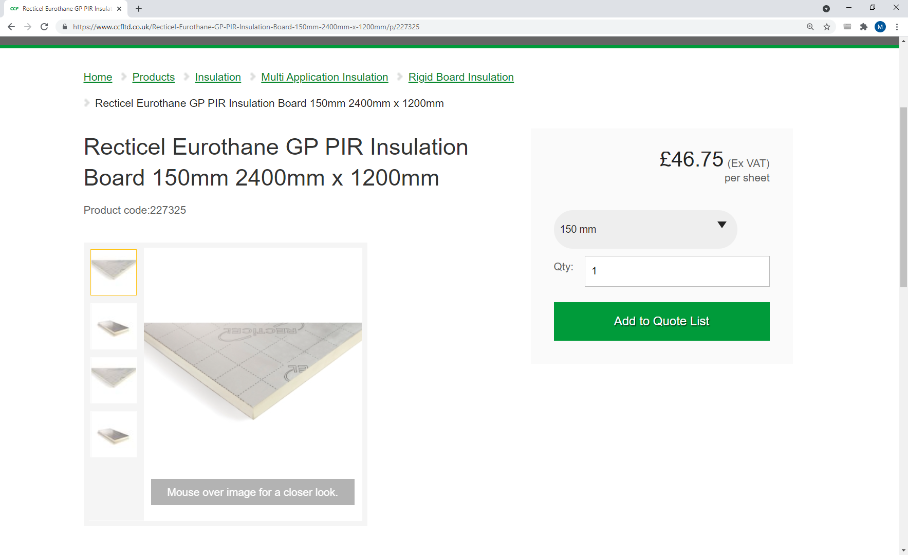

Moonshine Posted July 7, 2021 Share Posted July 7, 2021 I am about to order the PIR for my floors, after the tears that its 40% more than my original costing i am just figuring out the best build up. Its a total thickness is 150mm which i can get 2.4 x 1.2m sheets of 150mm for £47 ex VAT (recticel Eurothane GP), but figure it will be easier to cut and stagger joints if i do 100mm and 50mm, which would be £48 ex VAT for 2.4 x 1.2m sheets or 100mm and 50mm. Thoughts? Link to comment Share on other sites More sharing options...

Declan52 Posted July 7, 2021 Share Posted July 7, 2021 Put the 50mm down first as it's easier to cut round any pipework that's on the subfloor going to sinks etc. 1 Link to comment Share on other sites More sharing options...
Russell griffiths Posted July 7, 2021 Share Posted July 7, 2021 Do not buy the 150 it’s horrible to cut. Link to comment Share on other sites More sharing options...
dnb Posted July 7, 2021 Share Posted July 7, 2021 Agreed that the 150mm is hard to cut. I ended up making an extremely large (and possibly lethal) table saw to get the cuts straight and vertical. 1 Link to comment Share on other sites More sharing options...

Moonshine Posted July 7, 2021 Author Share Posted July 7, 2021 23 minutes ago, crispy_wafer said: May I ask where you are getting the 150mm from at that price please? CCF, though after phoning them, it appears that the local branch can't get the recticel and they can only off the more expensive celotex 1 Link to comment Share on other sites More sharing options...
