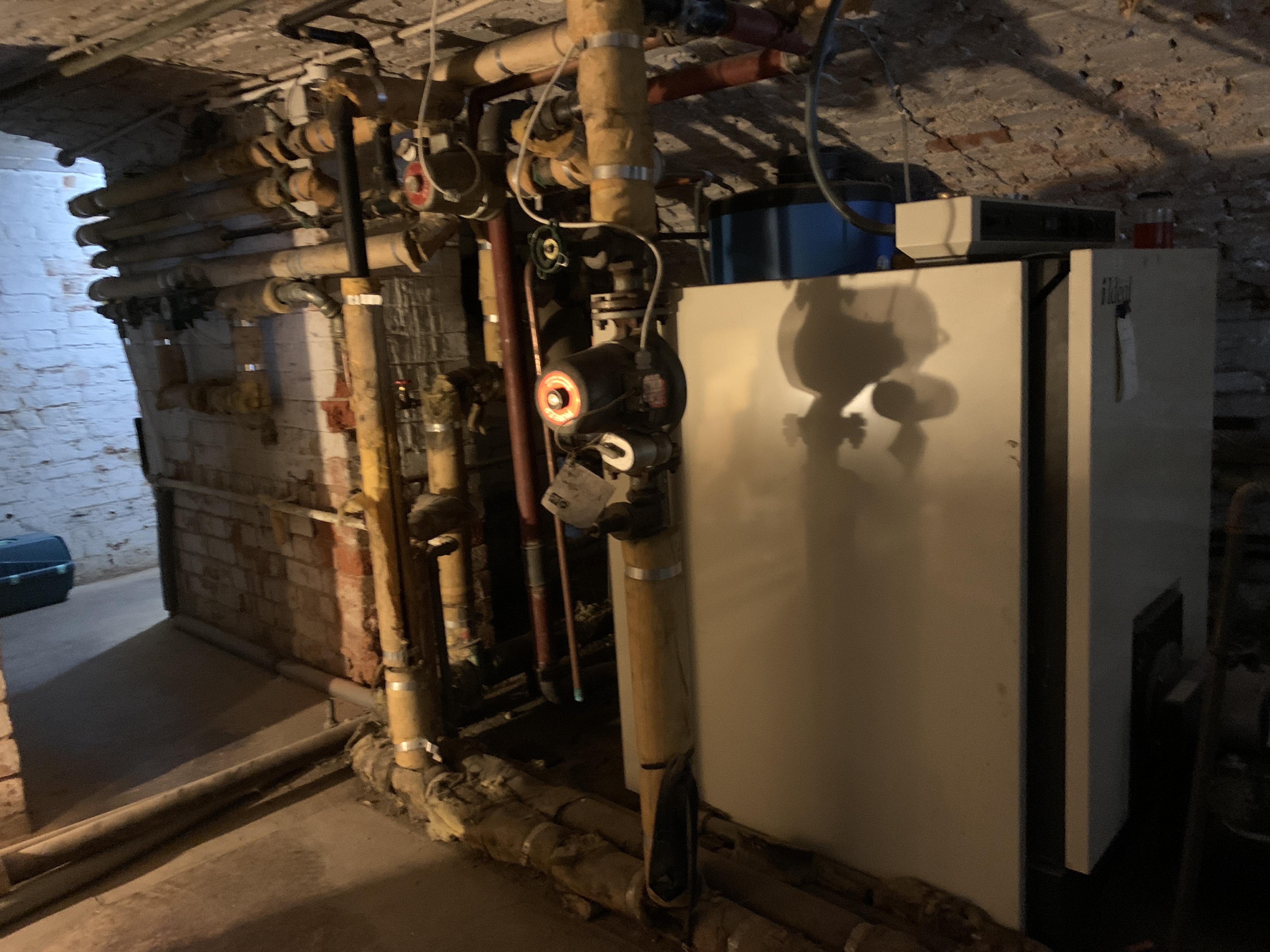

Dazza Posted June 28, 2021 Share Posted June 28, 2021 Hi looking for some advice on a replacement boiler. Bit of background - we have a big old farmhouse that I am slowly refurbishing. Current boiler is an oil fired boiler situated in our basement it is massive and drinks oil -see pic! looks to me more like a hospital basement than a house basement! So obviously want to replace and have decided we need to do this sooner rather than later. We have decided to go down the gas route rather than oil and have had a new in ground gas cylinder installed - we have also had a new 32mm water mains installed. so thinking about the upgrade, there are some things I need to look at: 1. Boiler has to service the home for heating & HW (rads and place not super insulated!) - Kitchen/utility/4 beds with ensuites (showers only)/sitting room/downstairs cloakroom - around 200m2 overall over 3 floors. 2. There is a myriad of existing pipework for rads - some of it galvanised. Here is where I need help! 1. Ideally, I would like a combi boiler to be man enough to supply all heating and HW, which I am sure is easily doable, but my question is, do I need a HW storage tank as if all 4 showers running at once think will run out of flow? Any good advise on what sort of system I should be looking at would be greatly appreciated. Also just to add, for HW, there will be some longish runs from gnd floor to 2nd floor if that makes any difference. 2. I want to get this connected up and running as soon as possible as I dont want to buy any more oil for the existing guzzler!! I know ideally I should replace all pipework to new and I will over time, but that is going to take a lot of work. I was hoping to be able to T into the existing HW and CH pipes and disconnect at the existing boiler. My concern with this is there will for sure be a lot of sludge in the CH pipes form the galv pipe and I dont want to damage a shiny new boiler by connecting up to these pipes. What is the advise here please - will it be OK? Should I get a power flush first? Or should I not do this at all - period? I am hoping to be able to do this some way as ripping all the existing pipework out will be a nightmare (there are so many pipes and I think some have been replaced over time and old ones left in situ - so my preference is to tackle it one room at a time as I am renovating the property). Hopefully I will get some good advise as I am scratching my head a bit - not to mntion suffering from paying so much out for oil for the old beast of a boilerl!! Link to comment Share on other sites More sharing options...

dpmiller Posted June 28, 2021 Share Posted June 28, 2021 Not liking the look of that insulation Link to comment Share on other sites More sharing options...
Dazza Posted June 28, 2021 Author Share Posted June 28, 2021 1 hour ago, SteamyTea said: What power rating is your current boiler? And do you know how much fuel it used every year? Does it keep the house warm, and enough hot water? A kWh of energy is agnostic to fuel types, just as power is. Current boiler is oversize for a domestic installation Im sure - I think it would heat a large industrial building!! Think it is 105-140kw according to rating plate (Harrier GTE 5) Link to comment Share on other sites More sharing options...
Dazza Posted June 28, 2021 Author Share Posted June 28, 2021 1 hour ago, dpmiller said: Not liking the look of that insulation Looks worse than it is - you are thinking asbestos? It is actually yellow rockwool insulation type stuff. Link to comment Share on other sites More sharing options...
PeterW Posted June 28, 2021 Share Posted June 28, 2021 That’s rigid rockwool as it’s used on process pipes and possibly here due to the size of the pipework..! So where is the current hot water tank and what size is it ..? A 32mm pipe will provide volume but at what pressure ..? Ideally you want 3 bar dynamic pressure but I wonder if you will get that. I don’t think tbh you will get a combi to do that flow regardless - at full chat you’re wanting 30-40 litres / min through showers and that’s not achievable with standard domestic combi boilers. You could do some type of domino setup but you’re complicating matters and LPG is not that cheap either when you’re burning lots of it. In terms of pipework, I would possibly leave well alone as it will be a decent thick wall black iron pipe - possibly galvanised. As close to the new boiler return as possible I would put a pair of magnaclean type units that can take the crud out - get the ones with the filters in, not just the magnets. A pair in parallel allows you to filter through one whilst you service the other and also picks up equal quantities of crud in each. Link to comment Share on other sites More sharing options...
Dazza Posted June 28, 2021 Author Share Posted June 28, 2021 2 minutes ago, PeterW said: That’s rigid rockwool as it’s used on process pipes and possibly here due to the size of the pipework..! So where is the current hot water tank and what size is it ..? A 32mm pipe will provide volume but at what pressure ..? Ideally you want 3 bar dynamic pressure but I wonder if you will get that. I don’t think tbh you will get a combi to do that flow regardless - at full chat you’re wanting 30-40 litres / min through showers and that’s not achievable with standard domestic combi boilers. You could do some type of domino setup but you’re complicating matters and LPG is not that cheap either when you’re burning lots of it. In terms of pipework, I would possibly leave well alone as it will be a decent thick wall black iron pipe - possibly galvanised. As close to the new boiler return as possible I would put a pair of magnaclean type units that can take the crud out - get the ones with the filters in, not just the magnets. A pair in parallel allows you to filter through one whilst you service the other and also picks up equal quantities of crud in each. Thanks for the reply. The current hot water tank is a vented 150l tank just behind and to the right of the boiler - although it leaks a bit and needs replacing. The current boiler is in a cellar, but the replacement cannot be in a cellar as it is gas, so new gas boiler will be on ground floor. I was hoping to get away with a combi because it makes installation so much simpler, but it seems that is not likely. If I have to have a HW tank it does add a lot more complexity as I was hoping to be able to effectively bypass all the current installation and allow me time to rip it all out, but if I had to add a new HW cylinder with new boiler I would probably need to instal it temporarily and then move it later - but if thats what I need to do, then so be it. Thanks for the advice on the maglclean thing - never heard of them - will look into it! At least that will save me some hassle up front and allow me the time to gradually replace the pipework as I work through the place! Link to comment Share on other sites More sharing options...

SteamyTea Posted June 28, 2021 Share Posted June 28, 2021 1 hour ago, Dazza said: Current boiler is oversize for a domestic installation Im sure - I think it would heat a large industrial building!! Think it is 105-140kw according to rating plate (Harrier GTE 5) Have you done a basic heat loss calculation on your place? 100 kW (not kw) is pretty big, but not ridiculous if you need a lot of hot water. Does it heat a cylinder up, what size it that? Link to comment Share on other sites More sharing options...

PeterW Posted June 28, 2021 Share Posted June 28, 2021 How close to the tank (vertically) can you get the boiler ..? Wall hung 45kW gas system boiler would keep a 400 litre horizontal UVC happy and give you plenty of water. Just re-route the supply pipes to the oil boiler connections and use the same bits. Any reason to remove the pipework etc ..? That circ pump is a beast and you’ll need to replace all of the pipework before that goes as a standard pump won’t cope with 1 1/4" steel pipework volumes. Link to comment Share on other sites More sharing options...

PeterW Posted June 29, 2021 Share Posted June 29, 2021 2 hours ago, Dazza said: There some even bigger pipework - some of the pipe work is about 4"!! So I guess for the heating, I would need to get all the bigger stuff out and bring it down to 15mm which might be achievable? You will probably be on a mix of 28/22/15 depending on the routing etc. 4” sounds odd, sure it’s not a support column ..??! Link to comment Share on other sites More sharing options...
