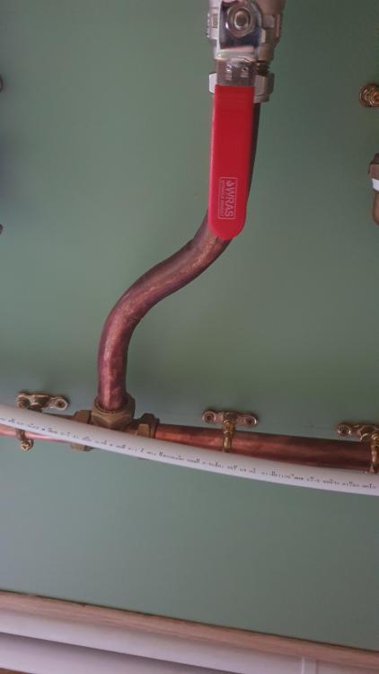

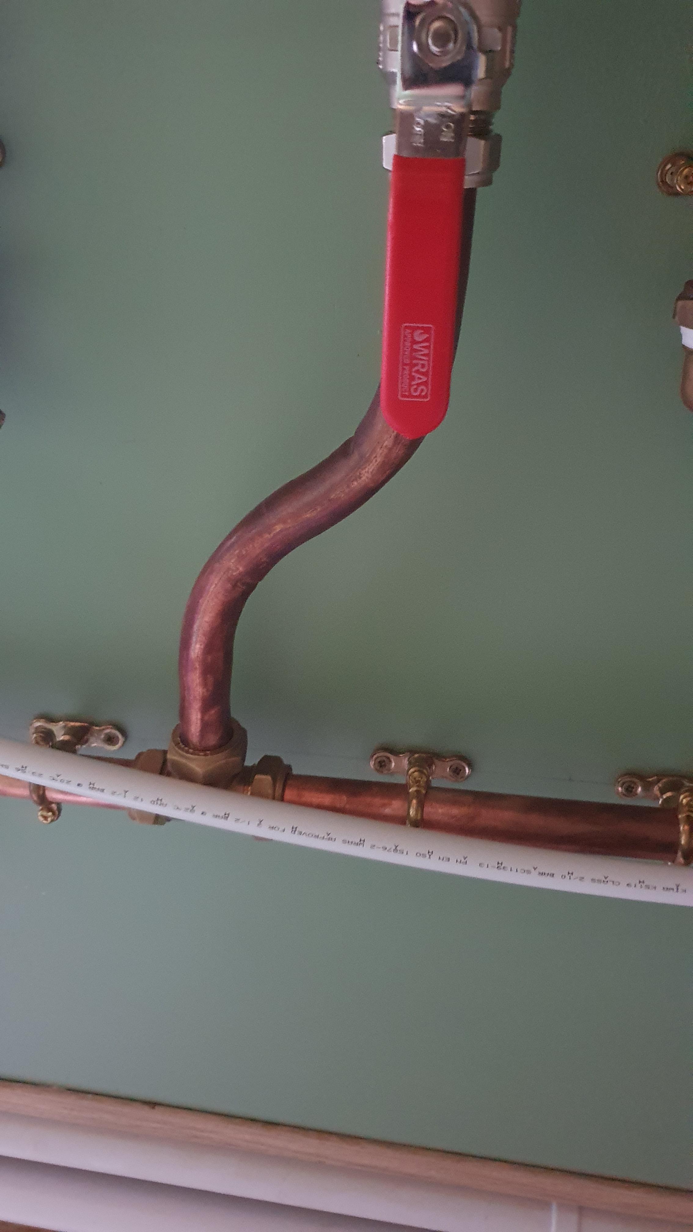

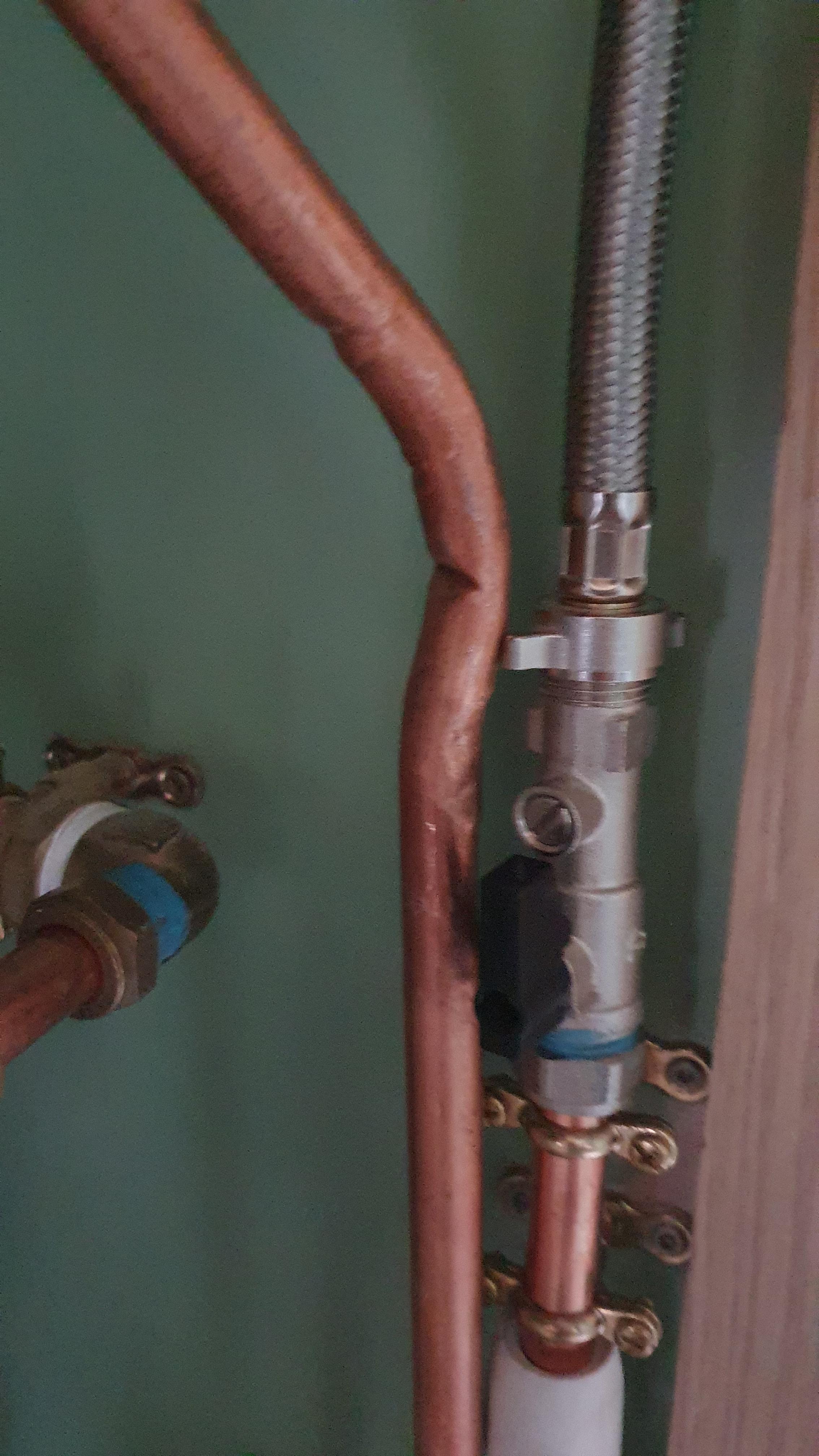

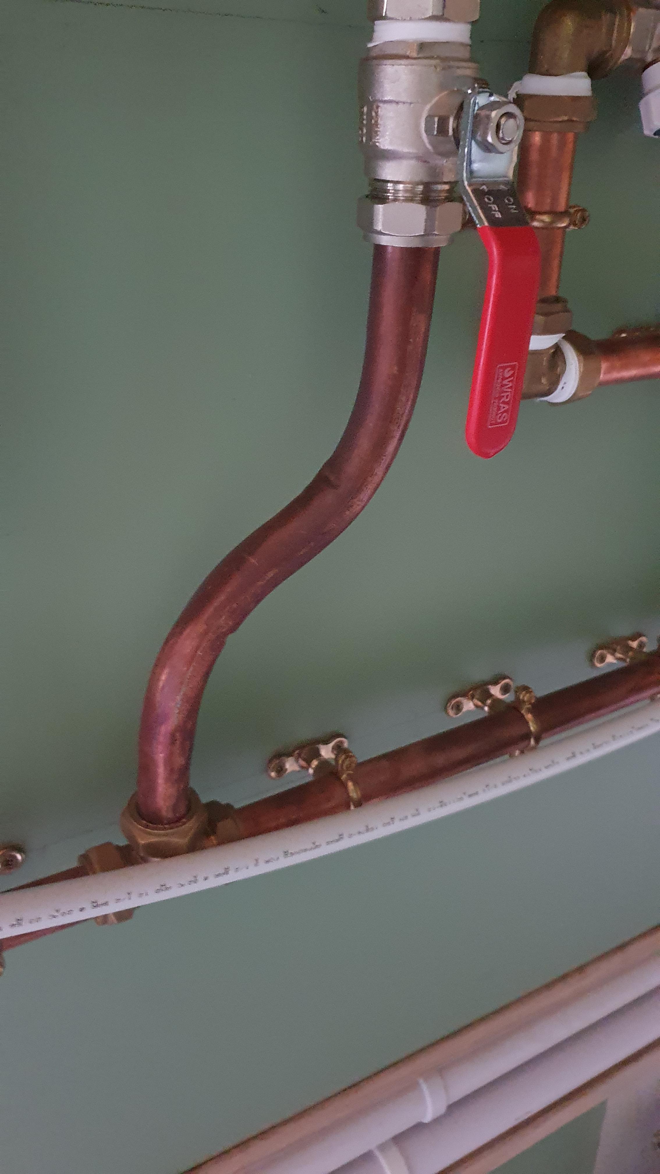

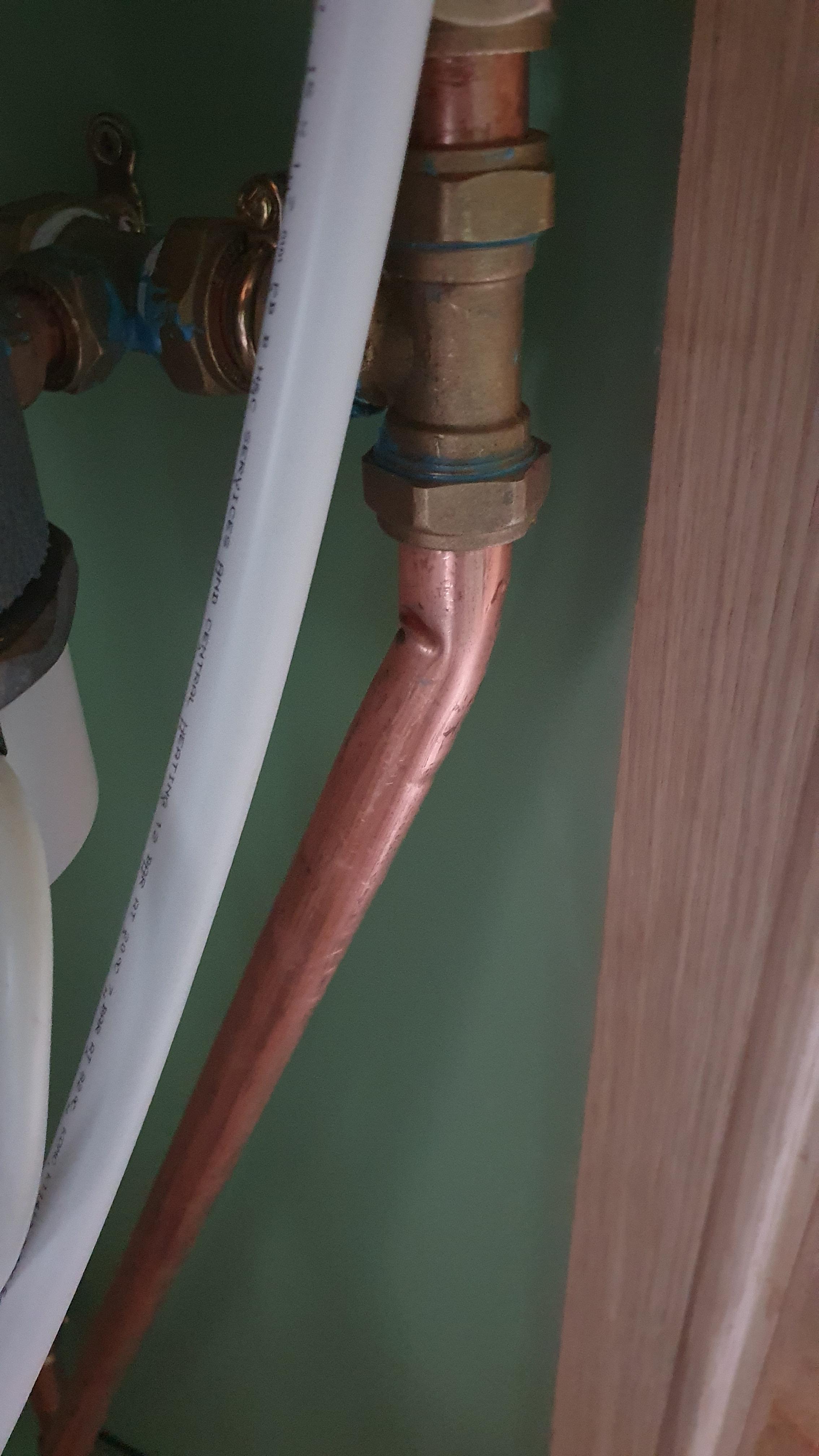

LA3222 Posted June 20, 2021 Share Posted June 20, 2021 (edited) Oh how I laughed at @pocster and his shotgun plasterboarding. Well, I will confess my sins - you ain't seen nothing until you have seen my pipe bending skills. I am open minded about taking on apprentices so if there are any budding padawans out there holla at me and I may share my secrets? (Caveat pre-emptor - thos is temporary just to jack up the UFH, it will be replaced?) Edited June 20, 2021 by LA3222 1 Link to comment Share on other sites More sharing options...
Onoff Posted June 20, 2021 Share Posted June 20, 2021 Bony knee job was it? ? Link to comment Share on other sites More sharing options...
ProDave Posted June 20, 2021 Share Posted June 20, 2021 You certainly don't have a Hilmor then do you? Link to comment Share on other sites More sharing options...
LA3222 Posted June 20, 2021 Author Share Posted June 20, 2021 12 minutes ago, Onoff said: Bony knee job was it? ? May aswell have been? I've got a pipe bender but didn't put much effort into learning how to get the bend to happen at the right place on the pipe - led to that mess. Actually watched a YouTube video last night - need to put my new found knowledge to use and see what happens, can't be any worse?♂️ Link to comment Share on other sites More sharing options...
LA3222 Posted June 20, 2021 Author Share Posted June 20, 2021 1 minute ago, ProDave said: You certainly don't have a Hilmor then do you? I got one of those irwin pipe benders - I still managed to butcher it? Link to comment Share on other sites More sharing options...
SteamyTea Posted June 20, 2021 Share Posted June 20, 2021 Get a flexible. Link to comment Share on other sites More sharing options...
dpmiller Posted June 20, 2021 Share Posted June 20, 2021 did you forget the fit the guide? Link to comment Share on other sites More sharing options...
LA3222 Posted June 20, 2021 Author Share Posted June 20, 2021 (edited) 8 minutes ago, dpmiller said: did you forget the fit the guide? ? guide was in. My problem was I knew where I wanted the bend to happen but didn't give too much thought as to how to work out it occurred where I wanted it. Lots of bending, straightening, bending and frustration then hey presto, I'm left with that abomination to the plumbing trade? Edited June 20, 2021 by LA3222 2 Link to comment Share on other sites More sharing options...
SuperJohnG Posted June 20, 2021 Share Posted June 20, 2021 That's a peach. Albeit the second one ain't bad. Few more test bends and it'll be fine. Link to comment Share on other sites More sharing options...
SteamyTea Posted June 20, 2021 Share Posted June 20, 2021 3 minutes ago, SuperJohnG said: Few more test bends and it'll be fine. Few more leaks and you can charge plumber's rates. Link to comment Share on other sites More sharing options...

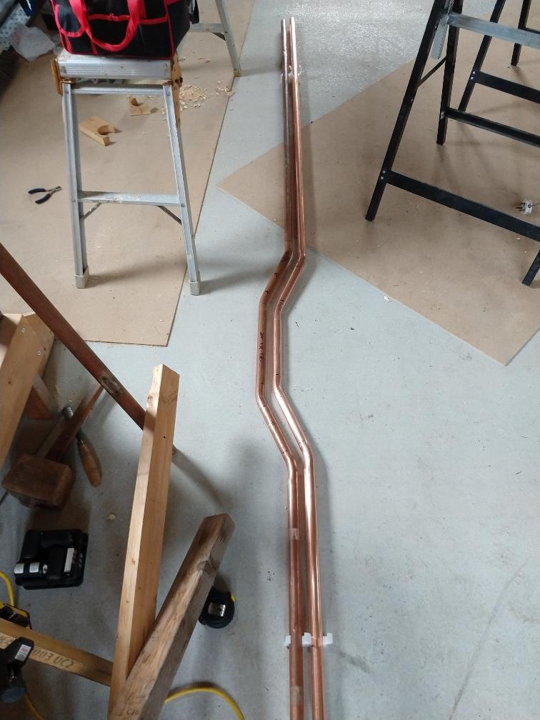

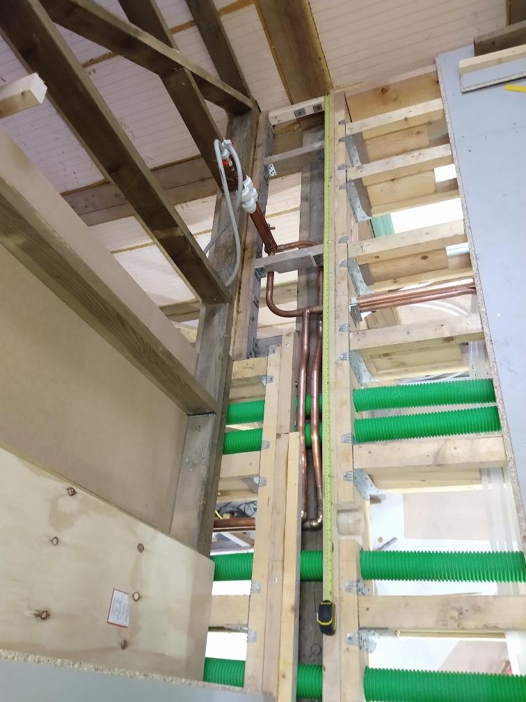

JFDIY Posted June 20, 2021 Share Posted June 20, 2021 I've never put much science into bending pipe, I wanted to bend some 28mm rather than have 8 solder joints per pipe, so I bought a hilmor and managed this, And a few more Link to comment Share on other sites More sharing options...
LA3222 Posted June 20, 2021 Author Share Posted June 20, 2021 13 minutes ago, JFDIY said: I've never put much science into bending pipe, I wanted to bend some 28mm rather than have 8 solder joints per pipe, so I bought a hilmor and managed this, And a few more Yup, confirms the niggling suspicion I had that maybe my bends were not quite up to standard? I see lots of lines on yours - markers to indicate where to bend etc? Yep, I definitely didn't do that. Decided to channel my inner Pocster and free wheel it, the good old Mk 1. eyeball was my weapon of choice when it came to measuring - the results are.exactly what you'd expect? Link to comment Share on other sites More sharing options...
JFDIY Posted June 20, 2021 Share Posted June 20, 2021 14 minutes ago, LA3222 said: I see lots of lines on yours - markers to indicate where to bend etc? Yes, kind of, typically the start point of the former, so I could put it back in and bend a bit more if needed Link to comment Share on other sites More sharing options...
JFDIY Posted June 20, 2021 Share Posted June 20, 2021 Why so many Munsen ring clamps? Be warned I used some of those on my UFH supply pipes (now in the insulation and under the screed) and forgot to put teflon tape around the copper pipe, really wish I'd not even used them and used plastic stauff clamps or similar because they creak every heat cycle. Back up plan is to cut them dead and run new pipes down the back of the stairs If I can't live with it.? Link to comment Share on other sites More sharing options...
LA3222 Posted June 20, 2021 Author Share Posted June 20, 2021 3 minutes ago, JFDIY said: Why so many Munsen ring clamps? Be warned I used some of those on my UFH supply pipes (now in the insulation and under the screed) and forgot to put teflon tape around the copper pipe, really wish I'd not even used them and used plastic stauff clamps or similar because they creak every heat cycle. Back up plan is to cut them dead and run new pipes down the back of the stairs If I can't live with it.? I may have gone OTT with munsen rings! The pipework you see is on the wall in the plantroom, I have run all my plumbing throughout the house in hep and clipped with plastic clips. The only copper in in the plant room. The manifolds are all in and OK. The butchered pipework you see was the temp stuff for the willis to get the UFH temporarily jacked up and to pressurise the entire system - be a while before I plan to get around to connecting the ASHP. Those dodgy bits will all come off once the ASHP is in and I add the softener in too. Was a case of haste and impatience - works, looks honking though!! Link to comment Share on other sites More sharing options...
