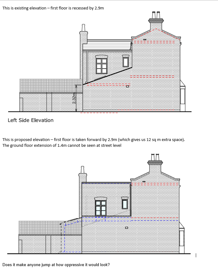

oxo Posted June 16, 2021 Posted June 16, 2021 thank you for reading this long read, dear forum experts I'm new to planning and I was dreadfully affected by the refusal, didn't help that I fell in love with the project too soon, having had to deal with land registry anomaly tribunal over ownership for 3 years.. We bought the wee end of terrace 2-story thinking we had an easy case because out of 30 terrace houses - 26 houses had they original L-shape first floors extended (gap filled with an extra room/bathroom) and some had rare extensions built into the gardens. We applied for exactly that - bring first floor in line with existing pattern, and extend ground level by 2m into the garden to allow for office space that we dearly need - working from home and all that. We worked with professional planners and architects so we assumed things were in order. The objection came from the neighbour we could not trace before submitting (property developer living far away) - the objection threw kitchen sink at us - every argument was there, including that the area is in the need of very small houses, not average houses that we were aspiring to (the neighbour himself owns house twice the size of ours). Reasons of overlooking and bulk and out of character were all thrown in - except everything was going to make us look like the rest of the conservation square of 30, except we were end of terrace and facing infrequently used public path (which was only introduced in 1980s, much later after houses were built for London first gas workers, late 1800s) We withdrew from planning and made 3 changes - move one of the rare proposed windows to the side flunk, to obscure the other window facing neighbour, and we reduced ground extention to 1.4m. We had a very supportive heritage statement from a lovely person, and we used an even more distinguished planning consultant for our new application and statement. the decision was delayed by 2 months and it came like a tonne of bricks. Apparently we were so out of character, our garden would suffer, our flunk wall would be too oppressive etc etc. the same neighbour objected on the same grounds, even though we were no longer overlooking him with clear glass (and we are still at least 8 meters apart, in central London!) the issues we have are the following - planning officer didn't tell us about the new objection second time around so we could not correct inaccuracies that our garden was described as too small and narrow in relation to others therefore we should not be allowed to touch it - planning officer didn't visit the site so how could he judge the level of 'oppressive', when our heritage expert thought it was the right thing for us to do as it would make things consistent - planning office said their conservation officer could not make formal comment on our heritage statement due to workload, whilst mentioning impact on conservation standards - the square is of mixed character - how can our sympathetic works, as judged by 3 sets of professional architects/planners/heritage teams - be seen out of character, without even taking a site visit? - if other 3 end of terraces were allowed much less sympathetic works - shouldn't any form of consistency be considered by the planners, to allow family space (currently the house is too small for us 3 as 700 sq ft) - given the limits size and space - there are no many redesign options - none actually - it seems the officer was totally swayed by the objector who doesn't even live anywhere near. our planning consultant suggest we appeal, but having read the objection in its strongest of forms I'm wondering if it's worth another 6 months of uncertainty.. what is the best way to assess basis for appeal - our planner is supportive but they didn't get us the planning so how do we judge their judgement? any wise thoughts would be most gratefully received!

oxo Posted June 17, 2021 Author Posted June 17, 2021 thank you for all the comments, they are giving us strength ? we did speak to the officer at the first attempt at application. he even said they had no issue with the ground floor extension, which was documented by our planning consultant on email to us. we then withdrew to make changes to the first floor based on the objection - we moved one of the windows to the side and obscured the new bathroom window not to overlook the neighbour. but the decision and the new objection were still saying that we would be directly overlooking the objector - big inaccuracy there. we were also surprised that the decision was against the ground floor after all, despite the office not having an issue with it before as per the email mentioned above. and we definitely won't be skimming it on the appeal advisor but to find an expert is proving difficult, we'd like them to be local expert in SW6 London, but not found it yet - if there is such person here - would LOVE to hear from them ? will try and post the decision text later, just reading it makes me want to cry, just feels so unfair ? 1

oxo Posted June 18, 2021 Author Posted June 18, 2021 2 hours ago, ToughButterCup said: There's no place for emotion on this... let's focus on facts. What does the decision notice say? here we go.. sigh... (1) The proposed single storey rear extension is considered to be unacceptable in the interests of visual amenity and loss of amenity space. More particularly, the proposed rear extension, combined with the existing back addition, by reason of its resultant scale and depth would introduce an overdominant rear extension failing to respect the character and appearance of the subject property, and in turn would adversely reduce the size of the garden and affect the existing sense of openness. Furthermore, the application site is constrained by containing a narrow, irregular rear garden compared to other buildings along the same terrace, the result of which would be a cumulative harm to the character and appearance of the conservation area. In this respect the proposal would be contrary to Local Plan (2018) Policies xxx, as well as SPD Key Principle xxx of the Planning Guidance Supplementary Planning Document (2018). -- this is the 1.4m ground floor extension that the officer didn't have an issue with in pre-planning stage. Also 'loss of amenity space' is strange because we would be gaining valuable family space on the ground floor that the house otherwise lacks. We'd still retain reasonable (for London) garden, and our garden is only marginally less deep, by some 0.5m compared to others, but by being end of terrace and openly west facing - our garden aspect is a lot brighter than others so a small reduction in its depth would not matter, especially when the trade off is a better internal amenity space - all in glass so bringing outside to the inside.. (2) The proposed first floor level rear extension would have a detrimental impact on the established historic pattern of local terrace houses, as the additional bulk would result in a two storey height flank wall on the boundary of a public footpath, which would create an oppressive sense of enclosure to the route, that the existing set back respects. The proposal would therefore harm the character and appearance of the xx Conservation Area which is not outweighed by the public benefits of the scheme. The proposal would therefore result in an unacceptable impact upon the Conservation Area which it is desirable to preserve in accordance with s.72 of the Planning (Listed Buildings and Conservation Areas) Act 1990. This is contrary to Policy xxx of the Local Plan (2018), Key Principles xxx of the Planning Guidance Supplementary Planning Document (2018). -- 'the established historic pattern' is such that we are the only house on our side of the street that didn't have 1st floor extended, including 3 other end of terraces. We were aiming to continue the current existing pattern and bring it in line and homogenous consistency - both of our heritage expert and planning adviser totally agreed on that. Also the public path was not historic, it was created much much later, and it's not used by many people as it's a tiny shortcut from the square to a bigger street and a pub. We were to match all brick work and restore original decorative bits below the roof line (forgot the name), which was lost (3) The proposed first floor level extension is considered to be unacceptable in the interests of residential amenity. More particularly, the depth and bulk of the first floor level extension and its close proximity to neighbouring residential properties, results in an overbearing and dominating effect for the residents of the neighbouring properties located in the opposing terrace at 9 xx. This results in loss of outlook and an increased sense of enclosure from windows located to the rear of 9 xx. Accordingly, the first floor level extension constitutes an overdominant, inappropriate and un-neighbourly form of development and in this respect is contrary to Policies xx of the Local Plan (2018) and Key Principle HS6 of the Planning Guidance Supplementary Planning Document (2018). -- we are talking about extending half width of the building out to the existing line of the other half - 'increased sense of enclosure' would not stand to scrutiny, especially that there was no site visit and the extent of the extension is disproportionally small in relation to what's in the square and the area and the fact that #9 is already so overtowring us and was a much later addition to the area - suddenly they gain total prominence in their exaggeration. ? 1
Jilly Posted June 18, 2021 Posted June 18, 2021 I can see why you are frustrated, they are very negative. My thoughts are, when referring to Conservation Areas, I've found planners don't care about what you need, only on appearance. When they mention amenity in a Conservation Area, they are referring to the external appearance to passers by, frustratingly, not to your right to enjoyment of your home. They seem fixated that you are the end terrace and so the guardian of the views. Maybe if you post some images people can give a reaction ( and see if they concur with the planners (don't take it personally)and see if they can help identify the problem and how to move forward. Is it worth 3D mock up for the future attempt? 1
