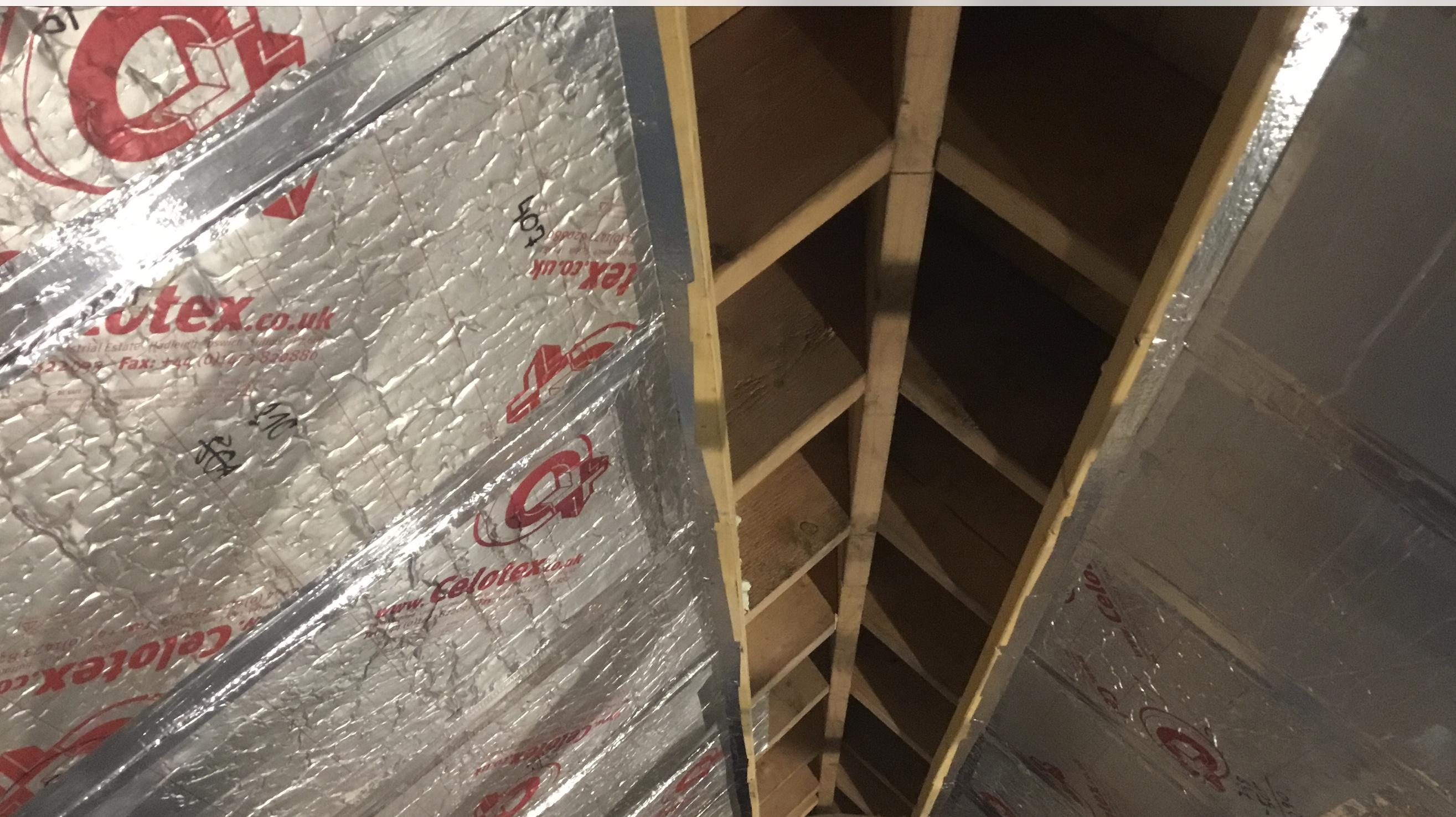

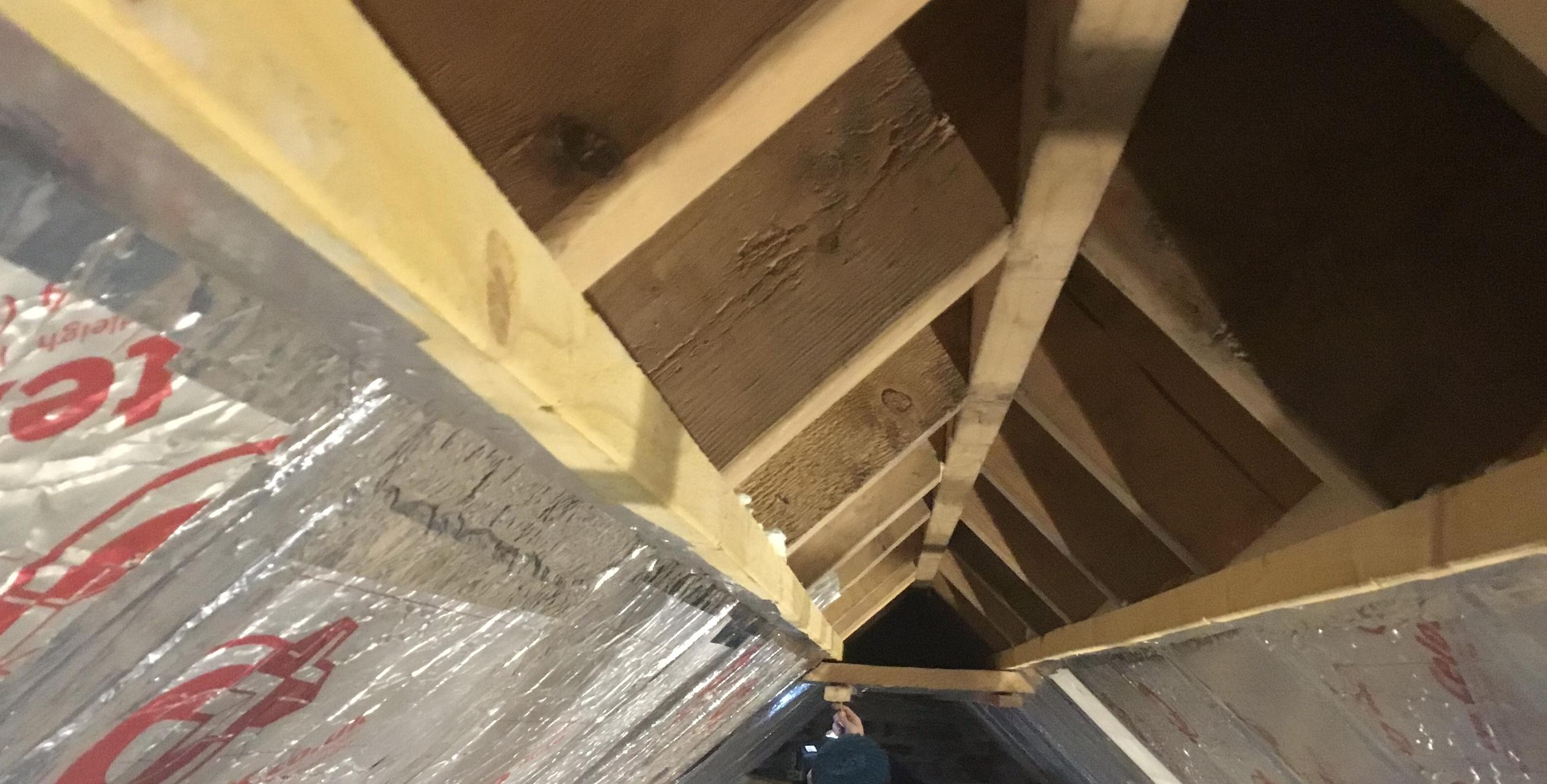

Cpd Posted June 19, 2021 Posted June 19, 2021 (edited) When I did my roof I vented the soffits at each rafter bay and then a 50mm gap all The way up below sarking and then vented the ridge with tile vents along the top x 4 The result is a VERY well vented rood, you can feel the wind blowing up each bay really well. In the picture you can see the area that is fully vented at the top. The bits of wood running length ways are so there is something solid to butt the insulation up to and adds another fixing point. I put 50mm of insulation up first (foamed and taped) as in the picture - We used foam glue to stick up the first 50mm and held the board in place with battens until the glue had gone off and then removed the battens - that’s what’s going on in the second pic and then added another 170mm over the 50mm and attached this with foam glue and screws. It’s probably not how the “book” says to do it but it’s been up 8 years without a hitch. The last picture just shows the vents on the roof. Edited June 19, 2021 by Cpd 1

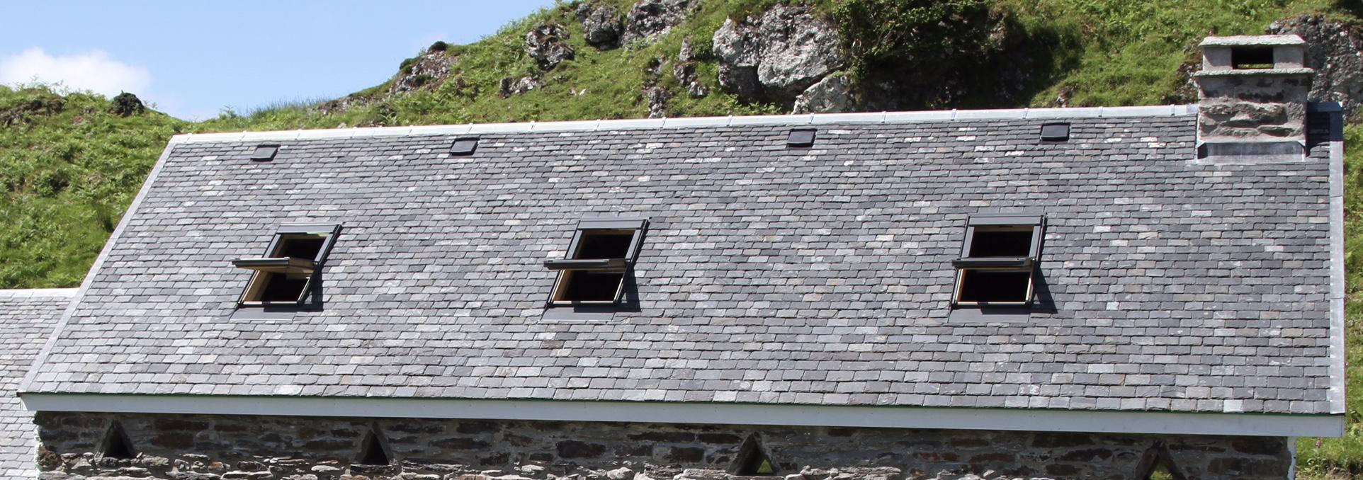

saveasteading Posted June 19, 2021 Posted June 19, 2021 Excellent thanks for the info , and what a pretty roof. Yes I meant fixing vapour barrier under the rafters and insulation, on the warm side. And NOT fixing any under the sarking, just relying on the draught to remove any dampness. As the construction is of slates direct to sarking boards with the traditional gaps every 150mm I would have thought that local draughts would do the job, rather than linking the whole under-sarking void to vents. (Yes you need an awful lot of circular soffit vents. I once talked a BCO out of vents by taking him into my attic to feel the existing draught. That is my current house (change of use) , with tiles onto sarking boards above a cold attic, and the wind whistles through it.) I might just show that existing detail, with comment, and see what is said. There will be no soffit so I think a pragmatic solution will be acceptable. I agree that 25mm vented space is sensible as it allows for local deviation. I have read every word of a very useful blog on a steading rebuild in Aberdeenshire, and gained some info on what is the accepted way for a steading. It is clearly not a mainstream method of construction and there may be many solutions, but it is great to hear of proven ones, and the reasoning. With all that in mind I think I will do a detailed sketch and let you all see it, and await praise or disdain...better from this hub than the BCO. The final version will then be drawn up in CAD for clarity and the ease of the BCO. If we get it right between us then it can go on this hub as an approved solution.
