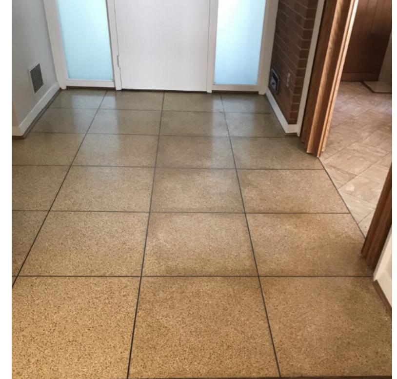

SteamyTea Posted August 8, 2021 Posted August 8, 2021 On 07/08/2021 at 12:02, Adsibob said: picture framing effects What does this actually mean?
Adsibob Posted August 8, 2021 Author Posted August 8, 2021 16 minutes ago, SteamyTea said: What does this actually mean? This, ie the porous tile absorbs moisture around the edges of the tile so that it darkens/looks damp around the edges.

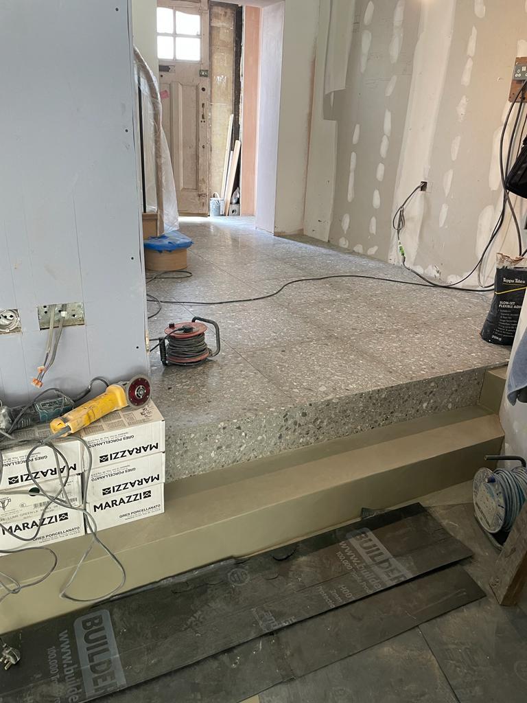

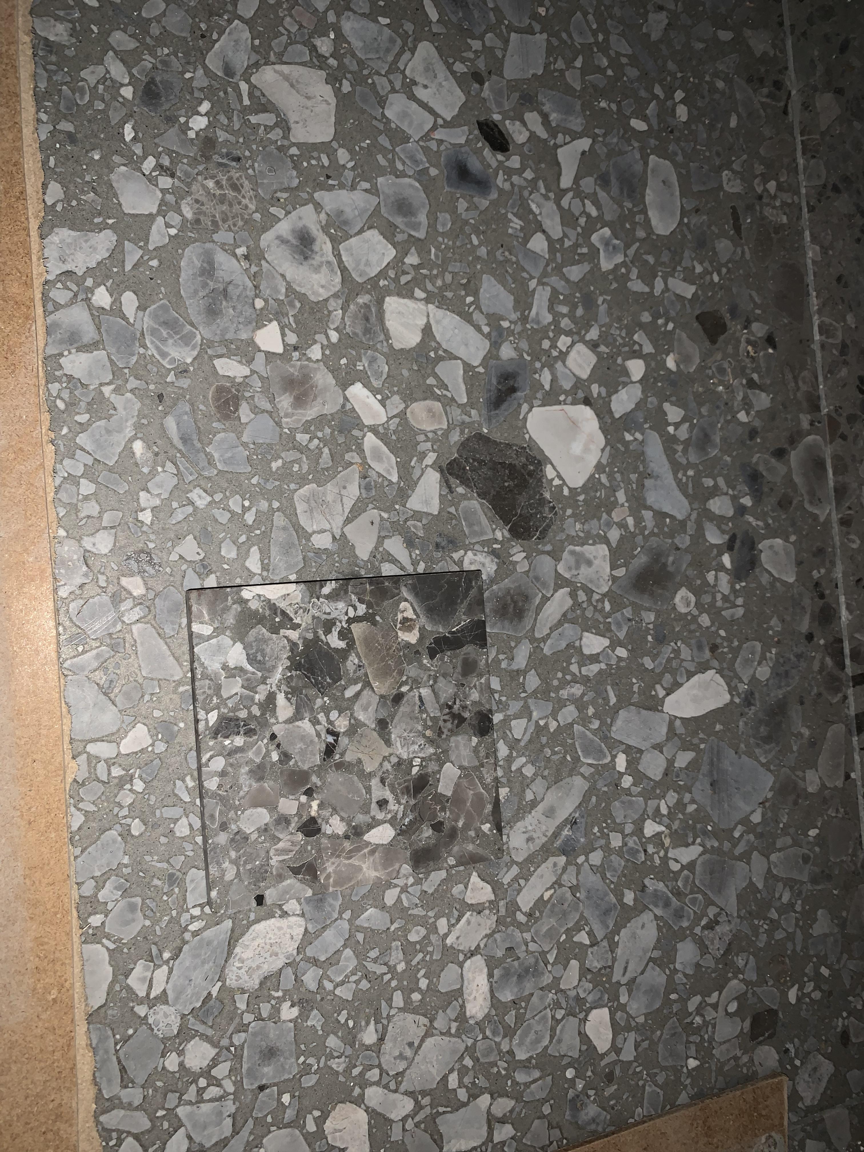

Adsibob Posted March 5, 2022 Author Posted March 5, 2022 (edited) Thought I'd update the thread and tell you how the terrazzo installation went. I previously said: On 07/08/2021 at 12:02, Adsibob said: If we are lucky, we will be ready to tile them in early October. That means 4.5 months after manufacture Well, they were only installed in February, so some 9 months or so after manufacture. During that time they were stored indoors with 1cm wooden spacers between them in a fairly well ventilated area where relative humidity was generally below 55%. In the last couple of weeks before installation, we even brought in some dehumidifiers that brought the overall RH down to about 40% to 44%. They were then laid, then left to dry for about a week (although most of that time they were covered in cardboard, which I wasn't happy about but which the builder assured me would still let them breathe). Last week we cleaned them with Lithofin MN Power Clean and then they were sealed with Lithofin MN Stain Stop. I don't know whether the tiler used just one coat of sealant or two, but if only one there is still time to add another coat as they've not been grouted yet. There is some discrepancy between the tiles as they presently look, and what we were expecting based on the sample; see picture below which shows the sample on top of the tile. As should be visible from this photo, the sample has more of a sheen to it and the colours are slightly more vibrant, with more contrast. Oddly, when I raised this with the supplier they told me the samples are not sealed and they just get that more polished look from people handling them in the shop. Should I: stick to the installation instructions which is to put another coat of Lithofin MN Stain Stop sealant (if indeed tiler has only done one coat), then grout, wait for grout to dry then two more coats of Lithofin MN Stain Stop sealant; OR switch to a "colour enhancing sealant" such as Lithofin MN Colour Intensifier, although I see that on the description of that product, it states "Please Note: for protecting polished and very finely honed natural and artificial stones, we recommend Lithofin MN Stain-Stop" so maybe terrazzo, bring a combination of portland cement and natural stone falls into that category? Maybe @nod can come to my rescue and provide some tips. Edited March 5, 2022 by Adsibob
Mr Punter Posted March 5, 2022 Posted March 5, 2022 I have had a very similar look on some granite tiles when they were installed and after about 6 months it faded away. Do you have an up-to-date picture?

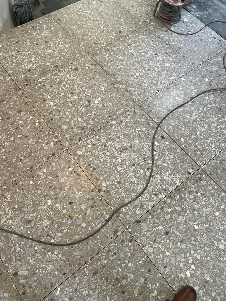

Adsibob Posted March 5, 2022 Author Posted March 5, 2022 Not sure why previous photo upload failed. Here it is again (the small tile on top is the sample, the large tile below is my new floor).
Adsibob Posted April 15, 2022 Author Posted April 15, 2022 On 05/03/2022 at 16:31, Mr Punter said: I have had a very similar look on some granite tiles when they were installed and after about 6 months it faded away. Do you have an up-to-date picture? So the supposedly breathable cardboard that has been covering the still ungrouted tiles was taken up a couple of days ago. Unfortunately, we have some picture frame staining, which must be from the manufacturing process (which involves water jet cutting) and then the delay: not grouted yet, but I fear there is no solution to this and that when we grout, it could get worse as the grout is water based. Have the UFH running 24\7 now, for the last 36h and hoping over the next week it evaporates, but who knows.
Adsibob Posted April 16, 2022 Author Posted April 16, 2022 Just wondered if anyone had any experience of getting water stains out of terrazzo? I’ve seen in some websites that for general staining, rubbing with hydrogen peroxide and then with ammonia can clean terrazzo, but that sounds rather harsh. @nod do you know if it’s possible to get rid of subtle picture framing staining, which appears to just be stained with water, but definitely dry now (was laid a few months ago and has had quite a bit of UFH, including constantly for the last 48h.
Adsibob Posted September 5, 2022 Author Posted September 5, 2022 (edited) Thought I'd update this to say that in the end, the supplier was wrong. They weren't water stains - or if they were, the stains were polished out with some grinding. Only compromise is that the finish has come out with a slightly higher level of sheen than you would have from properly honed tiles, but it's not glossy and looks very good, so generally very happy with the outcome. Just an issue with some of the grouting... Edited September 5, 2022 by Adsibob
