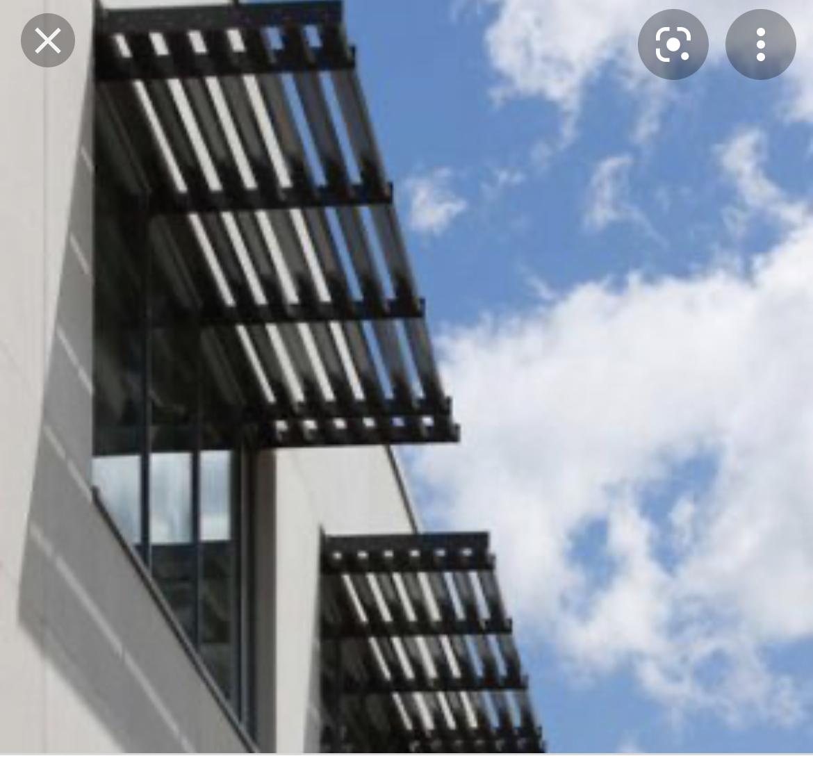

Russdl Posted October 21, 2021 Share Posted October 21, 2021 I though I’d just add a bit to this overheating thread. We’ve been having to cool the house down for the last 24hrs as last weeks blip of mild temperatures (high teens Celsius) had us hitting 23-24 degrees in the bedrooms. The house is passive standard with external blinds on all bar one of the east and south facing windows and this last summer - fleeting as it was - didn’t cause any greater problem than we’ve just experienced. Two things caused it I think. The first was as summer started slipping away we started opening the blinds when it was sunny to get the solar gain, we perhaps went too early on that (it’s our first year in the house) so next time round we’ll let the internal temperature dip a little lower before we start inviting solar gain in. The second element, and this is a complete guess, is the black timber composite cladding on the gable end where the MVHR intake/exhaust are. The gable end is facing just south of east and it gets warm pretty quickly when the sun decides to show and it looks like this is boosting our intake temperature by several degrees. As an example, at the moment it is 11 degrees outside but the intake air is arriving at the MVHR at 15 degrees (from intake grill to MVHR is about 2.0m) I’ve had the bypass open for 24hrs but still the supply air to the house is 1.5 degrees hotter than the intake air, I guess it’s gaining the temperature from the MVHR and ducting despite the bypass being open. The house temperature is slowly falling towards 21 degrees. I never expected to be having to cool the house in late October. I’m quite delighted to be honest. Link to comment Share on other sites More sharing options...
SteamyTea Posted October 21, 2021 Share Posted October 21, 2021 1 hour ago, Russdl said: The first was as summer started slipping away we started opening the blinds when it was sunny to get the solar gain, we perhaps went too early on that (it’s our first year in the house) so next time round we’ll let the internal temperature dip a little lower before we start inviting solar gain in. My two points. The sun is at a lower altitude in the sky, you you may be getting in more radiation that you think. More than 'summer', which is generally cloudy and wet where I am. How much daylight do people actually need in a house. Like artificial lighting, most people put in a lot more than, in my opinion, is comfortable. But I have had my cataracts replaced with shiny bright acrylic lenses. Link to comment Share on other sites More sharing options...
Conor Posted October 21, 2021 Share Posted October 21, 2021 Yep, angle of the sun. Low angle means more is bypassing shading by reveals and overhangs and directly hitting surfaces of your interior. Link to comment Share on other sites More sharing options...
SteamyTea Posted October 21, 2021 Share Posted October 21, 2021 (edited) 4 minutes ago, Conor said: Yep, angle of the sun. Low angle means more is bypassing shading by reveals and overhangs and directly hitting surfaces of your interior. And less reflection off the panes, and less absorption by the panes. Edited October 21, 2021 by SteamyTea Link to comment Share on other sites More sharing options...
