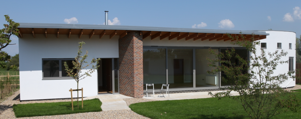

Mr Punter Posted June 8, 2021 Posted June 8, 2021 Definitely no and I think you should get at least 2 more quotes. If there is a difference of £9000, what were the actual quotes? I have found that overheating is a bigger deal in a new house than heat loss. Look at reducing the glazed areas if possible, especially in bedrooms.

Mr Punter Posted June 8, 2021 Posted June 8, 2021 43 minutes ago, Happy Valley said: We have 4 foot overhangs on the roof above the sliders to stop overheating in the summer. This will help a bit if they are south facing, but not 100% Here is one we did with an 1800mm overhang, south facing picture at 13:15 on 20 April and the sun is still halfway up the windows: 2
