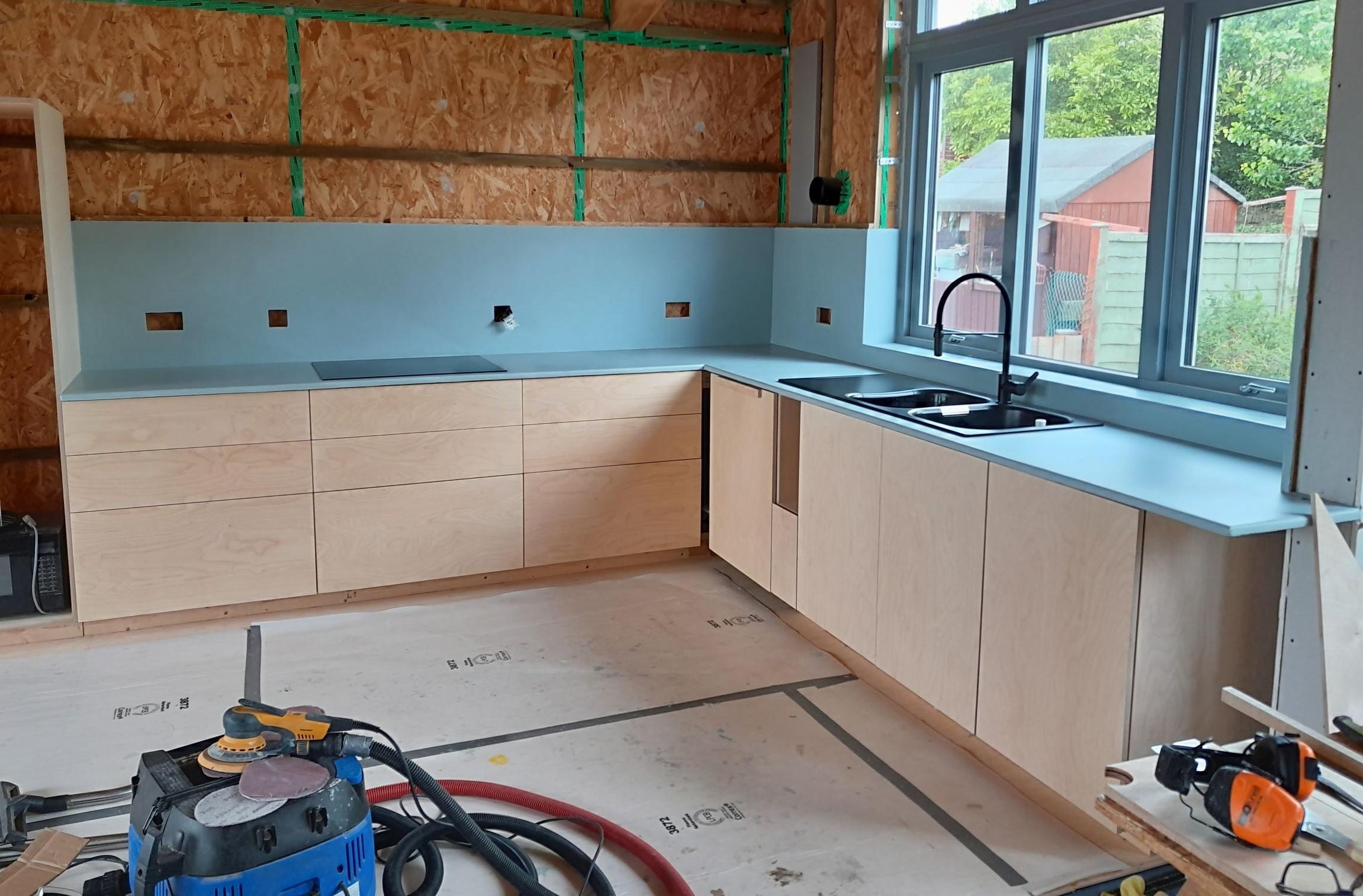

SimonD Posted July 19, 2022 Posted July 19, 2022 (edited) 17 hours ago, Dan F said: They just called me. £133/m2! Why anyone would use it at that price vs. concrete-effect porcelain or real polished conrete I don't know. (apart from maybe in a wetroom). Be interesting to know how happy @SimonD is with his result and roughly what the Cemher system costs per m2. So far I'm happy, but do bear in mind that I did the installation entirely myself. I've now done one shower and the kitchen worktop/splashback. For the actual microcement I paid a couple of different prices as the system varies according to toughness and area of application. At current prices the system for shower/wetroom cost £29.50/m2 for 10m2 kit and the system for the kitchen worktop was £41/m2 again for a 10m2 kit (plus shipping which as it's heavy works out at about £65). The shower has had regular use for about 6 months now and is as it was when installed - as you'd hope! 🙂 Kitchen worktop has seen regular use for nearly 3 months. Neither long term test yet. The only slight annoyance I've got is that the worktop kit says it's completely resistent to stains from just about anything. It seems to do this but when cooking with turmeric, if it sits on the worktop for a period of time I have to scrub it off the surface rather than just wipe it off like with everything else. Once scrubbed, there's no sign of it so it doesn't actually stain. I do wonder whether I applied the final coats of sealant slightly too thin because there is a fine texture on the surface which I think the turmerice gets into. When I get the chance, I have enough left over to apply another thicker final coat of the sealer. Nothing else touches it so far. Service I have to say was very good. When I started laying the microcement for the kitchen the base coat came out very blue, and so did the first of the top coats. I contact the supplier with some photos and within a day they'd shipped out a replacement topcoat kit with a corrected pigment. I've uploaded a photo of the worktop with integral splashback and window sill - still looks blue in the photo but it's actually a silver grey that takes on a slightly blue tone under certain light conditions and the bare wood in the house also makes it look more blue that it really it. Apologies I can't help more with installers but I bought my stuff from Relentless Microcement and bought the professional kits rather than diy kits. If you want to tackle the job yourself they do provide comprehensive instructions and training videos. Otherwise perhaps get in touch with them to see if they have a network of known installers, possibly worth a try? I think the cost of microcement installation is because it needs several layers with time in between each coat which means lots of curing time and return journeys for the installer. I've found that if you follow the proper curing times it ends up taking about 6 days in elapsed time with daily applications that take anything from only 1/2 hour to 3 hours only. Edited July 19, 2022 by SimonD
SimonD Posted July 19, 2022 Posted July 19, 2022 16 hours ago, Adsibob said: I paid considerably less than that after negotiating for quite a while, but I also got crappy service and which I had just laid something else. Oh dear! Sorry to hear that. As a product and material, I've come to really like it. Time will tell as to longevity.
