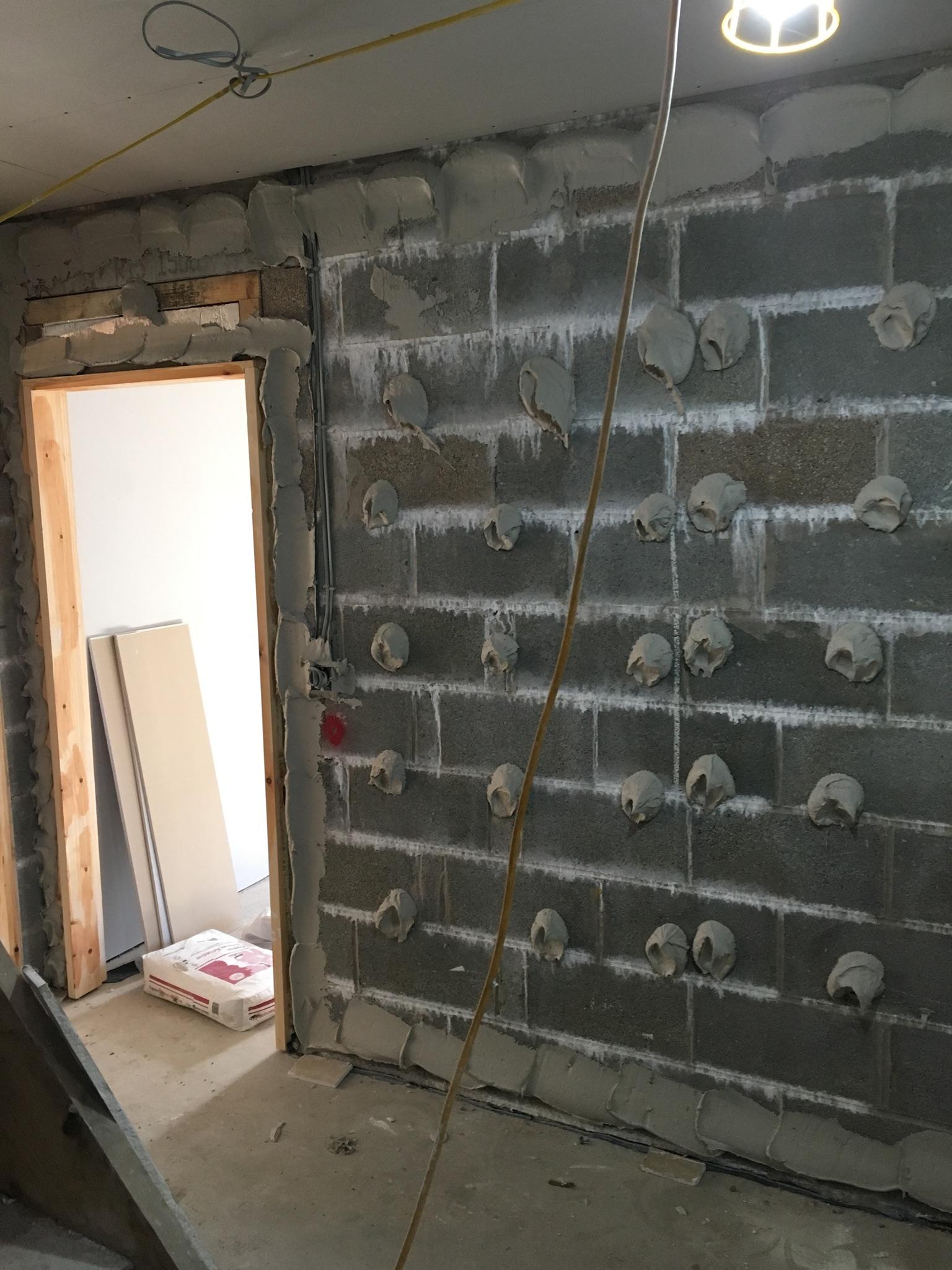

nod Posted June 3, 2021 Posted June 3, 2021 As a business I do both options Both can easily be sealed It’s down to individual preference The main areas for air leakage are around windows and exterior doors The heads and reveals around these will need to be dot and dabbed But the rest can be wet plastered I chose to dot and dab ours As it gives a warmer feel Though I could have rendered it far half the price 1 1

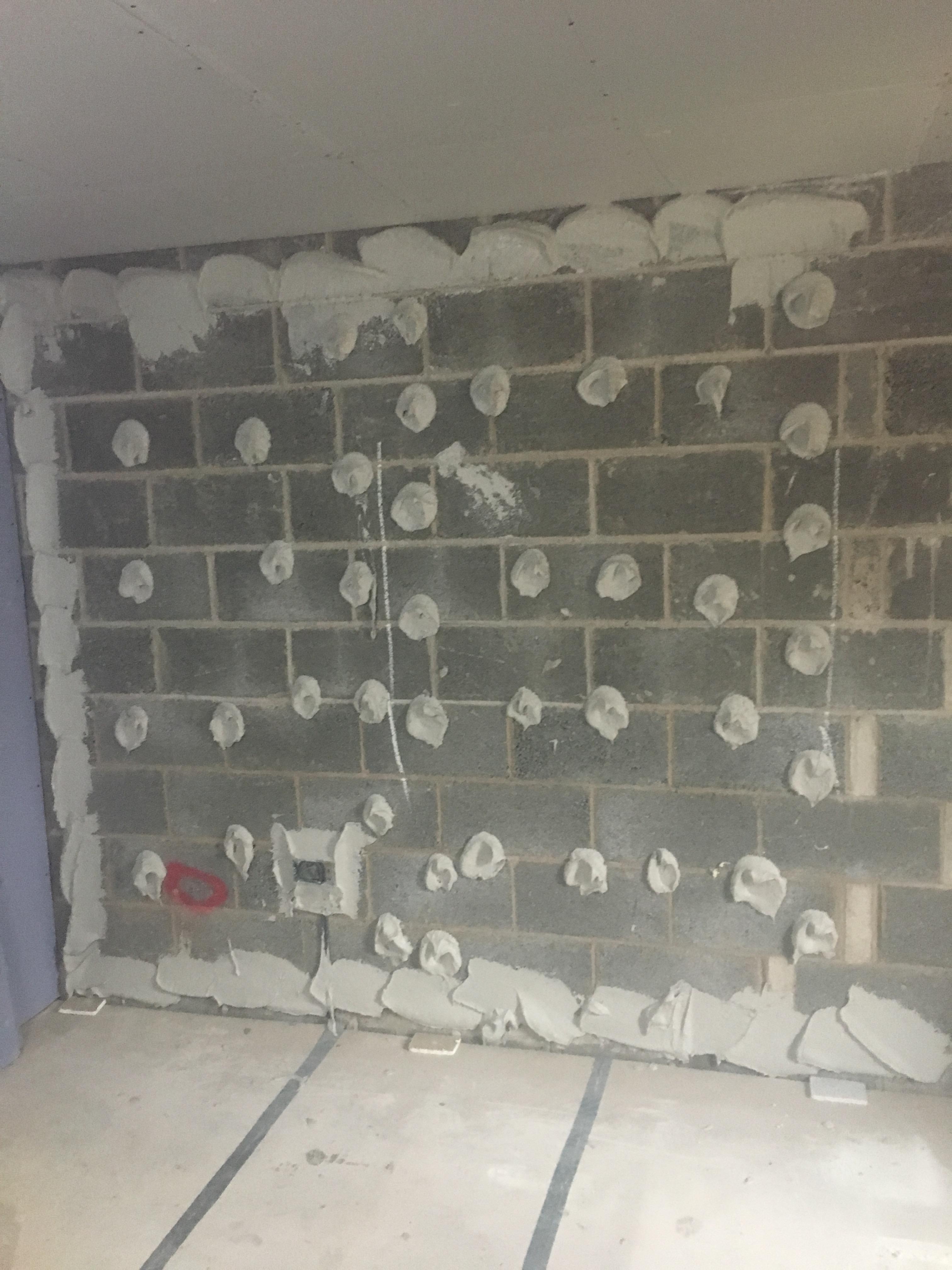

Nickfromwales Posted June 3, 2021 Posted June 3, 2021 It's all down to quality of work, whichever you chose, and attention to detail. I would parge the blockwork, fill and smooth any chases / back boxes etc, foam and seal joist pockets / other penetrations to atmosphere if you have them, and then dot n dab. You won't get a plasterboard / thermal 'tent' if you mitigate against it. Knowing how / where to successfully mitigate is the key to success. 1 2

Nickfromwales Posted June 4, 2021 Posted June 4, 2021 2 hours ago, ProDave said: I would parge coat the walls to seal them, and then fix vertical 25 by 50mm battens to the wall. That creates a service void to run pipes and cables and the plasterboard screws to thos And then you're at the mercy of the shape / state of the walls. No thanks! No blockwork walls go up precise enough to do that, none that I've ever seen anyhow, so all of the kickers in the blockwork and the out-of-plumb bits transfer unhindered to the plaster-boarded face unless you go about spending an age packing and levelling each batten. Even then you only get a vertical batten but you don't get a straight wall as each batten is not flush with the previous / next batten unless you really turn into the batten fitter of the year. Pointless ball-ache. Chase the boxes in 15-20mm, clip the cables to the blockwork, parge the boxes in, and dot n dab to an immaculate flat, straight wall. Plasterer only has to finish then as opposed to dub and finish. 1
Nickfromwales Posted June 4, 2021 Posted June 4, 2021 I wish you were around to show a few guys I've met exactly how to D'N'D properly mate. Some are still out there working with 12 miserable dabs to a full board 1 1

Nickfromwales Posted June 5, 2021 Posted June 5, 2021 3 hours ago, joe90 said: Personally I don’t like the “feel” of dot and dab (hollow sounding walls). Yes I know if it’s done properly it performs well but I had my build cement rendered then plaster top coated. I can hang anything I want from any wall (apart from the odd stud wall in bedrooms/bathroom upstairs). Preferable yes, but you need a good spread to get things dragged and floated on the first sets so the end result is flat / plumb etc. For D’N’D I now stipulate a minimum of 70% adhesion, plus a continuous bead around perimeters / sockets etc. All methods can be done badly so it always falls back to the tradesperson undertaking the work, every time. 2
