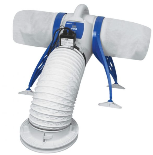

MortarThePoint Posted May 26, 2021 Author Share Posted May 26, 2021 They both look a bit Noddy (or should that be NooNoo) but the Drimaster and Pozidry both cost around £300 https://www.fastlec.co.uk/ventilation/nuaire-dri-eco-hc-drimaster-eco-positive-input-ventilation-unit https://www.fastlec.co.uk/ventilation-extractor-fans/vent-axia-lo-carbon-pozidry-pro https://www.fastlec.co.uk/vent-axia-lo-carbon-pozidry-pro-fd-with-heater-multi-storey https://teletubbies.fandom.com/wiki/Noo-Noo 1 Link to comment Share on other sites More sharing options...
Cpd Posted May 26, 2021 Share Posted May 26, 2021 I have the top one. I installed it in the same location you talk about but my situation was different, shite house no insulation at all and mould forming on the hallway walls as well as other rooms, After instaling this it definitely stopped the mould on the hallway walls but did little to help in other areas - can’t expect miracles. It’s virtually silent and the air is diffused by the cover over the inlet pipe. I really don’t see how these can be effective as a way of ventilation in a new house as they pump cold air into the house in the hall and in theory as the pressure rises that cold air escapes through gaps in the building therefore giving you an air change system.... in reality I think the air escaping just takes the easiest route and pretty much bypasses everywhere else. I am just in the process of insulating the house and will see how it performs then but it would NOT be my go to solution for ventilation on a new build. 1 Link to comment Share on other sites More sharing options...
MortarThePoint Posted May 26, 2021 Author Share Posted May 26, 2021 (edited) @Cpd I'm hopeful there would be enough mixing with the air already in the hallway. The volume of air in just the hallway is around 50m3 which is something like 10 minutes of the PIV's maximum flow rate. I could investigate the option of a trickle extract on the kitchen extractor fan which would help draw the air through more of the house. Edited May 26, 2021 by MortarThePoint Link to comment Share on other sites More sharing options...

MortarThePoint Posted May 26, 2021 Author Share Posted May 26, 2021 2 minutes ago, Bitpipe said: For me, the heat recovery element of MVHR is secondary to its primary function of effectively ventilating the whole house. That's why I like the look of PIV. It doesn't distribute the air as well as the multiple outlets of an MVHR system would, but it is fresh filtered air coming in. It's not heated by scavenging 90% or more of the outgoing air's energy, but those economics are discussed elsewhere. Link to comment Share on other sites More sharing options...
