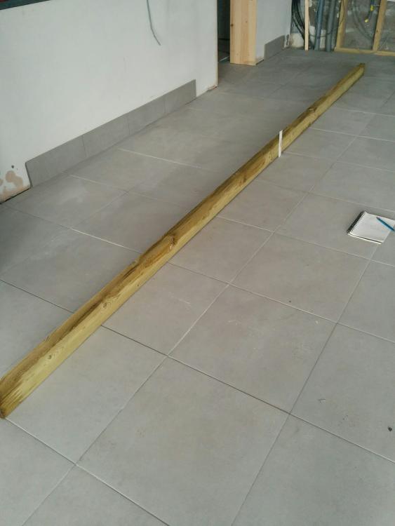

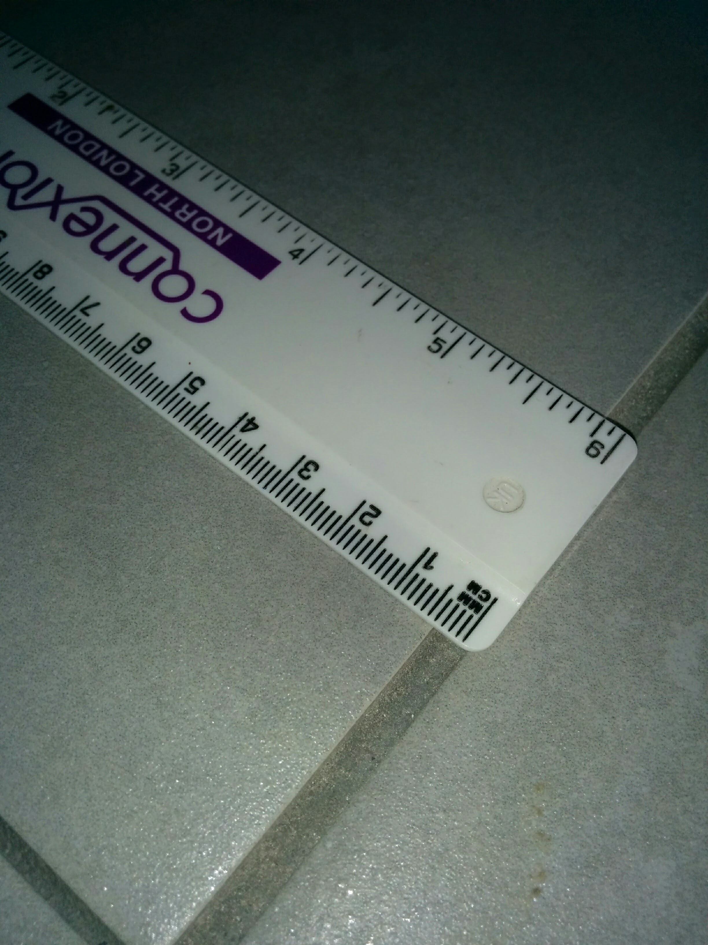

Fallingditch Posted March 4, 2017 Share Posted March 4, 2017 (edited) We have just had a large area of tiling laid (around 50 sq m of 450 x 450 porcelain floor tiles) for our large open plan kitchen area. To my untrained eye, the quality of workmanship appears unsatisfactory. However, rather than saying to the subcontractor "this does not look good enough to me" and then arguing about what good should look like, can anyone offer advice on some objective measures for a professionally laid tiled floor ? For instance, how level should it be? how straight the gaps between the tiles should be? If the response from the subcontractor is "it was the tile quality - specifically their varying thickness" - what would be considered to be an acceptable tolerance for 450 x 450 floor tiles? Edited March 4, 2017 by Fallingditch typo correction Link to comment Share on other sites More sharing options...

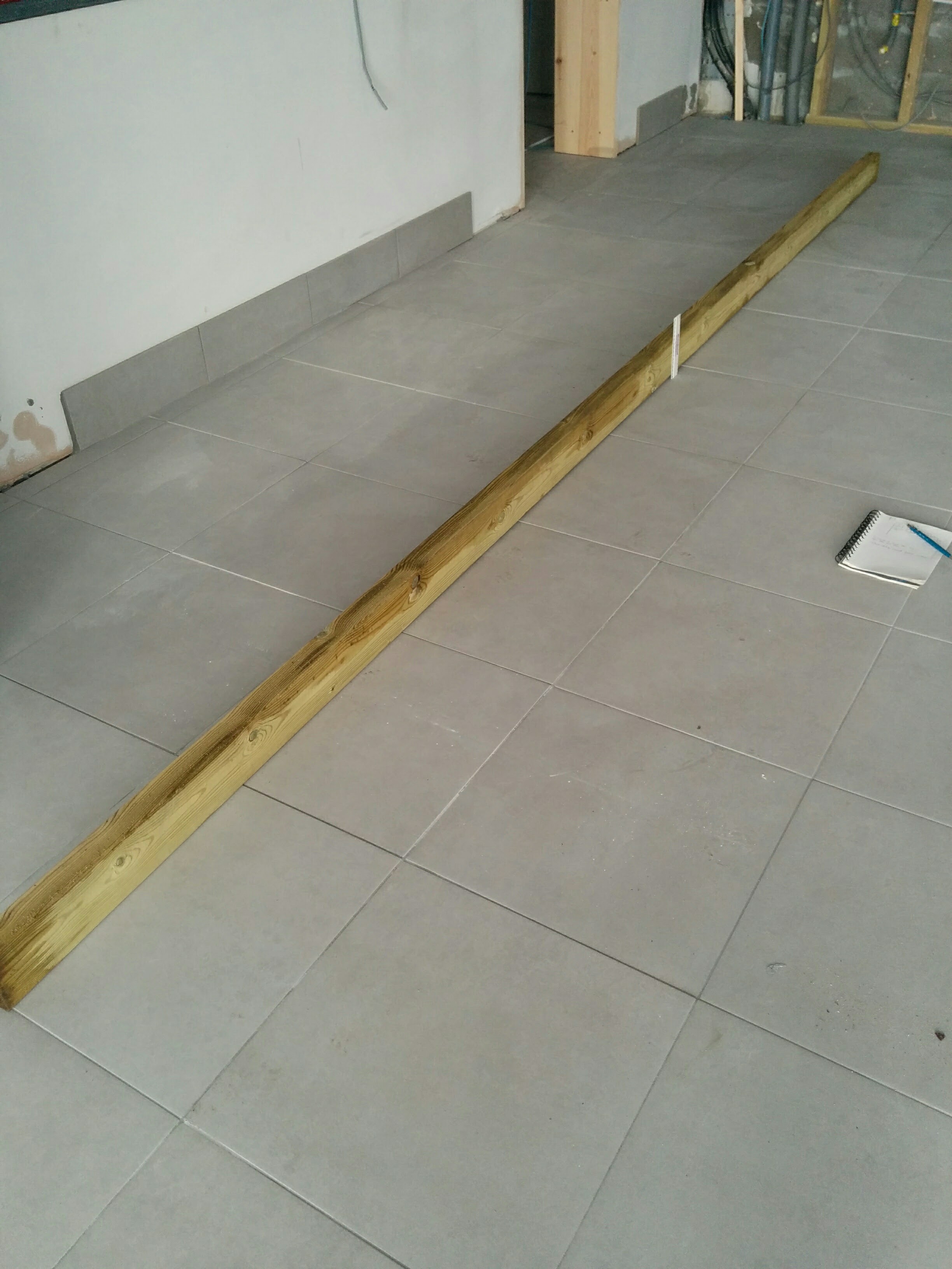

Nickfromwales Posted March 4, 2017 Share Posted March 4, 2017 4 hours ago, Fallingditch said: the quality of workmanship appears unsatisfactory Is this onto a new slab? Get a nice STRAIGHT length of 4x2 around 8' long and sit it across various areas of the floor. That'll show any 'kickers' and undulations in the laid floor. What exactly has you worried? Link to comment Share on other sites More sharing options...

MrP Posted March 5, 2017 Share Posted March 5, 2017 Have a look through this, it gives a max tolerance of +/- 3mm over a 2m straight edge. Not really much excuse for flatness as with a decent adhesive bed you should always be able to even it out. Joint thickness is difficult as it depends on tolerance of the tile but i agree with earlier comments that you would like to think he would have stopped and spoken to you once he realised there was a problem. filedownload,15912,en.pdf Link to comment Share on other sites More sharing options...

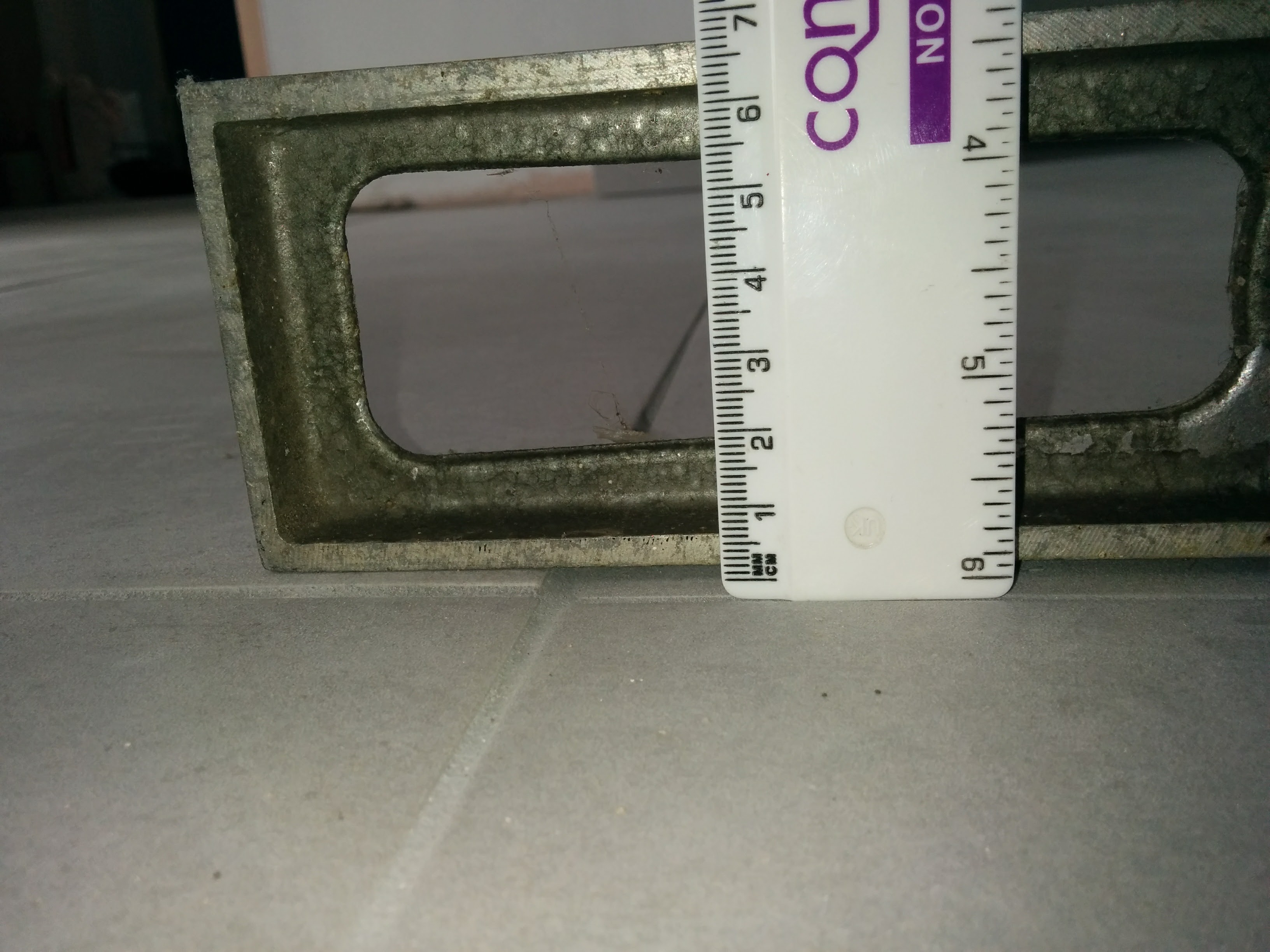

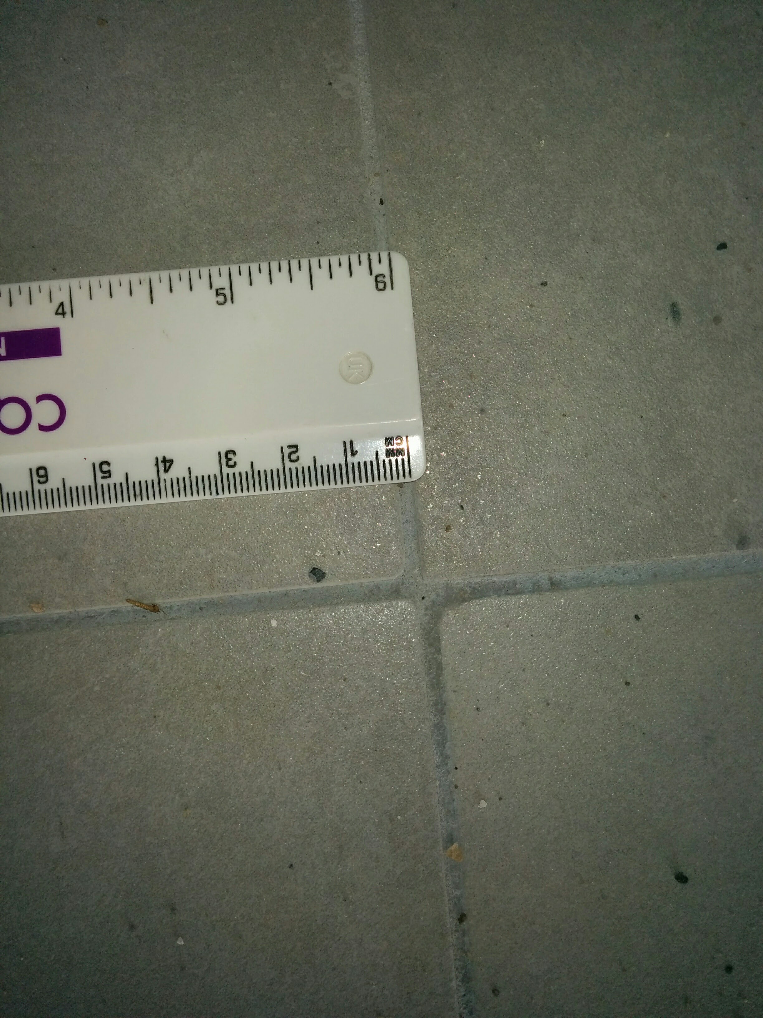

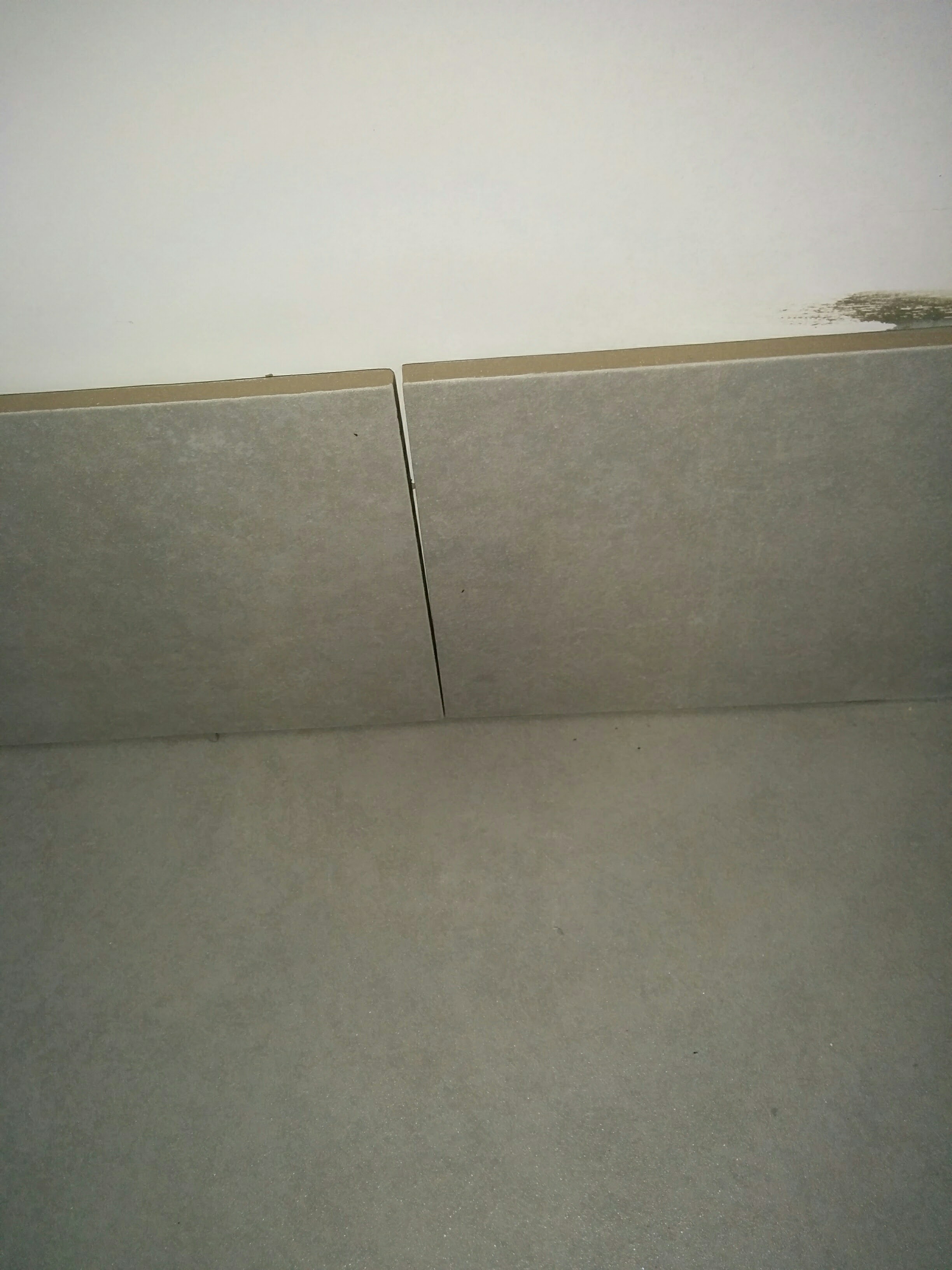

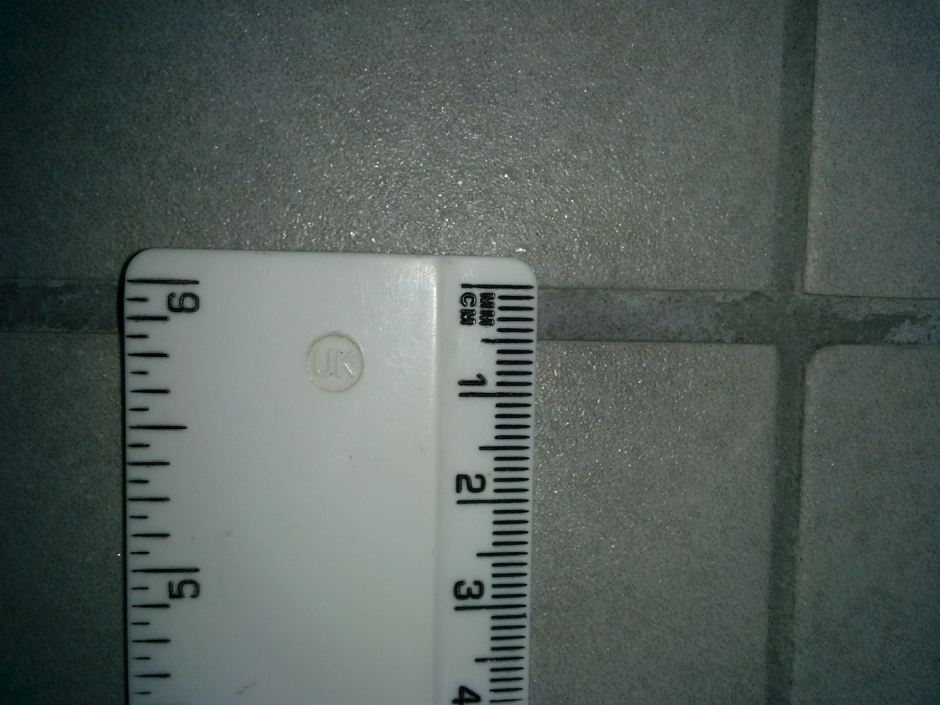

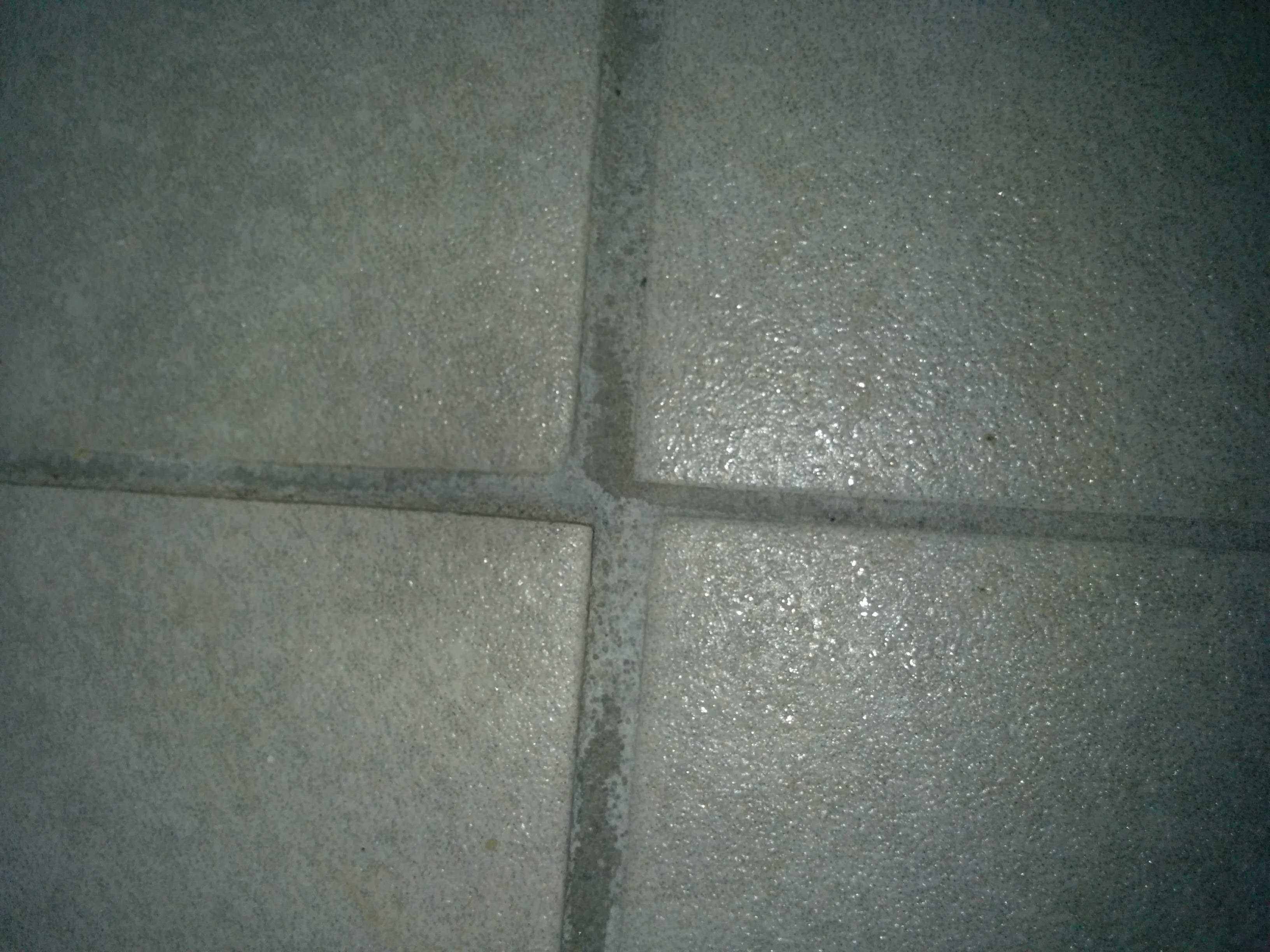

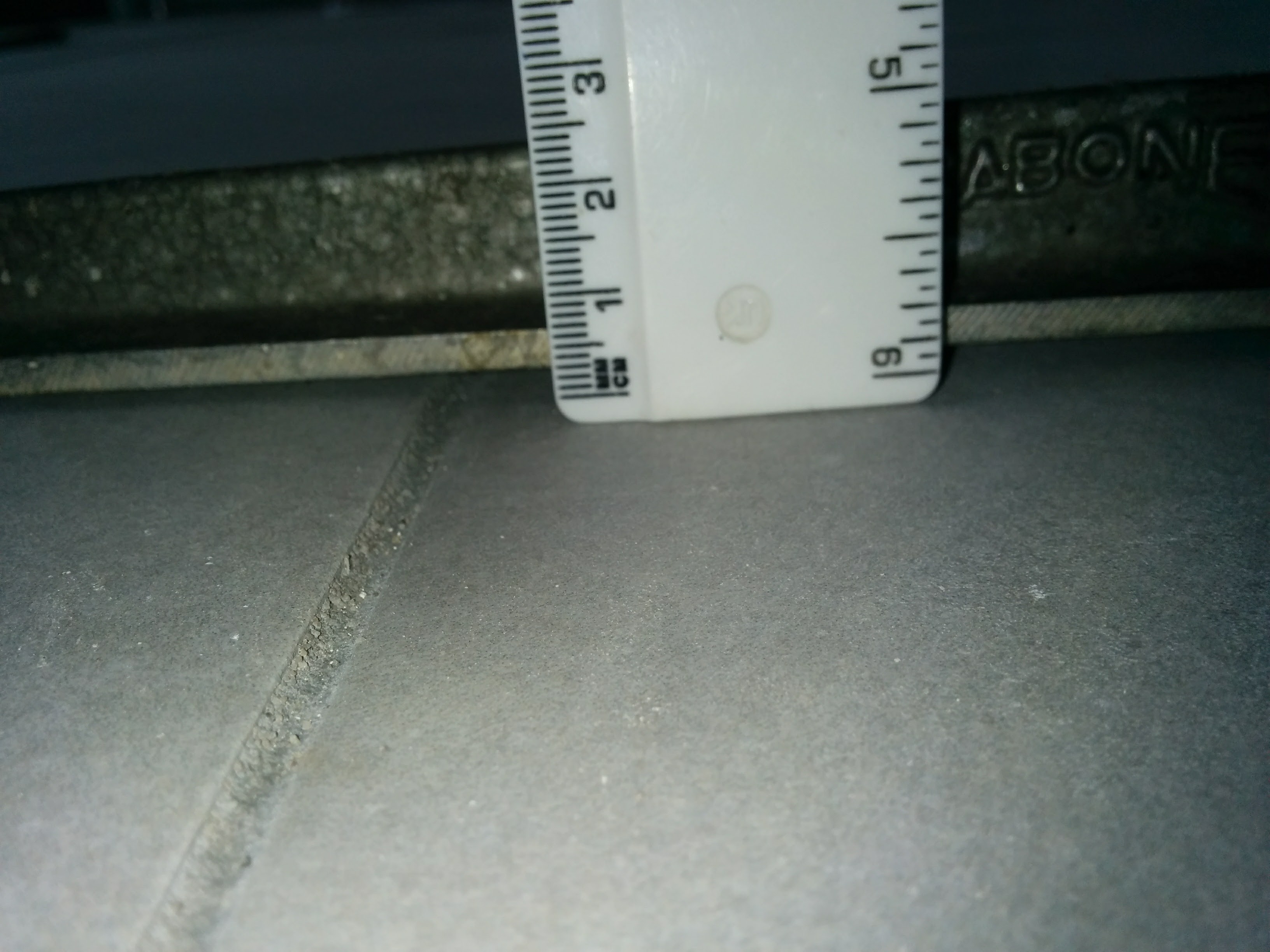

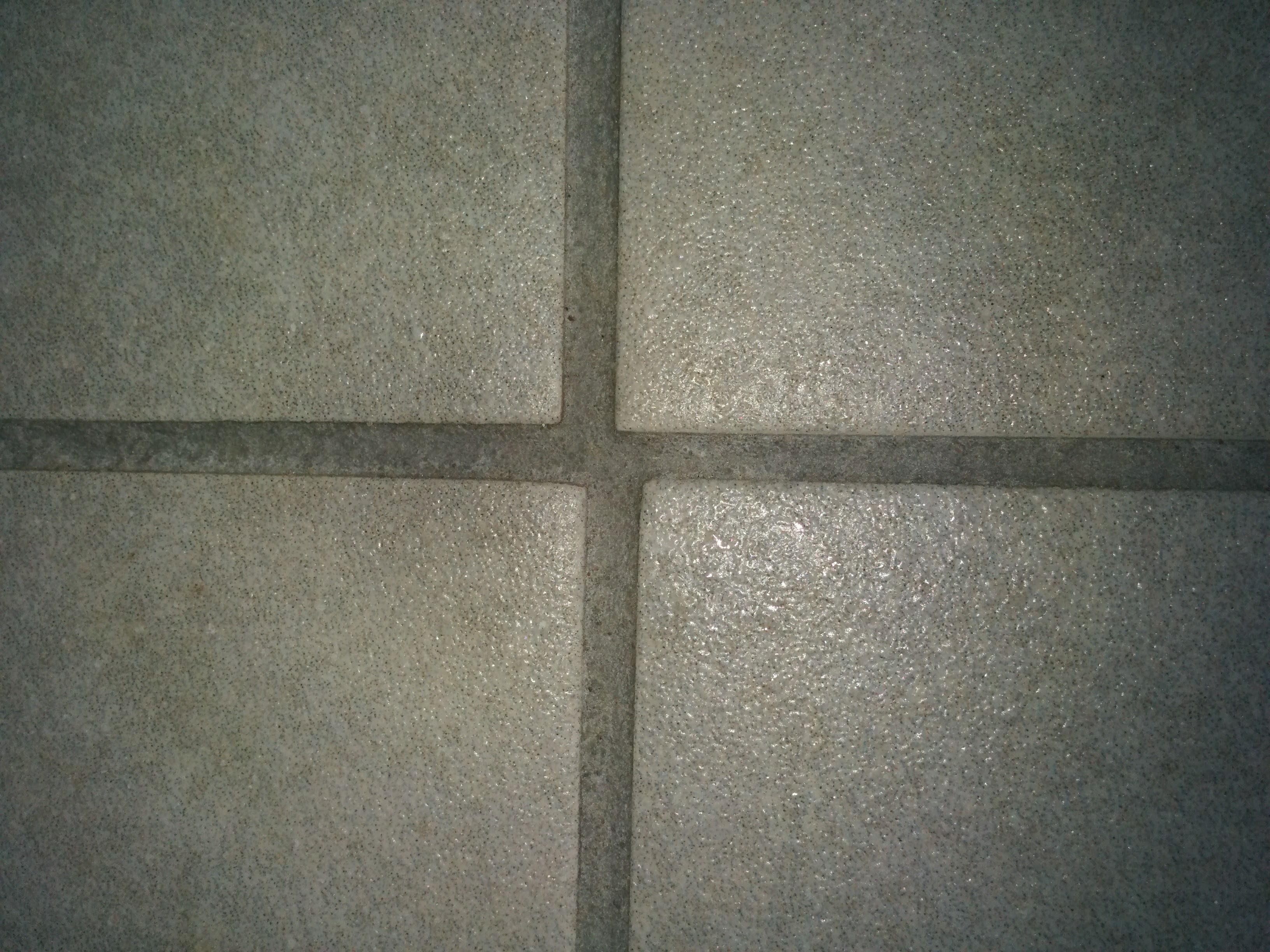

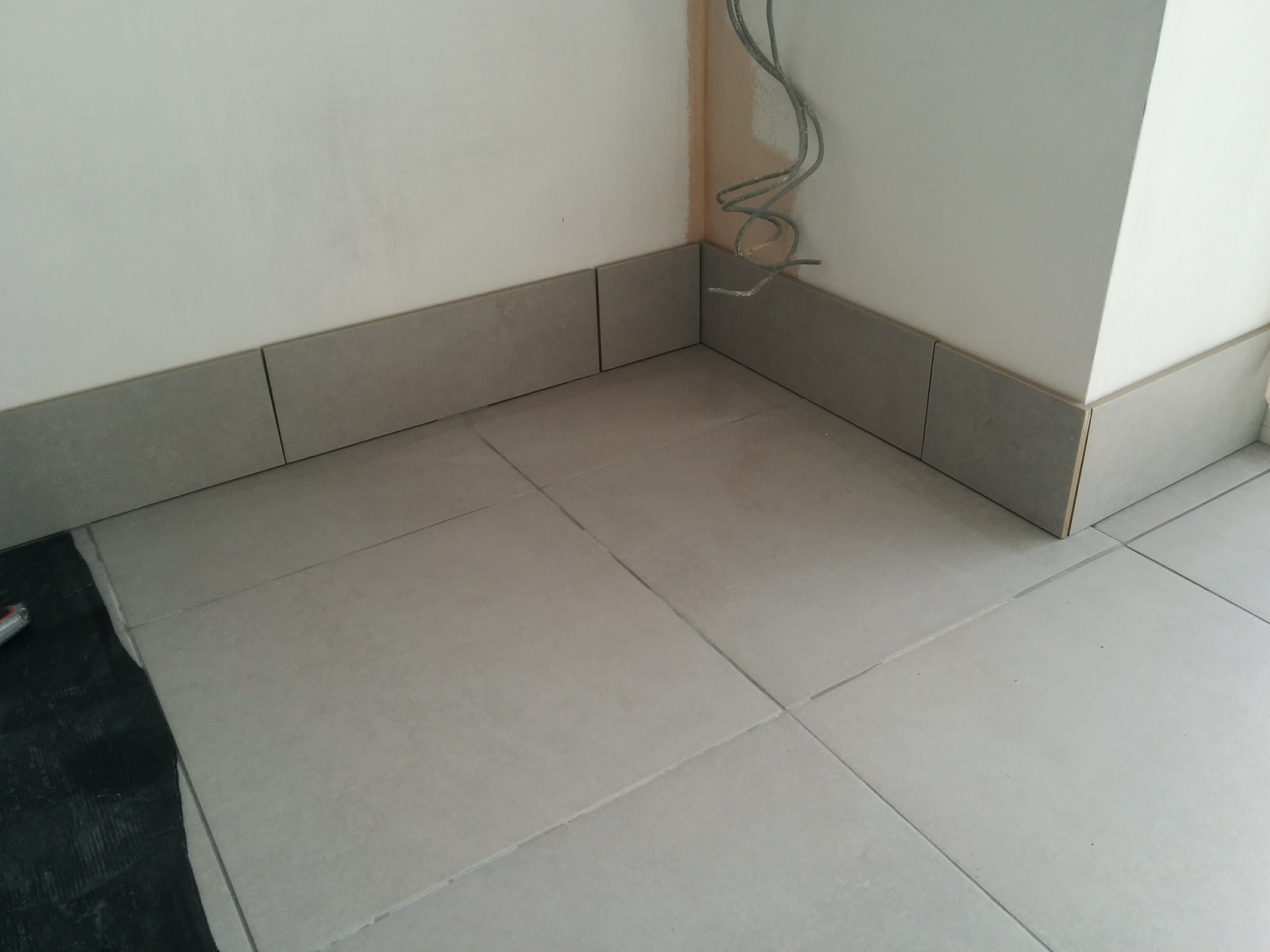

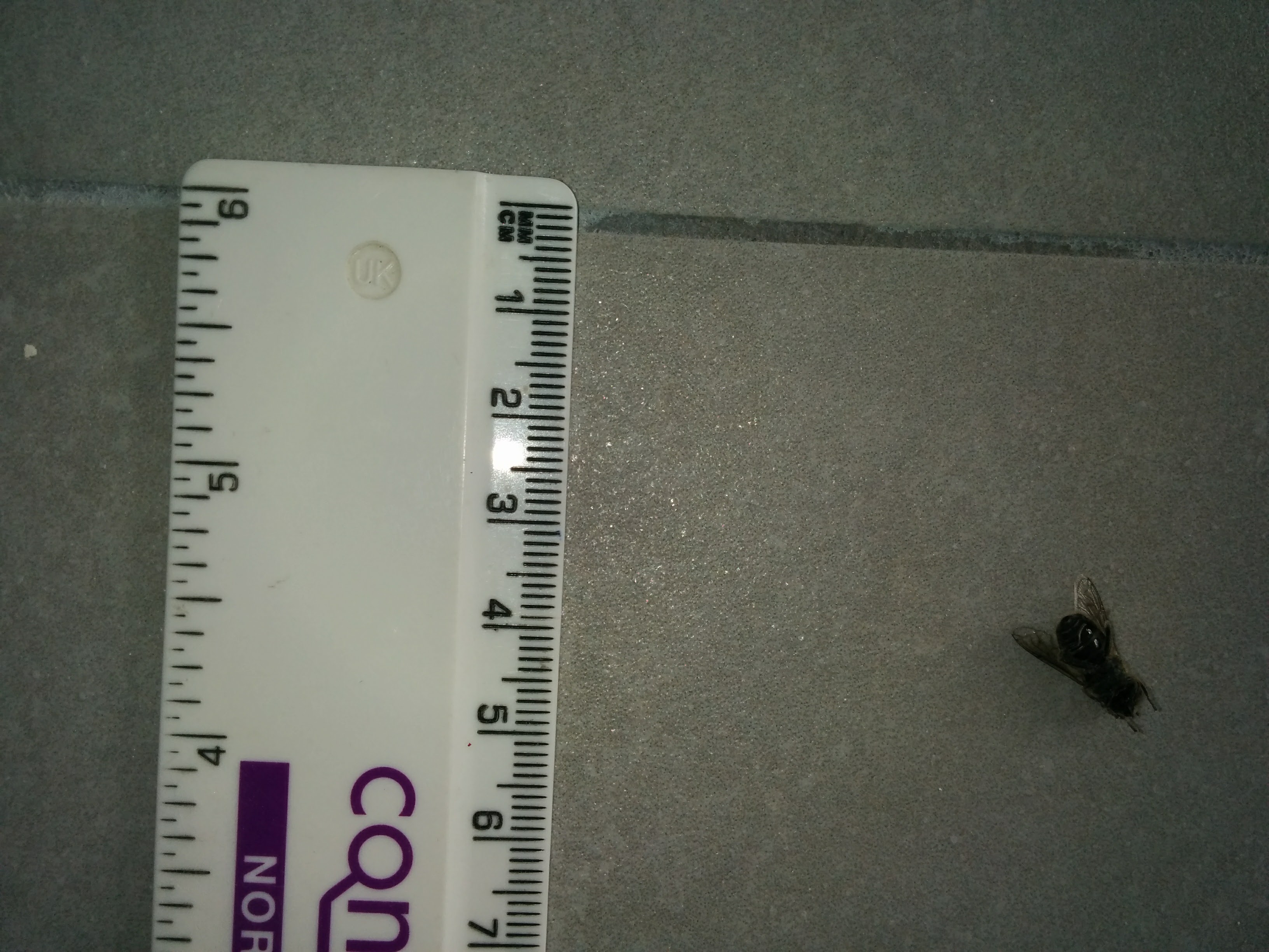

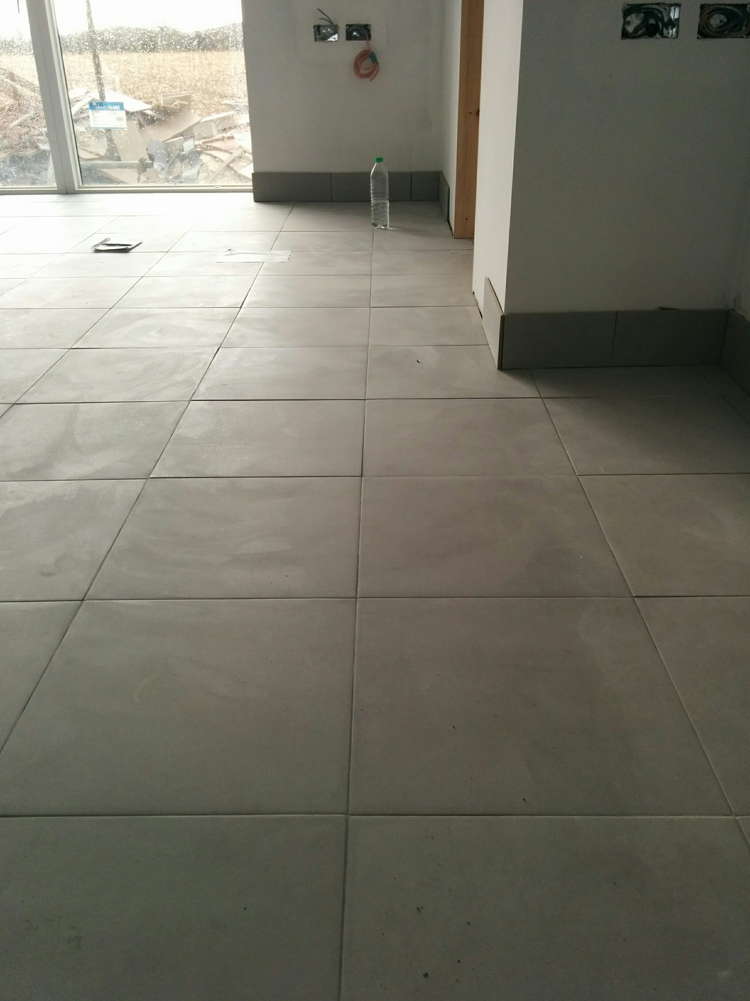

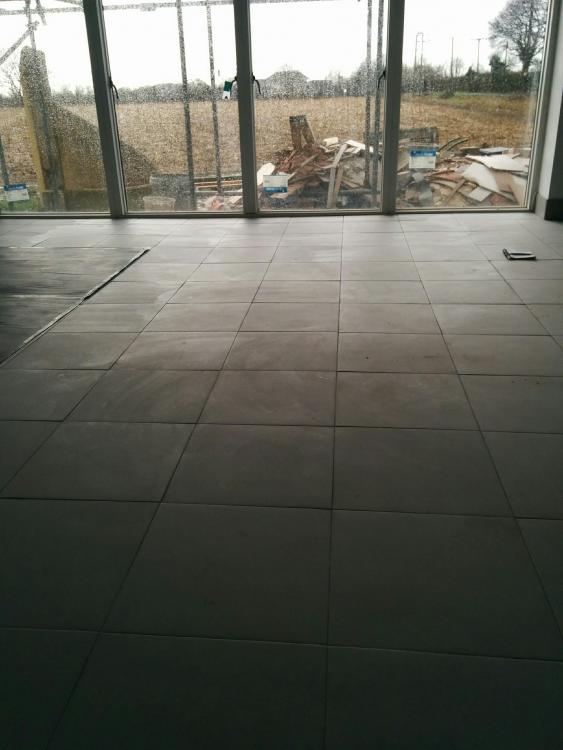

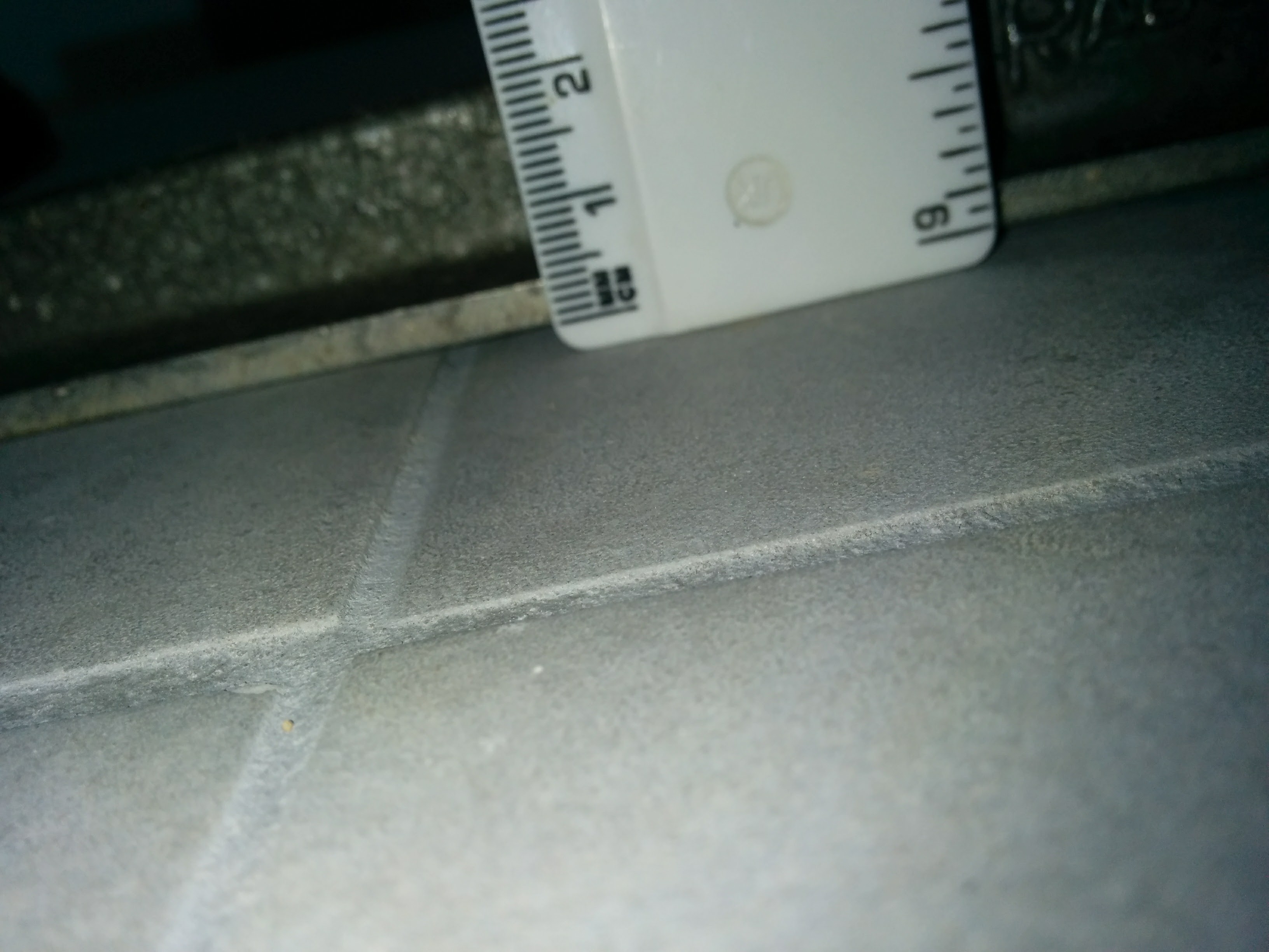

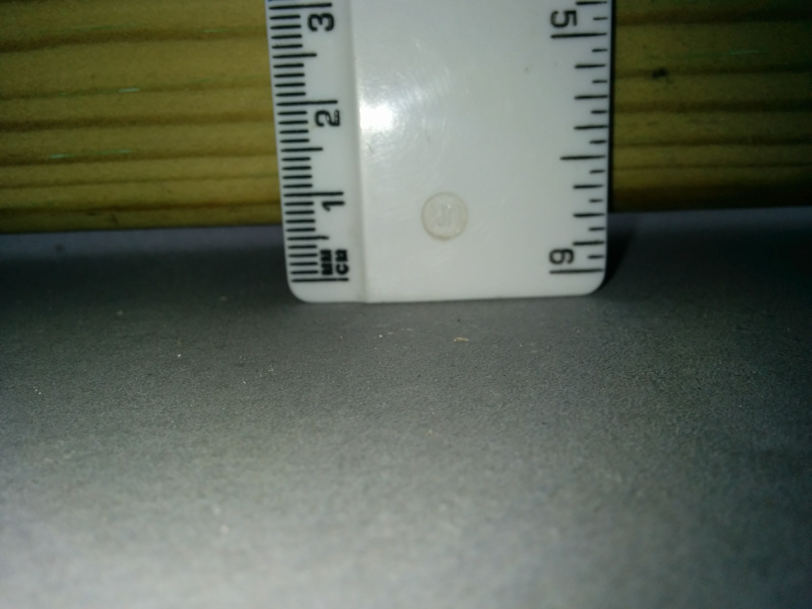

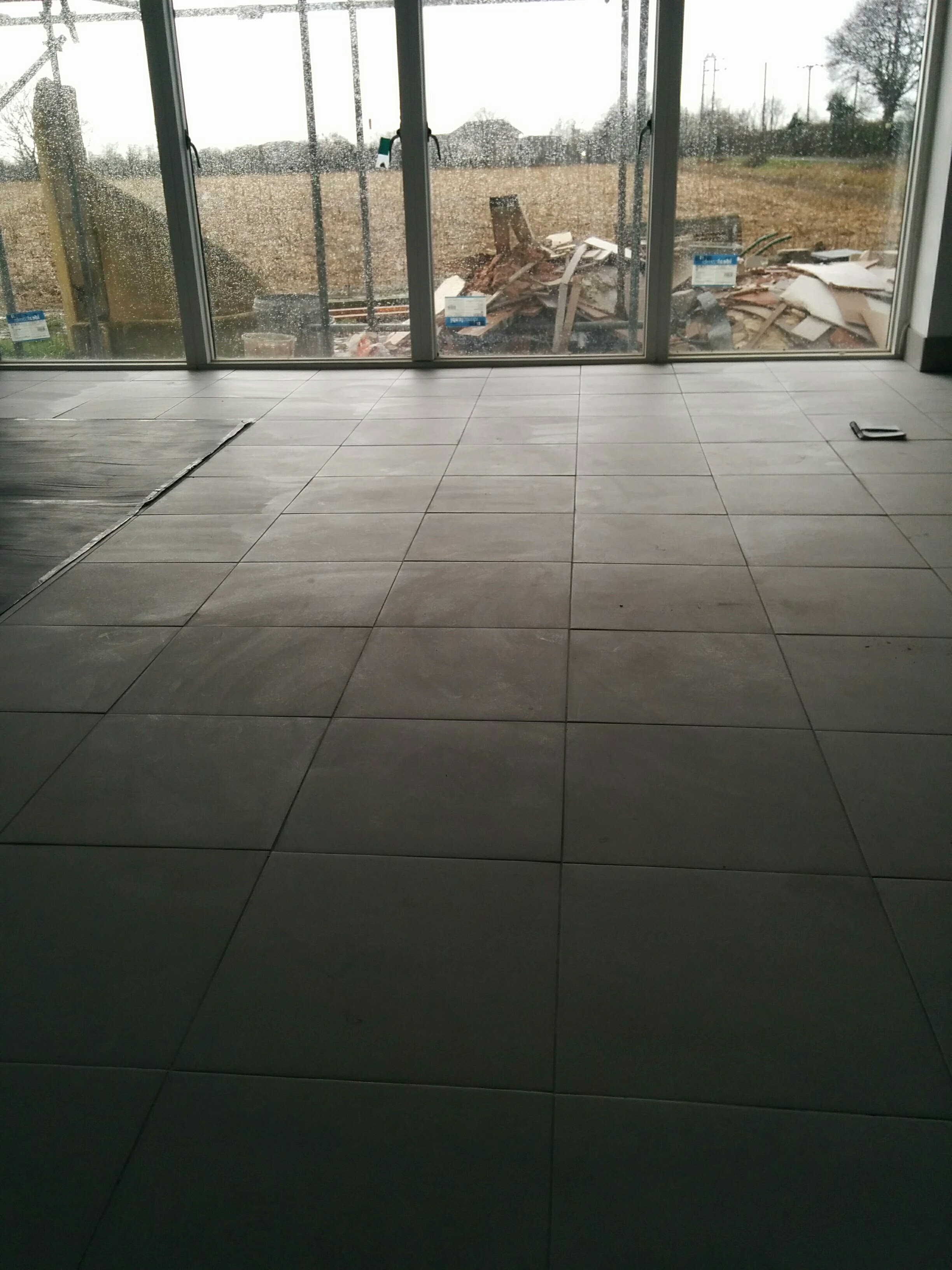

Fallingditch Posted March 5, 2017 Author Share Posted March 5, 2017 (edited) Many thanks @MrP. I think I can guess what the nature of the responses are going to be ... Anyway, here goes (warning: many images to follow) "Tiling shall have an appropriate appearance Items to be taken into account include: (a) tile joints Tile joints should be straight in alignment unless the tiles are, by design, irregular in shape. The width of floor tile joints should not be less than 3mm, unless otherwise specified by the manufacturer. Joints in floor tiles should generally not exceed the tile thickness, but wider joints, up to 10mm, may be necessary to accommodate dimensional irregularities in some tiles. Where tiles have dimensional irregularities, the joint dimensions should be “evened out” to maintain a regular appearance." I would say that 80% have joint sizes of 2mm. However there is significant variation. 2mm: 1mm 5mm: 5mm again: (b) overall variation in surface level of wall and floor tiles ± 3mm maximum deviation from a 2m straightedge with equal offsets. Deviation is about 8mm (several examples of significant deviation) (c) variations in surface level between adjacent wall or floor tiles 1mm for joints less than 6mm wide. 2mm for joints more than 6mm wide $mm variation with a 2mm joint 5mm variation: "appropriate appearance" Tiling shall have an appropriate appearance Upstands cut to different widths Upstands not set vertical: Tlies not laid square: <ends> Edited March 5, 2017 by Fallingditch typo correction Link to comment Share on other sites More sharing options...
Jeremy Harris Posted March 5, 2017 Share Posted March 5, 2017 (edited) That's bloody awful! I'm a rank amateur when it comes to floor tiling, but if I'd laid a floor like that I'd be ashamed of myself. Even given the small dimensional differences between tiles due to the manufacturing tolerance, it isn't usually hard to gently change the joint lines to accommodate them before they build up to the level of misalignment you've got. If it were our floor then it would be all coming up and be done again properly. Edited March 5, 2017 by JSHarris 1 Link to comment Share on other sites More sharing options...
Guest Alphonsox Posted March 5, 2017 Share Posted March 5, 2017 That's not pretty, I'm not sure how a professional could do such a poor job. I guess you now need to decide what you want to happen next. Link to comment Share on other sites More sharing options...
Steptoe Posted March 5, 2017 Share Posted March 5, 2017 That's just woeful How anyone could do that and have no shame is beyond me, Even if the floor was piss poor, and the tiles different thicknesses, there is absolutely no excuse for those joints, or gently tapering up to meet the other floor level. That is totally unacceptable workmanship , Link to comment Share on other sites More sharing options...
MrP Posted March 5, 2017 Share Posted March 5, 2017 That does look pretty amateur, difficulty is if you have supplied the tiles then your only recourse would be to withold payment for laying. Not good, some pretty poor tradesmen around at the moment!! Link to comment Share on other sites More sharing options...
Fallingditch Posted March 5, 2017 Author Share Posted March 5, 2017 (edited) 39 minutes ago, Alphonsox said: "I guess you now need to decide what you want to happen next. " All: thanks for the comments. I am employing a Project Manager for this build. He is hiring in subcontractors to do the work. So far, having spent about £300k for a 240 sq m house, we haven't really had a problem, and have now started 2nd fix. Unfortunately, in this particular case, the subcontractor used is a close relation of the PM, which makes matters somewhat awkward for all concerned. Edited March 5, 2017 by Fallingditch typo correction Link to comment Share on other sites More sharing options...
Russell griffiths Posted March 5, 2017 Share Posted March 5, 2017 What is going on in the picture with the patio door in that looks like a dip of around 20mm is your slab that far out of level or is it the camera angle. The rest of it looks horrific. With regards putting a straight edge on it and measuring under it this is only any good if the slab is level in the first place, adhesive is not designed to compensate for an unlevel floor slab. Link to comment Share on other sites More sharing options...
Steptoe Posted March 5, 2017 Share Posted March 5, 2017 14 minutes ago, Russell griffiths said: What is going on in the picture with the patio door in that looks like a dip of around 20mm is your slab that far out of level or is it the camera angle. The rest of it looks horrific. With regards putting a straight edge on it and measuring under it this is only any good if the slab is level in the first place, adhesive is not designed to compensate for an unlevel floor slab. I'd tend to agree with that, I don't think you can put too much blame on the tiler for unlevel, but its totally unacceptable for adjacent tiles to not be flush with one another. And the random gaps,,,,, beggars belief tbh, Link to comment Share on other sites More sharing options...
Vijay Posted March 5, 2017 Share Posted March 5, 2017 I actually feel sorry for you to have been put in this situation. The fact that the tiler is a close relation to the PM makes it even more shameful on the both of them. Stick to your guns and have it out with them or you will always hate that floor. There's no excuse for the job they've done there! Link to comment Share on other sites More sharing options...
lizzie Posted March 5, 2017 Share Posted March 5, 2017 Oh dear if that was my floor I would be sitting in the middle of it sobbing. You can't live with that it's awful. I feel very sorry for you. Link to comment Share on other sites More sharing options...
Simplysimon Posted March 5, 2017 Share Posted March 5, 2017 did his guide dog help out or just let him get on with it? i wouldn't be happy if i'd done that, in fact i wouldn't have done as badly as that, and i hate tiling. you cannot accept that, and i agree with the slab looking hollow at the door. a good tiler should have been able to fix it though, just proves he was incompetent. Link to comment Share on other sites More sharing options...
Onoff Posted March 5, 2017 Share Posted March 5, 2017 That shot with the patio doors.....first thought was is the floor laid to falls..... Is the long length of timber though a good enough straight edge when it comes to an argument? Even MY WIFE wouldn't be happy with that. Link to comment Share on other sites More sharing options...
