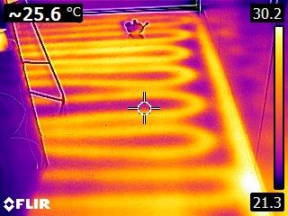

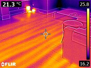

The floor boards are always cold and a thermometer in the never shows the temperature going up. I checked the in and out pipes on the manifold and all appear warm. I decided to rent a thermal image camera to see if I could spot any problems. All the pipes are appear to be working but the temperature readings are very small 21C compared to the new extension where we get 25C.. See attached photos

I think your piccie shows exactly what is going on .
new section the pipes are showing very bright and concentrated --other piccie shows the heat dispersed all all round the pipes, so the actual pipes not showing as hot --so its likely you have avoid around pipes so heat is going out the bottom and anywhere it wants to and not being directed upwards only to the floor .
can you get under the old floor to add insulation to stop heat going down  and block any holes at end of floor joists where it can leak out?

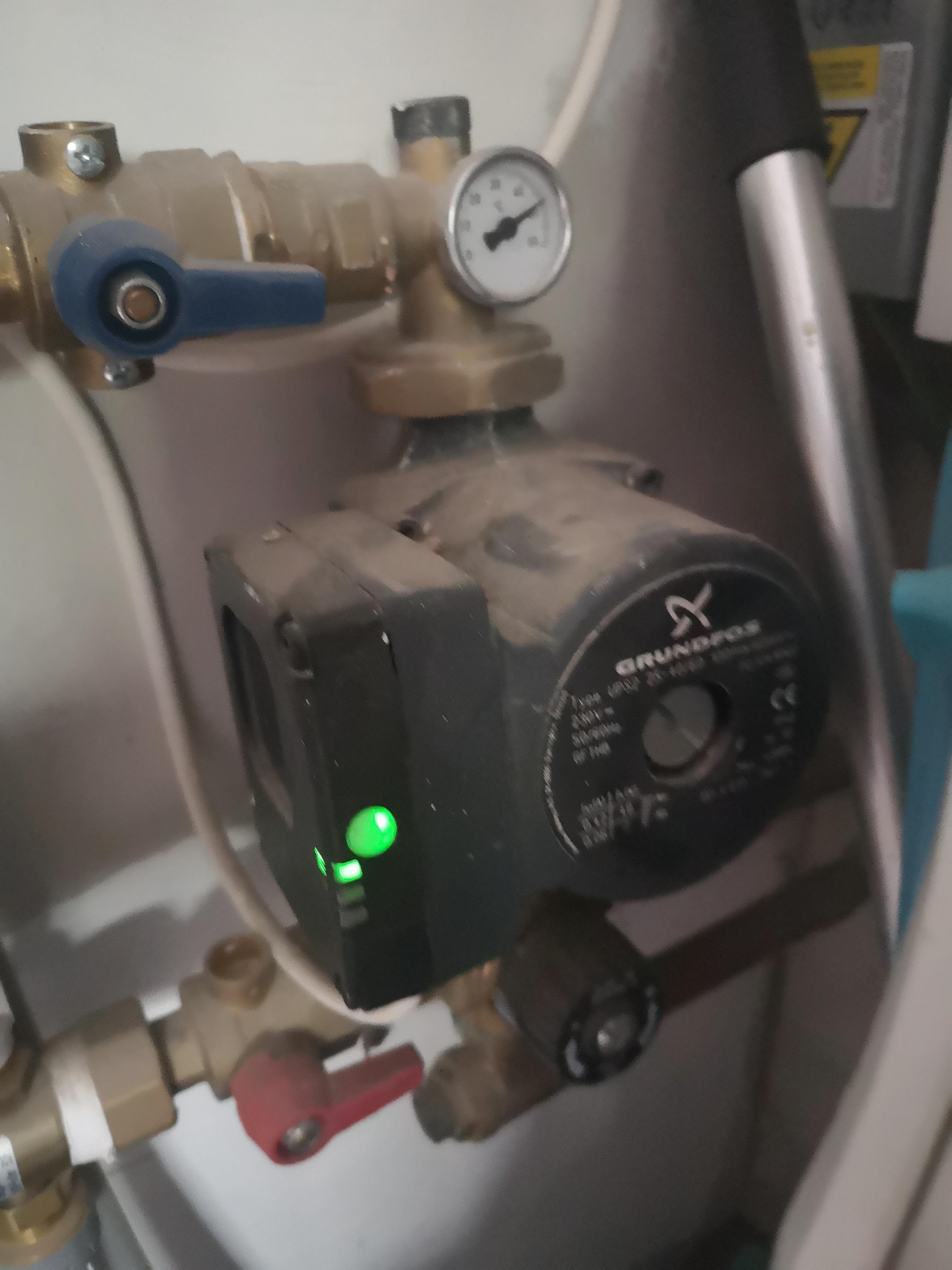

I'm not technical but I believe so, its attached to the manifold, see photo
Is that temperature gauge reading 50?

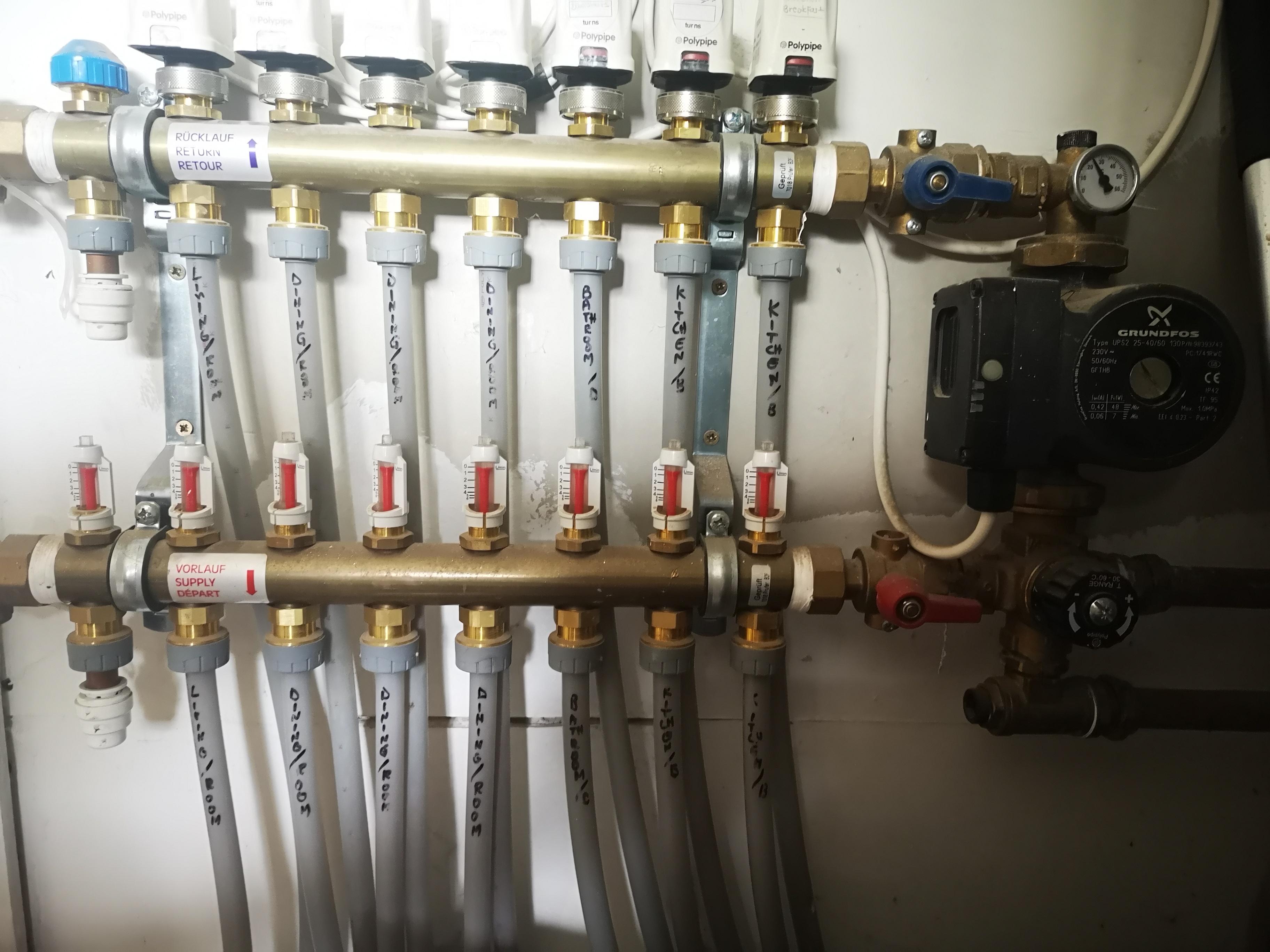

Can you take a pic of the whole manifold.
I hope that helps, I was told by someone that the pump is the wrong way round which makes sense as the out pipes are warmer than then in pipes. Will be looking to change this
Pump looks upside down - UPS2 has an arrow cast in the body of the pump (not the motor) and I bet that is pointing upward. In this case it should be downward.
10 minute job to switch it over if you can isolate the two pipes into the bottom right of the mixer.
TBH I am surprised it has worked so far as it is pushing against the flow valves and is pulling the wrong way through the mixer.
Out of interest which of the two bottom pipes gets hot first ..? Which is the boiler supply ..??
Mixer looks to be in wrong way round or manifolds mixed up.
Check supply and return from boiler are correct first, If so easiest fix is to swap upper and lower manifolds over, check pump casting for flow direction arrow as mentioned by Peter.

@JFDIY thanks for finding that ..! I agree - manifolds wrong way up ..!
@David78 you need to get the plumber to switch the manifolds over - Polypipe System isn’t too complicated and it’s a case of swapping the flow and return manifolds and their controls or putting the pump etc on the other end which tbh is probably a bigger job assuming the boiler flow is into the bottom pipe of the mixer.

The bottom pipe is the one which gets hot first. Is that correctly setup?
Yes - bottom right should be boiler feed. One up is boiler return.
I am wondering how they got this so wrong ..!!!
@David78 is there anything on the left end of the manifold..? Or is it just caps..?
