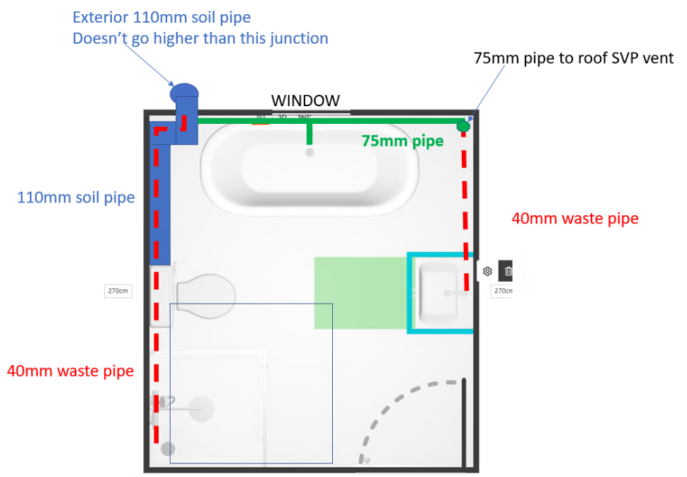

MortarThePoint Posted May 19, 2021 Posted May 19, 2021 Which route would you take? OK not you yourself, but which route would you let the foul smells take. The Architects plan was to send the soil pipe down through the floor in the right hand corner of the bathroom (as viewed below) but we not have open space below now so don't want to put it there. As it's now going externally, we moved it close to the side of the chimney to reduce its visual impact, and that position is shown below. This is the furthest extent of the foul water system and so needs an SVP (not just AAV). We don't want to continue the stack outside and offset round the eave. We don't want the vent tile too close to the chimney so it likely needs to be towards the top right corner of the image below. I see two main options: Route the main stack to SVP tile vent connection as shown below. 75mm horizontal run at floor level junctioning to a 75mm vertical run up to the vent. Route a vertical run of pipe (e.g. 75mm) up the top left corner of the image below and the turn horizontally in the roof space track along and the back to vertical above the right hand corner and to the vent tile.

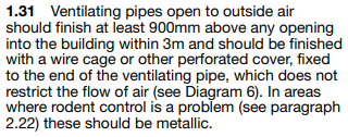

MortarThePoint Posted May 19, 2021 Author Posted May 19, 2021 For reference, I thought I'd add some extracts from Part H:

joe90 Posted May 19, 2021 Posted May 19, 2021 (edited) Why a 75mm vent pipe? It’s only there to prevent (gurgling) and draining other traps, I would do that run in 50mm and take it up into a 50mm AAV in the loft. (It’s what I have done and it works just fine) Edited May 19, 2021 by joe90

MortarThePoint Posted May 19, 2021 Author Posted May 19, 2021 (edited) 3 hours ago, joe90 said: Why a 75mm vent pipe? It’s only there to prevent (gurgling) and draining other traps, I would do that run in 50mm and take it up into a 50mm AAV in the loft. (It’s what I have done and it works just fine) I'm sure a 15mm pipe would work by 75mm is the reg. (copied in my previous post). Edited May 19, 2021 by MortarThePoint 1
MortarThePoint Posted May 19, 2021 Author Posted May 19, 2021 3 hours ago, Big Jimbo said: As Bitpipe said, worth a conversation with building control. I did ask before if I could jus have an AAV and he said at least one SVP needed although it's a single house and package sewage treatment plant situation

saveasteading Posted May 19, 2021 Posted May 19, 2021 Excuse me some repetition. The end vent pipe does 2 things. Allows gas to escape from the sewage system if there is a blowback from fermenting stuff. You can't rely on anybody else's system working, and you might get everybody's. It will smell and may force water out of your traps. Best that it shoots up in the air and away. 2. lets air in so that there is never a vacuum to prevent flow down your drains. Otherwise it will slow flow (causes blockage) and possibly empty your traps. A Durgo valve does the latter, with a valve to prevent the former, and can be in the house. But you need one of the former at the end of the line. that is why one end pipe might suffice for a group of houses on the same system., depending on layout. I expect every house has one or more Durgo valves. The same applies to a private treatment plant. So I think you do need to vent to air, at the end of the system, in case of blowback. Easiest in standard 4" unless the arrangements of the drains are very restrictive. But you could possibly plead for a vent in the ground close to the treatment plant, plus Durgo indoors.
