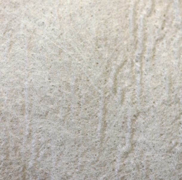

I don't know if the stuff below is any good, but I guess it doesn't decouple. Only £2.87/m2 though.
"Kerakoll Biotex Anti Crack Matting is a reinforced anti-cracking sheet matting, for evening out tensile and sheer movements between the substrate and the surface finish. Also suitable for use as an anti-cracking product for tongue-and-groove hardwood floors on critical substrates. For internal floors. Previously known as Kerakoll Idrobuild Tex Matting"
https://www.tilingsuppliesdirect.co.uk/product/kerakoll-biotex-anti-crack-matting#.YKO0bahKhaQ

LOL!. Now it's too cheap!. I can't see from the photo it has the 'fleece' side. You buy some and tell me how you get on ?

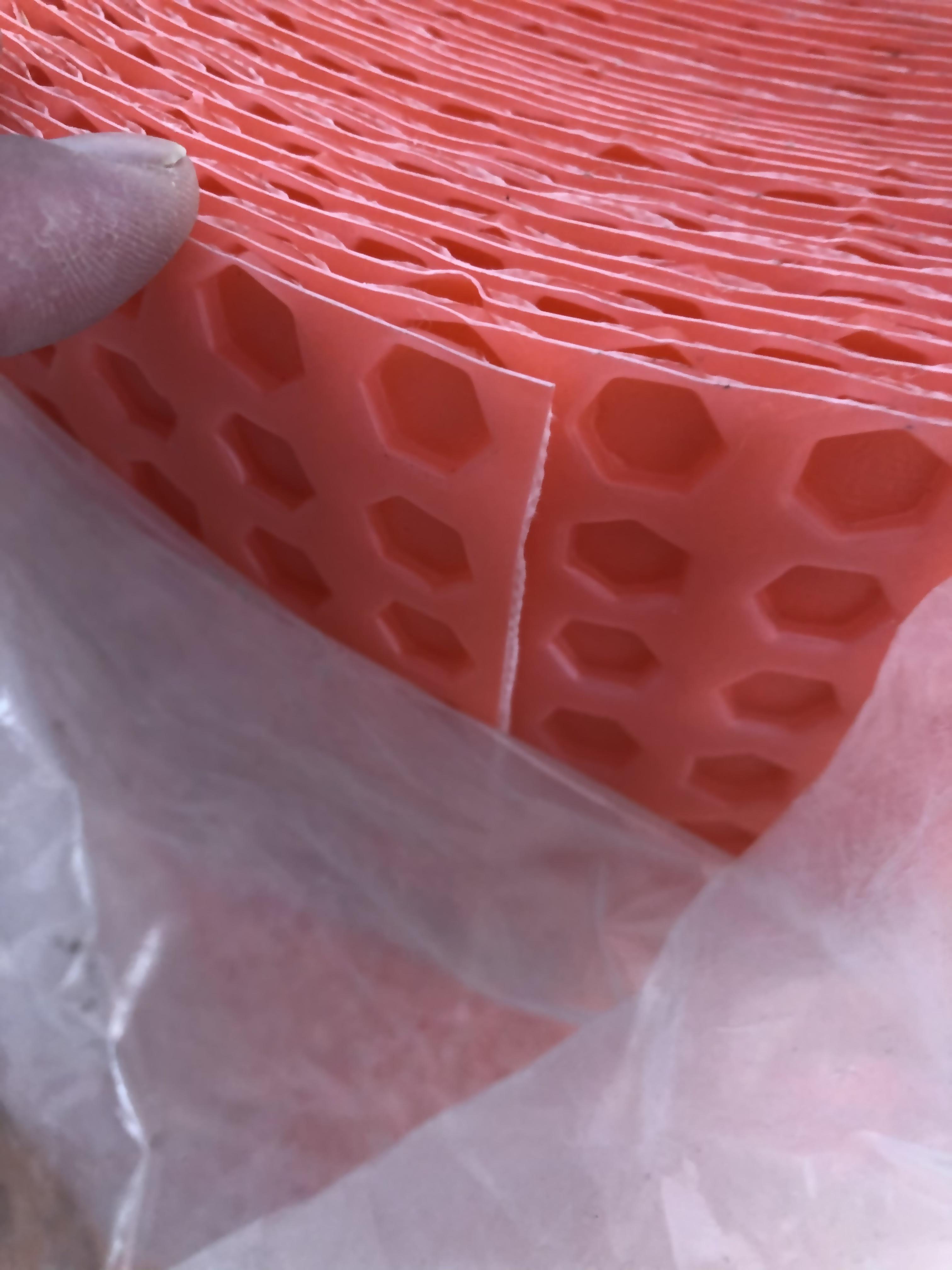

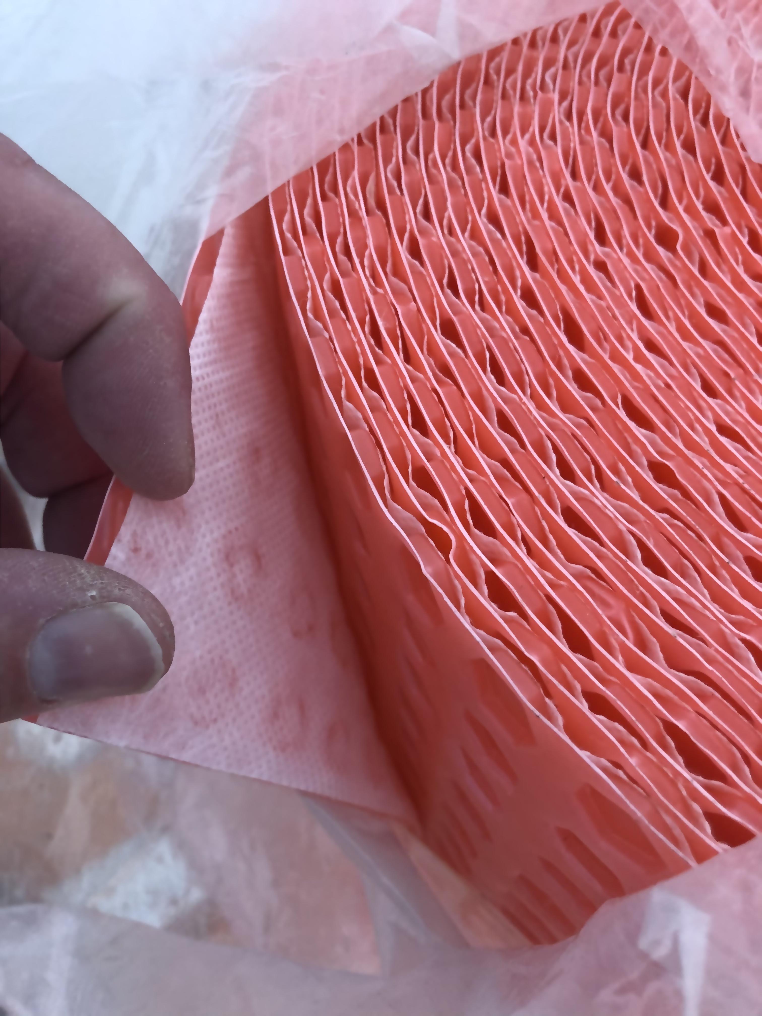

Some options here: https://www.protilertools.co.uk/categories/materials/tile-matting
Durabase is thicker (4mm) than DITRA (3mm) and about 10% cheaper.
There are a couple of uncoupling mats that are less than 1mm thick and quite cheap (<£5/m2), but that's not much room to do a good job of uncoupling.

https://www.ebay.co.uk/itm/353070075797?ul_noapp=true
This one I emailed. Will provide a VAT receipt. Also 5% discount if you spend over £100.
