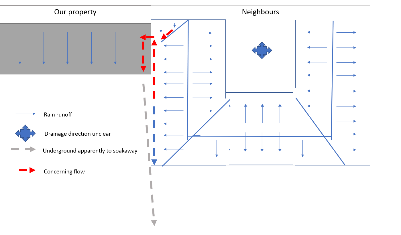

We have recently bought a mid-terrace property and have plans to extend to the rear. We have a problem with the neighbours rainwater drainage, which uses our property and would be blocked by any extension we built.
Our next door neighbours have already created a garden room, built less than 10 years ago with a parapet party wall and multi-pitch roof. We have a small, original, singe storey pitch roof. There is a gulley drainage on their side of the parapet. The rearmost half drains to the rear edge of their property but the closest edge has been intentionally built so that the drainage runs over our pitch roof. I have attached photos and a schematic.
There is a party wall agreement the drainage from this pitch roof apparently runs around the party wall then into a soak away in their garden. The document we have relating to the party wall makes no mention of this drainage. It seems like a strange setup that no owner of our house would agree to, but the house was previously let by a disinterested/cheap landlord. If we build a matching extension, this water would have nowhere to go.
We have a good relationship with the neighbours but before addressing this I want to know where we stand. With no written agreement for this setup, could we demand they fix this?
We would reconfigure all our drainage whilst building an extension and would not need to make use of their soakaway any longer.
Many thanks in advance.

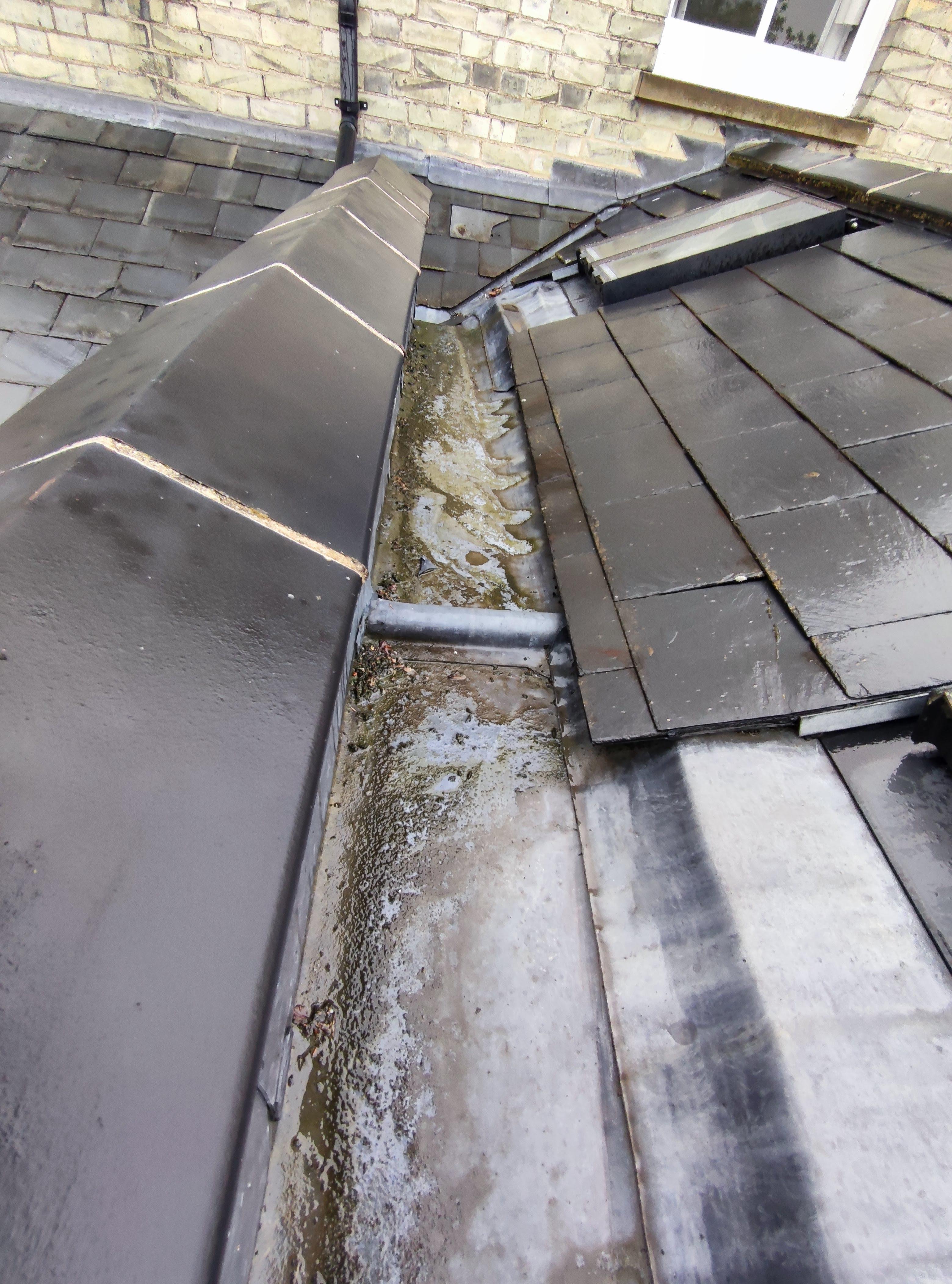

What an odd setup and difficult. Why would they create an upstand half way along their gulley?. I suppose you could insist they alter their roof to take their own rain away. IMO that party wall should have extended back to the house rear wall (but it’s not ?‍♂️). With your extension would you have a similar gulley but discharging to the rear of your new build? If that’s the case you could accept (in the vein of neighbourly love!) to accept the small amount of rain from that rear area!. Depends how strong arm you want to be with your neighbours?
That is all rather beautifully built, by the looks of it.
The amount of water off their rear half is quite low, but very deliberately controlled onto your roof.
The upstand halfway ensures that you normally get only that area of water, but in a downpour, or if a pipe is blocked, it can overflow back to yours.
It is quite clever in protecting the neighbour's property.
The upstand idea is something I have dome a few times to send water the way I wanted, ( to barrel for example) but allow full flow in extremes.
Without getting into the legalities, you might have to agree to revise this arrangement. Assuming that their forward downpipe cannot take all the water, then you will need another solution.
That will depend on what you want to build. could be a pipe picking up that water (best not) or an additional outlet or overflow from their eaves gutter.
The gutter looks substantial for the area of roof. What about the downpipe?

Could you post an image of how the rear elevation looks, how does that gulley interface with the rear wall, guttering etc.
Thanks for all the great input. They have indeed had high quality work done, but I'm surprised it relies on the assumption that any future neighbours would facilitate continued drainage. Surely they cannot lay a claim to this (without legal agreement)?
Let's say I wished to build a flat living roof with a height of 150mm below the parapet (~2.85m): this would then blocked the drainage. If I understand correctly from @Carrerahill's comment- liability for damage then falls on us?  I expect we can strike a friendly deal- but surely we can insist that their roof is changed? I'm surprised they didn't build the wall all the way back as per @joe90- I'm starting to think it was cunning design rather than clumsy! However were I building this I would ensure we control our own drainage and will certainly be doing that at the other party wall.

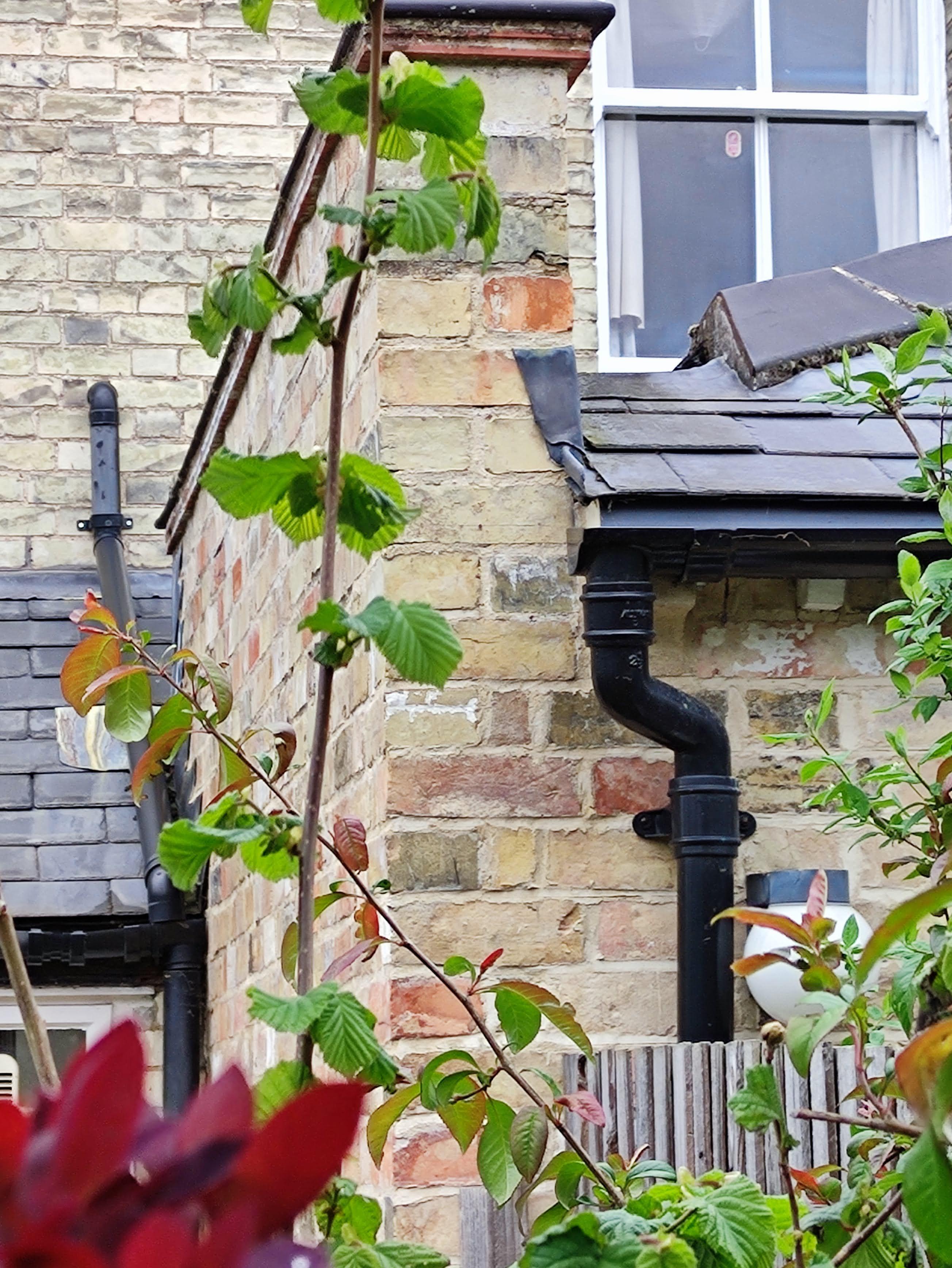

The downpipe from ours which discharges onto our roof is just a condensate pipe from a boiler (which will be retired for a heat pump).

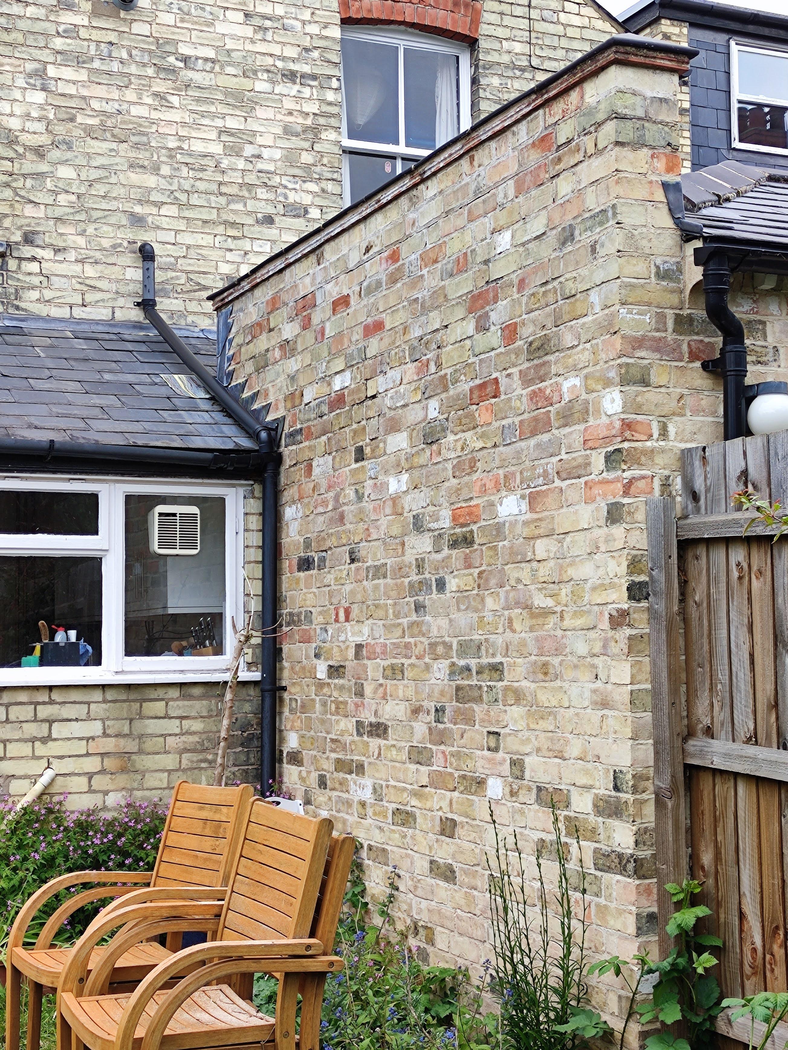

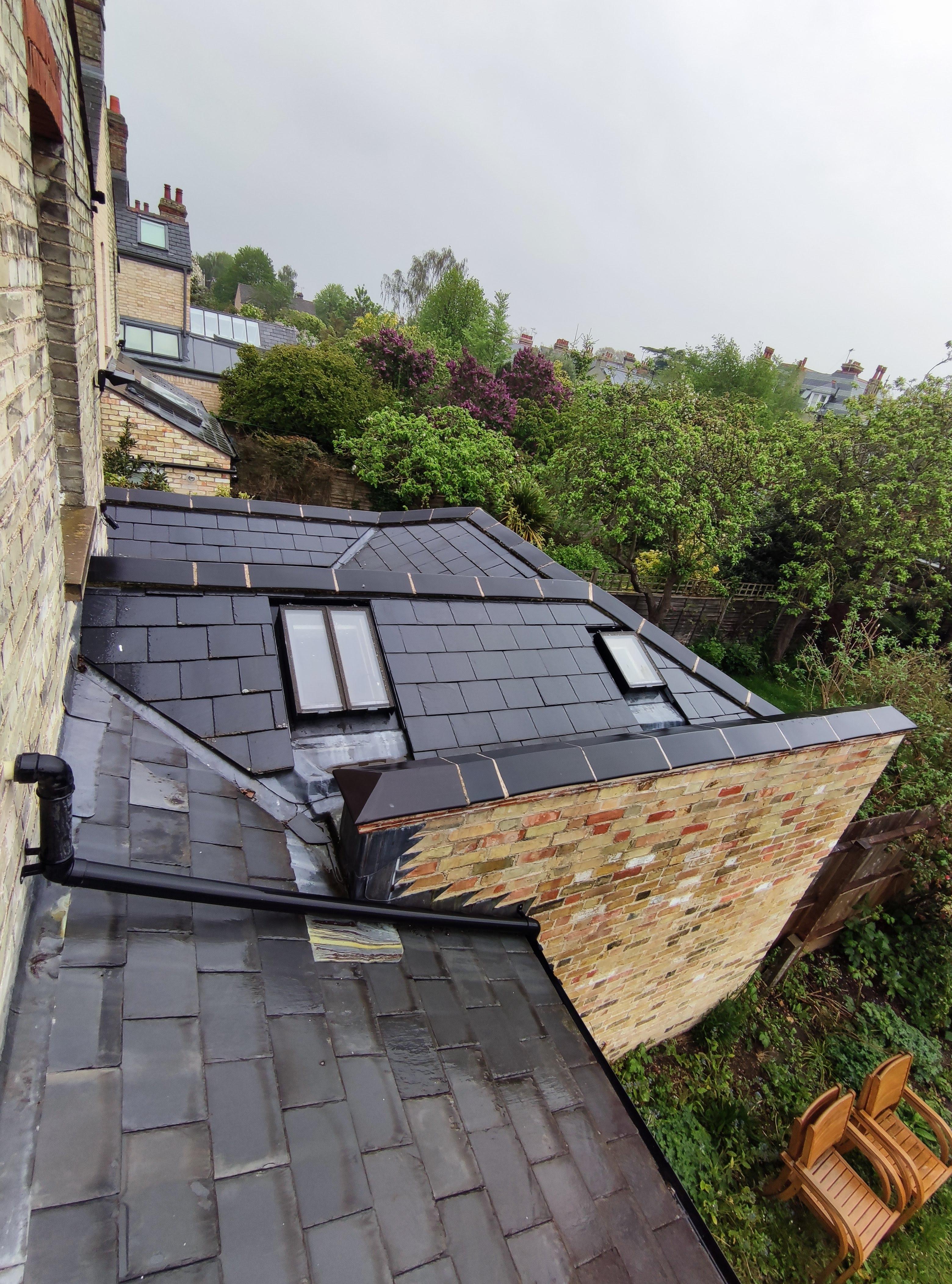

The attached photos show the rear elevation including the discharge of the rear half of the gulley.

It does beg the question - why on earth didn't they build the party wall right back to the house wall?
What's there that caused them to go within a couple of feet?
Is there a fire wall in that space between your lean to and their extension?

@BramcoI'm pretty sure it's an original build, solid brick wall.
@Joe with a beam and block floor level with the existing house and an extensive or wildflower flat roof, we should achieve 2.4-2.5m of ceiling height. Their water crosses the boundary at essentially the level of our proposed ceiling.

Practically, you can easily close the 'overflow' onto your roof when the time comes.
From appearances the main issue is that their downpipe is rather small, especially with the flow splashing in from the gutter under discussion.
ditto yours but from a smaller roof.
Also, with an internal gutter it is good practice to have 2 outlets in case one is blocked, but this gutter is big and the flow small.
I think the easy answer, if amenable, is to close off your 'overflow', see how it goes but possibly add another rwp to theirs or change to  a bigger one. Once the water is going vertically, it is sorted.
The ultimate test is always 'what happens if the gutter or pipe is blocked? In this case, if the plastic gutter overflows, then no harm is done. Or it would need a very big problem to block the lead gutter, but the consequences could be bad.....but they built it.
I suggest design what you want in principle, and then there will surely be a solution.
From a look at your pics, the upstand in the middle could be removed and it looks like the lead work towards the house could be raised to take “their” water down their gulley, it “appears “ the slates might not even need to be removed ?
Zombie thread, but in case it's of interest to anyone- this was the building fix. The neighbourliness part was almost the hardest part.
Our neighbours weren't aware of this issue. After raising it several times as a non-urgent but upcoming issue, we then raised it when we were going through formal party wall notice for other things like chimney removal and our loft conversion.
We have a deed saying we owe them enclosure costs for the wall built on the boundary if we build on it- they suggested they would waive that.
We pointed out that when we built the extension we had planning permission for, or even if we built a direct copy of theirs, there would be a pooling issue from the water directed backwards. So there needed to be a fix. We calculated the enclosure costs based on 1/2 of what it would cost us to build that same wall now (using our builder's quote). They had a quote from their own trusted builder (who built their extension) to infill the gap in the wall and redirect the gutter- seemed somewhat high but it's a small firm doing quality jobs. We offered the use of a skip bag already on our property to save on skip hire and gave them bricks from my collection as pragmatic.
We then insisted on paying the enclosure costs but insisted that the fix was done. Conveniently the enclosure costs were just above half the remaining builders quote. Our neighbour (retired solicitor) drafted a memorandum of understanding, enshrining that we were explicitly paying owed enclosure costs and they were funding the remedial works to their extension, with the accompanying contract, warranty, responsibility etc being completely theirs (although the wall remains a party structure).
